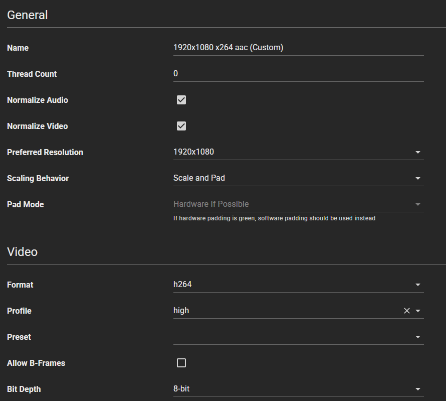

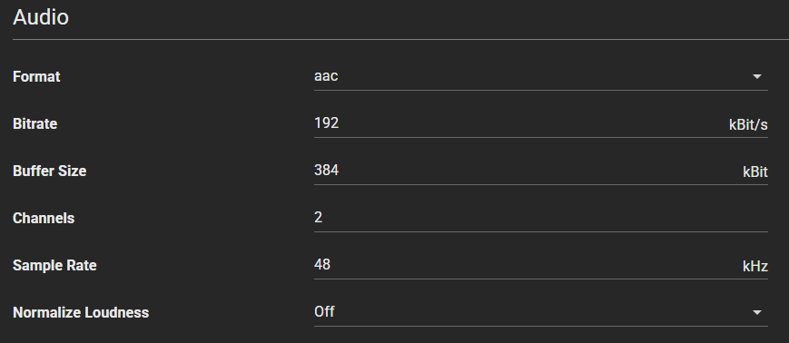

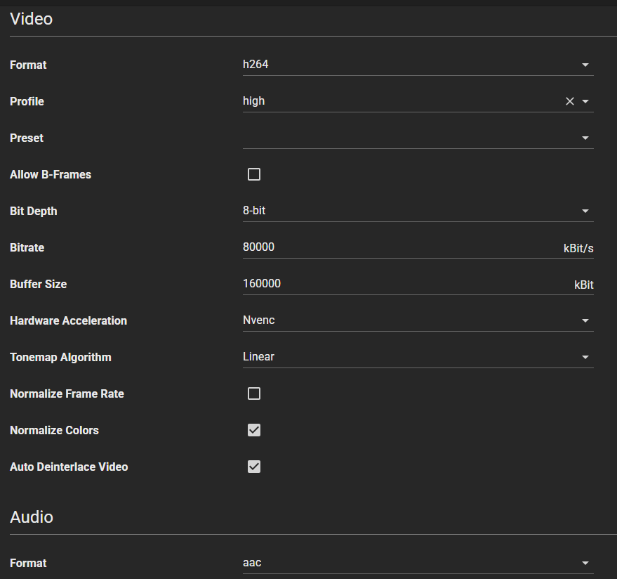

SmplyUnprdctble 9 Posted May 28 Author Posted May 28 In case it's relevant, this is my ErsatzTV encoding options. I feel like it should be playable on any of my TVs. And, my HDHomeRun stream should be playable directly to a TV, since it plays in the HDHomeRun app.
ebr 17032 Posted May 28 Posted May 28 In order to support seeking, the Roku will always prefer a remux of a TS stream and, in this case, something went wrong trying to do that (no way to really tell) so then it fell back to a transcode.
