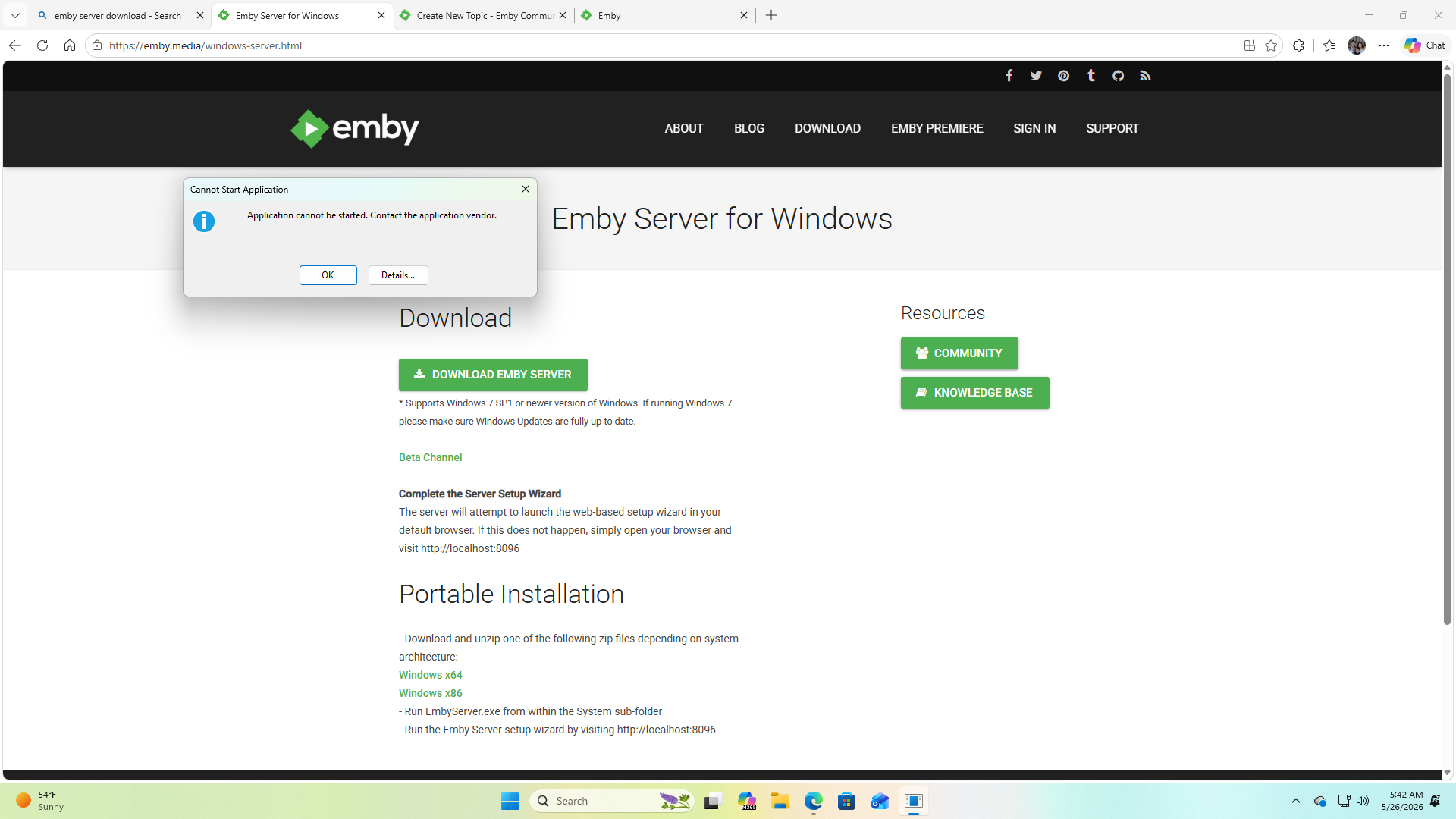

nchan 0 Posted May 26 Posted May 26 I am trying to install emby server for Windows on a new PC but I am getting the following error message. I clicked on the Details but I have no idea what any of contents mean. Can someone walk me through how to fix this? FCVMTZLA.log

Solution stevehoffman203 19 Posted May 26 Solution Posted May 26 Per the log that you attached, you need to run the setup as an administrator. Activation of http://embydata.com/downloads/server/release10/MediaBrowser.Server.Installer.application resulted in exception. Following failure messages were detected: + The requested operation requires elevation. (Exception from HRESULT: 0x800702E4)
NeverExists 27 Posted May 27 Posted May 27 I had that happen when I didn't run the executable as administrator.
