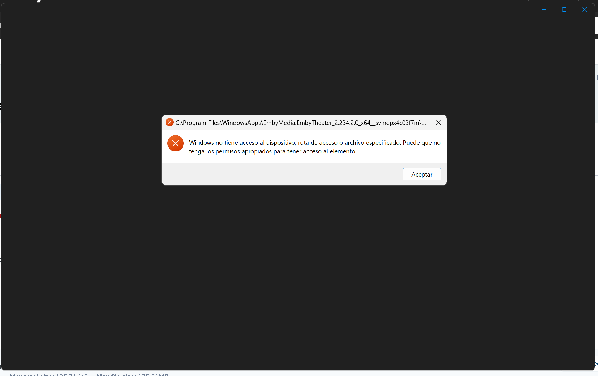

Guderian 2 Posted May 25 Posted May 25 Buenos dias, tengo 3 equipos con Microsoft Windows 11 Pro Versión 10.0.22631 compilación 22631, en los cuales da el mismo error al iniciar la aplicación desde la Store. Adjunto eventos del error y captura del mismo. Saludos emby.evtx

roand7802 2 Posted June 15 Posted June 15 Ese error luce como si un tercero lo estuviera bloqueando. He visto ese mismo error en otros casos en los que un antivirus lo bloqueaba. Debe revisarse los programas instalados.

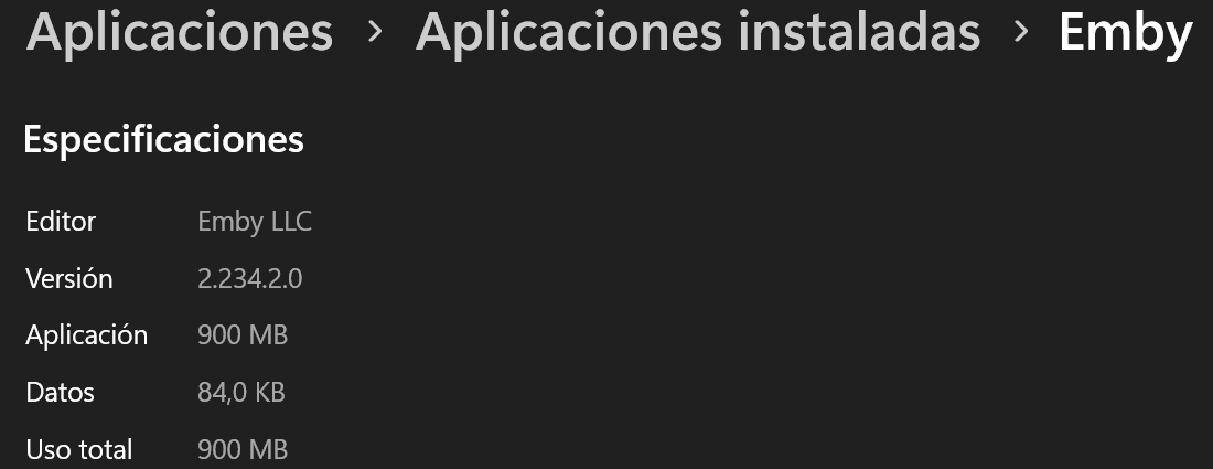

Luke 43719 Posted June 16 Posted June 16 @Guderiandid you get the app update? What version number are you on now?
Guderian 2 Posted June 16 Author Posted June 16 Hola, he probado a desactivar el antivirus (Defender), sin exito. Adjunto mas archivos con el registro de error a ver si ayuda. La versión instalada es 2.310.2.0 Gracias. Report.wer err_event.evtx

sa2000 890 Posted June 19 Posted June 19 On 6/16/2026 at 6:39 PM, Guderian said: I've attached more files with the error log to see if it helps. The installed version is 2.310.2.0 Getting a dump file and the associated Emby Windows app log files for one of these 2.310.2.0 crashes may help find the cause For the stable release from the MS Store, the logs should be here %LocalAppData%\Packages\EmbyMedia.EmbyTheater_svmepx4c03f7m\LocalCache\logs But suggest first you try and enable the windows option for getting dump files for these crashes You can use RegEdit to do that and then one enabled, the Emby app dmp files will be in this folder %LocalAppData%\CrashDumps Use the Windows Registry Editor to configure Windows Error Reporting: - Open Registry Editor: Press "Win + R", type "regedit"regedit, and hit Enter. - Navigate to "HKEY_LOCAL_MACHINE\SOFTWARE\Microsoft\Windows\Windows Error Reporting" - If there is a "LocalDumps" key below this then proceed to Configure Dump Settings, otherwise: - Create the "LocalDumps" Key: - Right-click on the "Windows Error Reporting" folder, select New > Key, and name it: LocalDumps. - Configure Dump Settings: - Right-Click on the LocalDumps key, - New > Key and name it: Emby.Client.WinUI.exe - Then Right-Click on the Emby.Client.WinUI.exe key - New > DWORD (32-bit) Value and name it: DumpCount - Set the value to 3 (only last 3 dumps will be kept) - And again Right-Click on the Emby.Client.WinUI.exe key - Select New > DWORD (32-bit) Value and name it: DumpType - Set the value to 2 The value of 2 for the DumpType will result in full dumps - change it to 1 after dumps are obtained. This will then switch to minidumps. Once you have a dump file and located the related app log files, let me know and I will send you an upload link

Guderian 2 Posted June 19 Author Posted June 19 (edited) On 19/06/2026 at 21:00, sa2000 said: Getting a dump file and the associated Emby Windows app log files for one of these 2.310.2.0 crashes may help find the cause For the stable release from the MS Store, the logs should be here %LocalAppData%\Packages\EmbyMedia.EmbyTheater_svmepx4c03f7m\LocalCache\logs But suggest first you try and enable the windows option for getting dump files for these crashes You can use RegEdit to do that and then one enabled, the Emby app dmp files will be in this folder %LocalAppData%\CrashDumps Use the Windows Registry Editor to configure Windows Error Reporting: - Open Registry Editor: Press "Win + R", type "regedit"regedit, and hit Enter. - Navigate to "HKEY_LOCAL_MACHINE\SOFTWARE\Microsoft\Windows\Windows Error Reporting" - If there is a "LocalDumps" key below this then proceed to Configure Dump Settings, otherwise: - Create the "LocalDumps" Key: - Right-click on the "Windows Error Reporting" folder, select New > Key, and name it: LocalDumps. - Configure Dump Settings: - Right-Click on the LocalDumps key, - New > Key and name it: Emby.Client.WinUI.exe - Then Right-Click on the Emby.Client.WinUI.exe key - New > DWORD (32-bit) Value and name it: DumpCount - Set the value to 3 (only last 3 dumps will be kept) - And again Right-Click on the Emby.Client.WinUI.exe key - Select New > DWORD (32-bit) Value and name it: DumpType - Set the value to 2 The value of 2 for the DumpType will result in full dumps - change it to 1 after dumps are obtained. This will then switch to minidumps. Once you have a dump file and located the related app log files, let me know and I will send you an upload link Hola, aqui lo tienes. Saludos y gracias. logs.7z Edited June 22 by sa2000 removed dmp files - dumps should be made available privately
sa2000 890 Posted June 19 Posted June 19 23 minutes ago, Guderian said: Hola, aqui lo tienes. Saludos y gracias. These are minidumps - the default. I wanted to see if we can get a full dump. See my instructions about the registry changes When you get a full dump - it may be too big to attach so I will send you upload link for the zip and also the related logs
Guderian 2 Posted June 22 Author Posted June 22 (edited) Hola, aqui lo tienes. Saludos EmbyClient.txt Edited June 22 by sa2000 removed dmp file - dumps should be made available privately 1
sa2000 890 Posted June 22 Posted June 22 3 hours ago, Guderian said: Hola, aqui lo tienes. Saludos Thank you very much The Emby Windows app was launched at 08:49 am on 22nd June. The crash dmp was at 08:51 But the Emby Windows app process appears to have continued to run until it was closed at 08:56 Do you remember exactly what you did / what happened / what was showing between 08:49 and 08:56 ? (I have referred the dump and associated log to the Emby development team)
