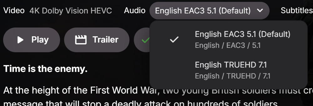

yocker 2094 Posted May 23 Posted May 23 16 minutes ago, robertmontblack said: And how do I do that in the app? Thank you for answering me. It requires the video to have that in the first place but here is a picture:
SamES 1149 Posted May 24 Posted May 24 Yes, unless your server is capable, you're better to avoid TrueHD (and DTS depending on your TV model) as these formats are not supported by LG. Better to stick to a supported format if you have alternate tracks available (AC3, EAC3, etc)

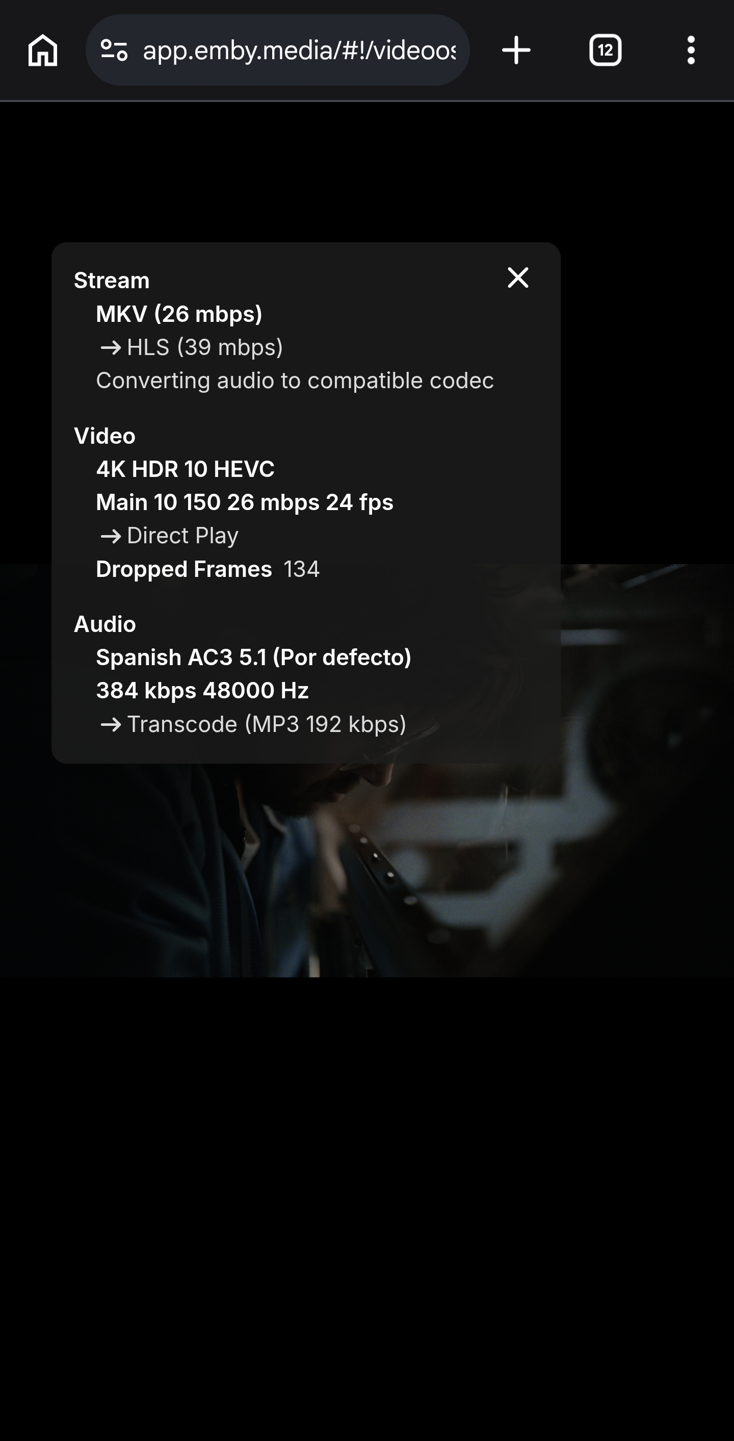

yocker 2094 Posted May 24 Posted May 24 (edited) LG TVs do not support TrueHD, they pretty much only support AC3 and EAC3. i can recommend a Nvidia Shield Pro. It handles pretty much everything thrown at it so you won't have problems with formats that the LG doesn't support. SHIELD TV Pro Streaming Media Player | NVIDIA Edit: Looking at the picture it seems you are playing a track with AC3. That should work without transcoding afaik. @SamESIn case it is relevant to this thread, as said earlier i have a friend with a LG TV with the same problem. When playing a video with TrueHD (havn't tested any other formats) it gets transcoded by the server to a format that the LG struggles with and causes the player to stop after almost precisely 5 seconds. Edited May 24 by yocker
robertmontblack 1 Posted May 24 Author Posted May 24 A curious thing is that it is also happening to me with the second-generation Firestick 4k max. If we analyze this image there is a loss of the signal from the server to my TV because it is wanting to decode an audio codec apparently.
