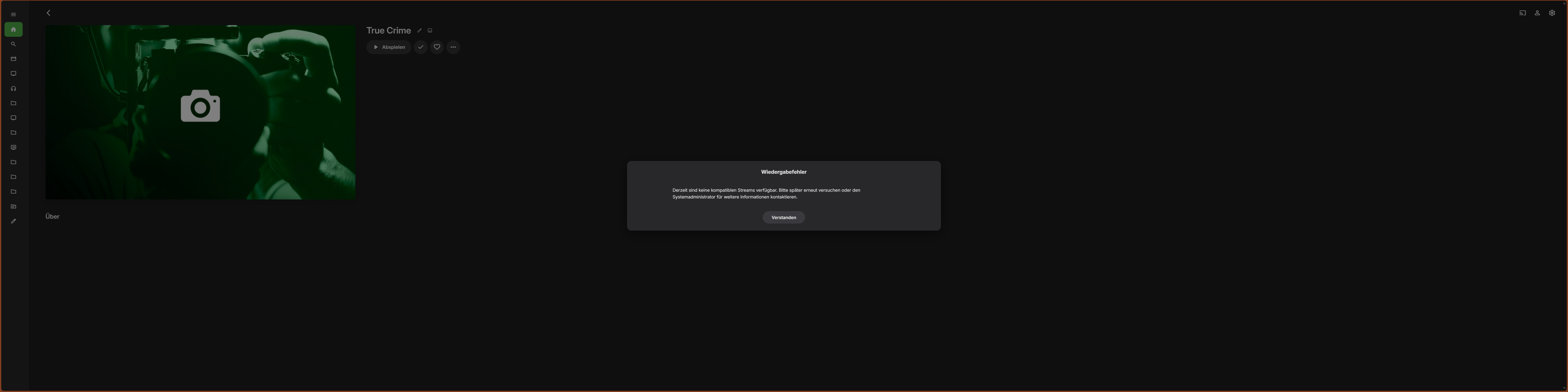

Tabsi 0 Posted May 23 Posted May 23 Hi everyone, first of all, thanks so much for the great Emby. It’s very well designed and organized. As a Premium member, I’m only missing a few options here and there, but hopefully that will come in the future. The ARD Mediathek plugin can be installed / server restarted, but no matter what you click on or try to view, an error unfortunately pops up. No matter what you click, it’s always the same: There are currently no compatible streams available. Please try again later or contact your system administrator for more information.

Tabsi 0 Posted May 24 Author Posted May 24 Hi, I am using the ARD Mediathek plugin version 4.7.0.51 in Emby Server. When I try to play an ARD Mediathek item, Emby shows this playback error: “Wiedergabefehler – Derzeit sind keine kompatiblen Streams verfügbar.” The server log shows that the ARD plugin throws a NullReferenceException while trying to retrieve media info: System.NullReferenceException: Object reference not set to an instance of an object. Source: Emby.Plugin.Ard at Emby.Plugin.Ard.Operation.ContentChannel.GetChannelItemMediaInfo(...) After that, Emby returns: Returning error code NoCompatibleStream It looks like the ARD plugin is unable to create a valid media source for the selected item. I have attached the full Emby server log from the time of the issue. German: Hallo, ich verwende das ARD-Mediathek-Plugin in Version 4.7.0.51 in Emby Server. Wenn ich versuche, einen Eintrag aus der ARD Mediathek abzuspielen, zeigt Emby folgenden Wiedergabefehler an: „Wiedergabefehler – Derzeit sind keine kompatiblen Streams verfügbar.“ Im Server-Log sieht man, dass das ARD-Plugin beim Abrufen der Medieninformationen einen internen Fehler auslöst: System.NullReferenceException: Object reference not set to an instance of an object. Source: Emby.Plugin.Ard at Emby.Plugin.Ard.Operation.ContentChannel.GetChannelItemMediaInfo(...) Danach gibt Emby folgenden Fehler zurück: Returning error code NoCompatibleStream Es sieht so aus, als könnte das ARD-Mediathek-Plugin keine gültige MediaSource bzw. keinen gültigen abspielbaren Stream für den ausgewählten ARD-Eintrag erzeugen. Ich habe den vollständigen Emby-Server-Log aus dem Zeitraum des Fehlers angehängt. Danke!
