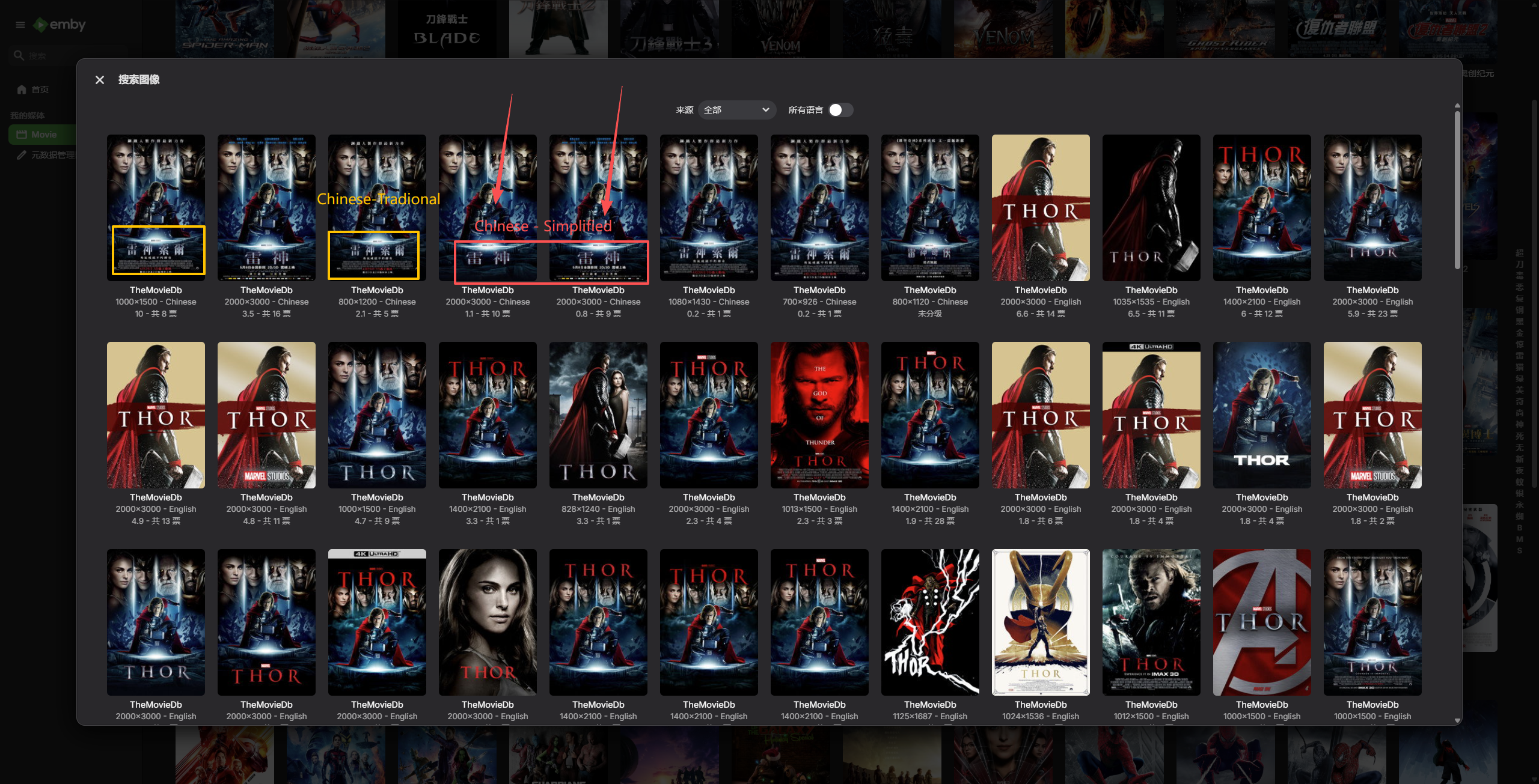

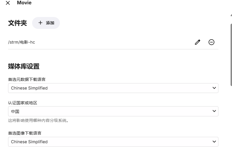

woshiekao 0 Posted May 21 Posted May 21 I clearly selected “Metadata Download: Simplified Chinese, Region: China,” but it recognized poster information for Taiwan instead. That's just ridiculous.

Luke 43549 Posted May 22 Posted May 22 Hi, yes this is what the MovieDb api is returning. Please note, the region field is only used to determine the parental ratings system.

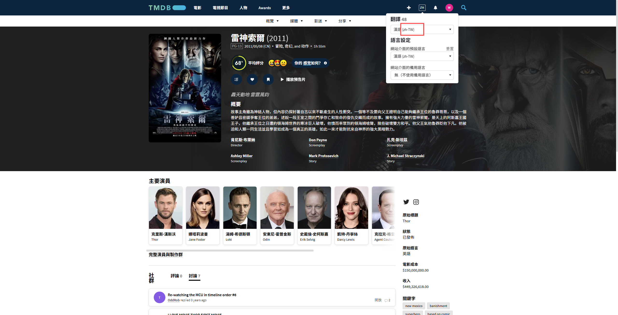

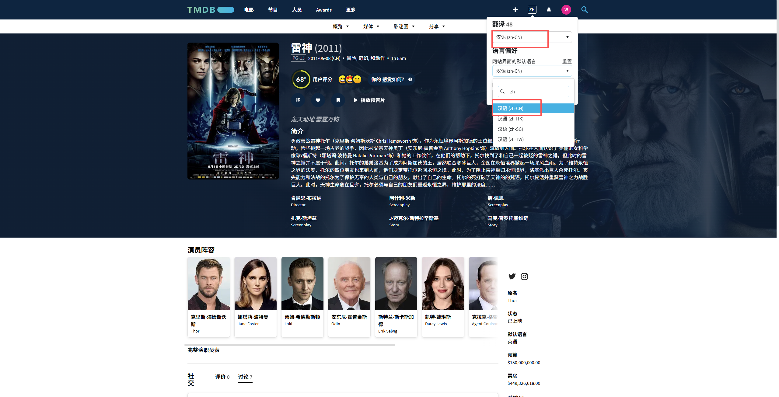

woshiekao 0 Posted May 22 Author Posted May 22 (edited) 10 minutes ago, Luke said: 您好,是的,这就是 MovieDb API 返回的结果。 请注意,区域字段仅用于确定的家长评级系统。 However, the result is correct at www.themoviedb.org. Is this because Emby didn't request the correct API parameter? The correct parameter should be “zh-CN,” not “zh-TW.” “zh-CN” corresponds to Simplified Chinese, while “zh-TW” corresponds to Traditional Chinese. Edited May 22 by woshiekao update
Luke 43549 Posted June 2 Posted June 2 @woshiekaoI think we are sending the right thing. Here is an example url we are using to obtain the list of available images, taken from your log: 2026-05-20 19:36:44.988 Info HttpClient: GET https://api.themoviedb.org/3/tv/90155?api_key=x_secret3_x&append_to_response=alternative_titles,reviews,credits,images,keywords,external_ids,videos,content_ratings,episode_groups&language=zh-CN&include_image_language=zh-CN,null
Luke 43549 Posted June 2 Posted June 2 Here is the problem. When the moviedb api returns the list of images, it just sends "zh" for the image language rather than zh-cn or zh-tw. As a result, the server can't differentiate between what is chinese traditional or simplified. This should be corrected at the moviedb. Maybe @Happy2Playcan help.
