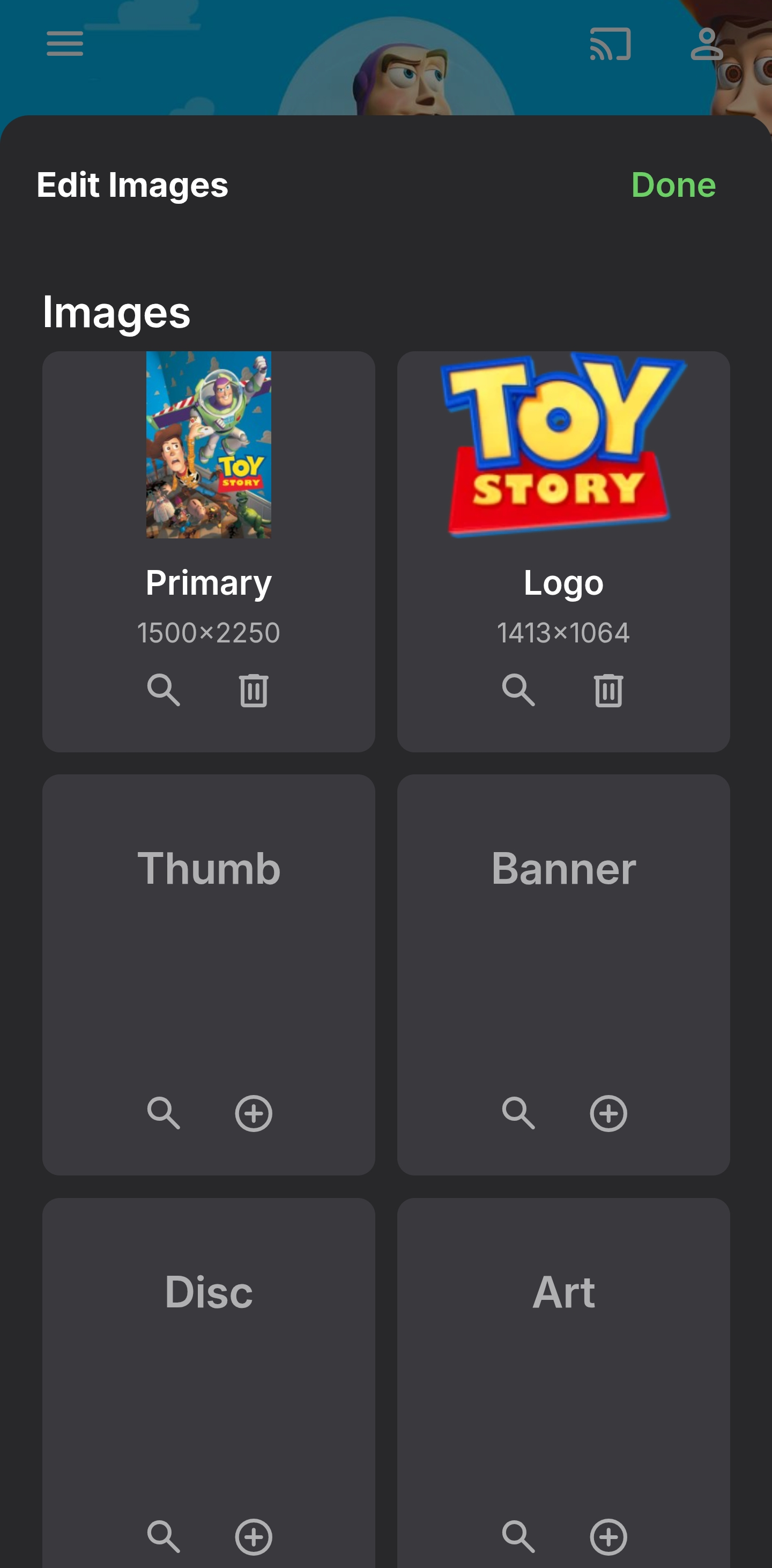

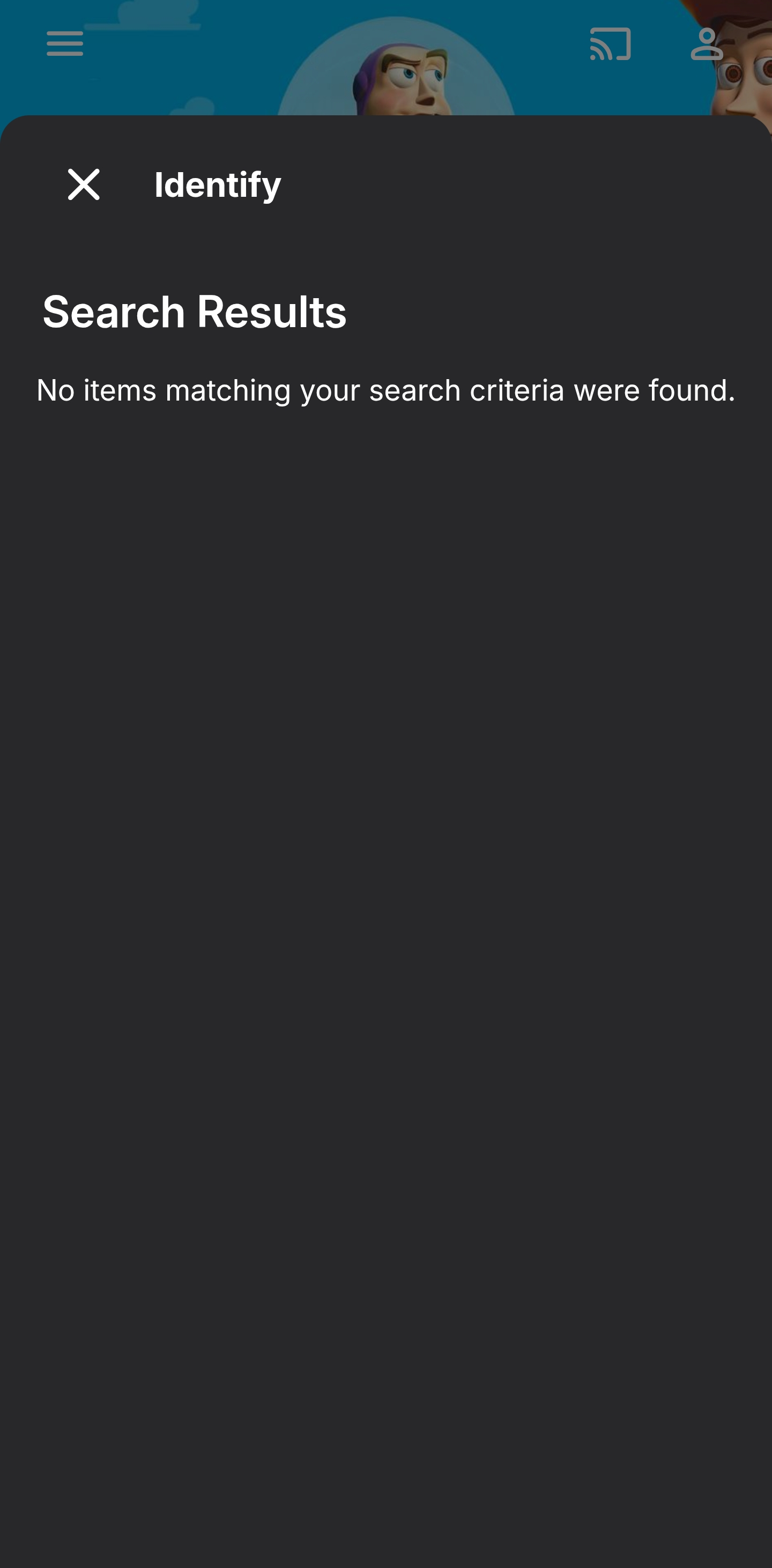

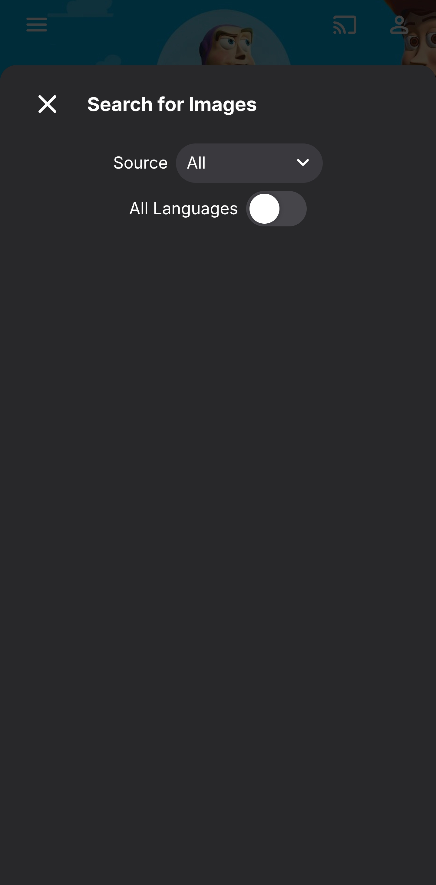

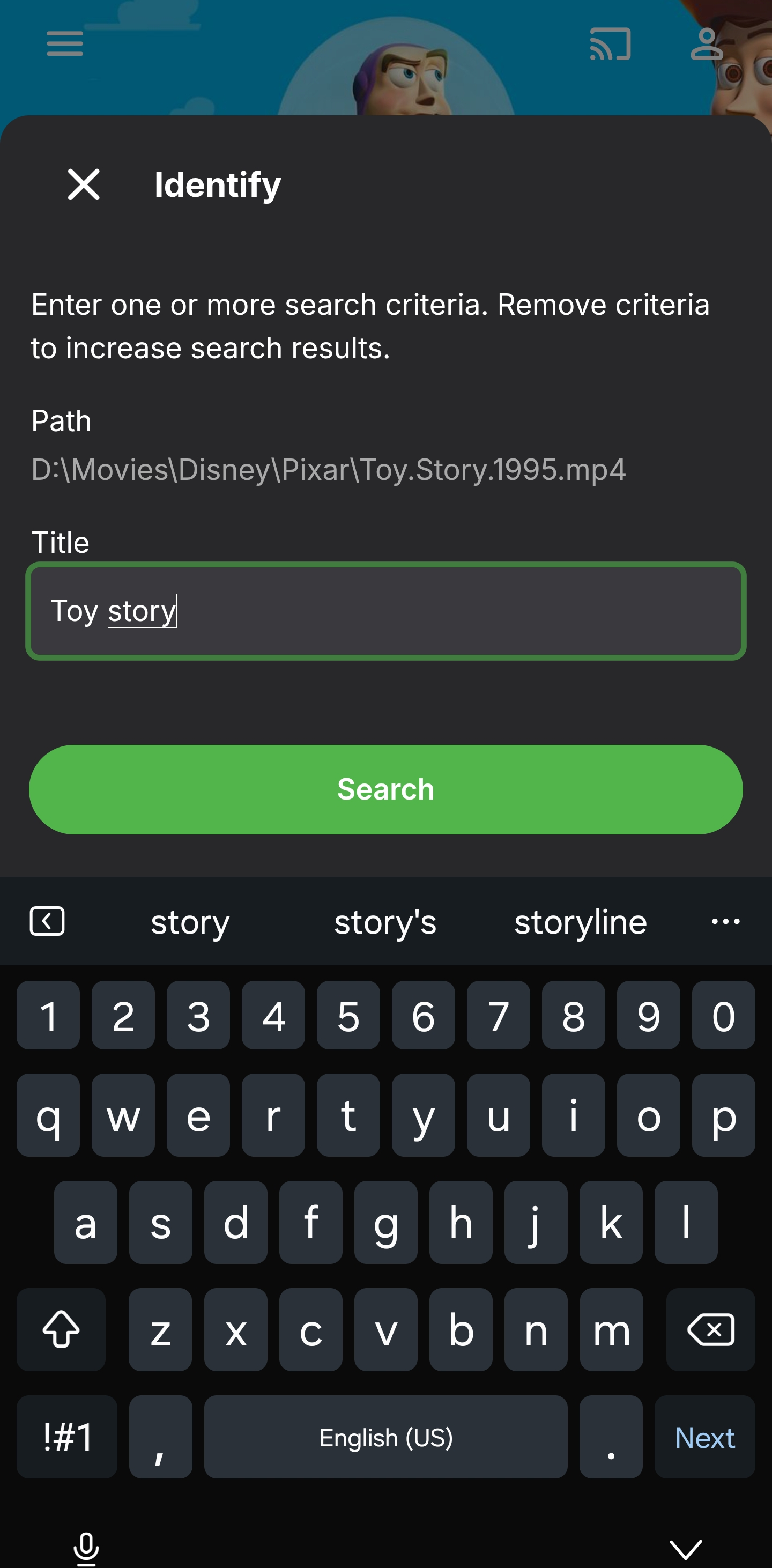

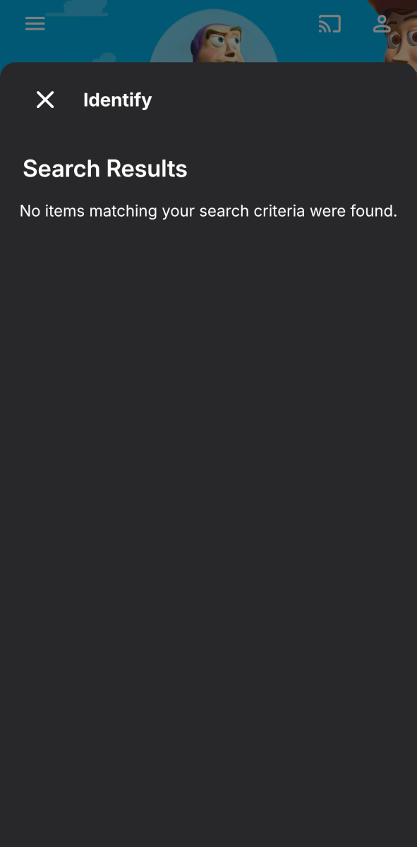

Hi Luke,
Right now I am trying to identify any tv show or movie that I have on my server and even ones that have already been identified when putting ether the name or data base id show that there is nothing for it.
I am also not able to load any images either if I go into edit.
I have included screenshots to hopefully help.
My server is an ipv6 stand alone so no ipv4 access which I am guessing it leading to this issue.
