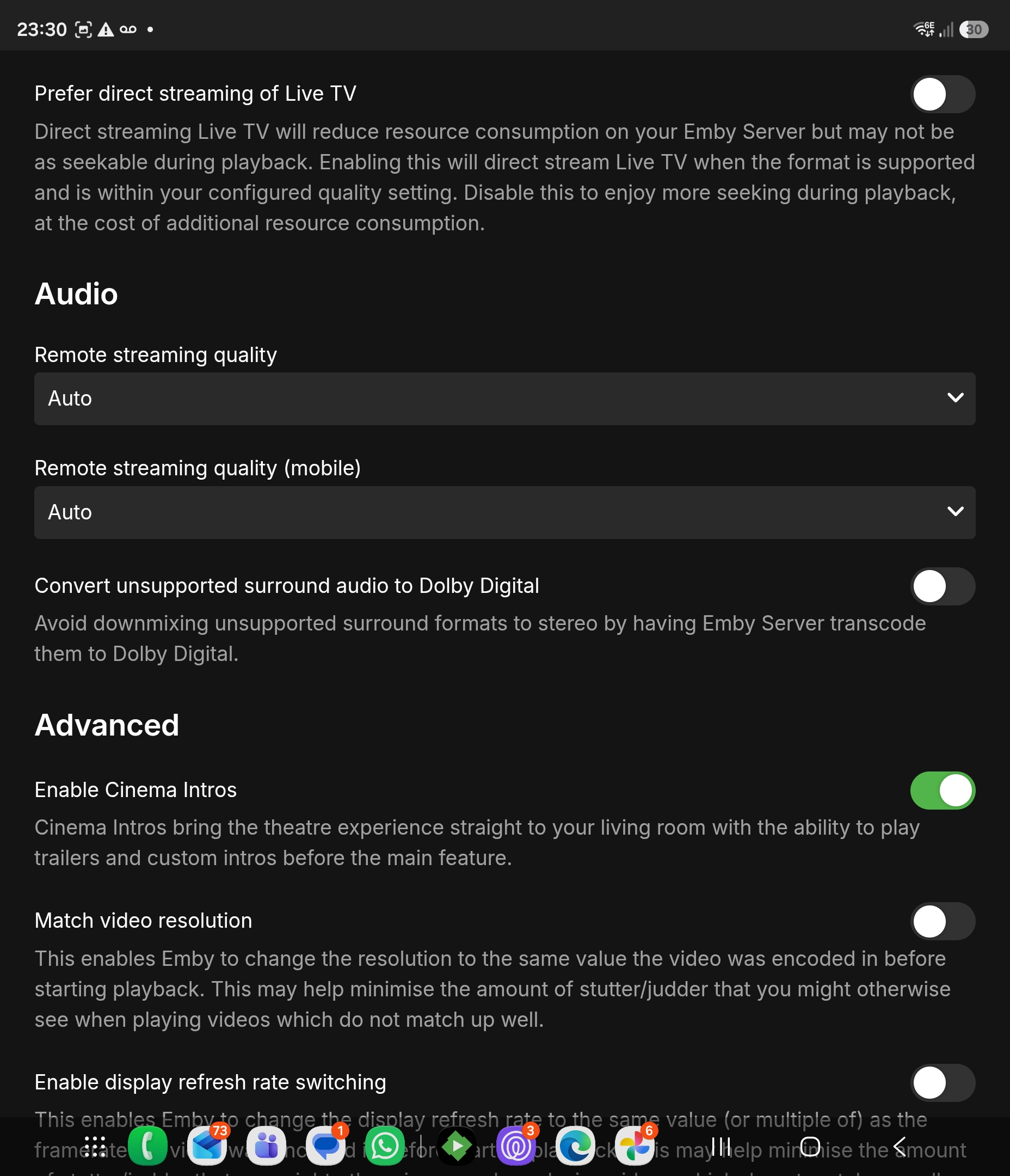

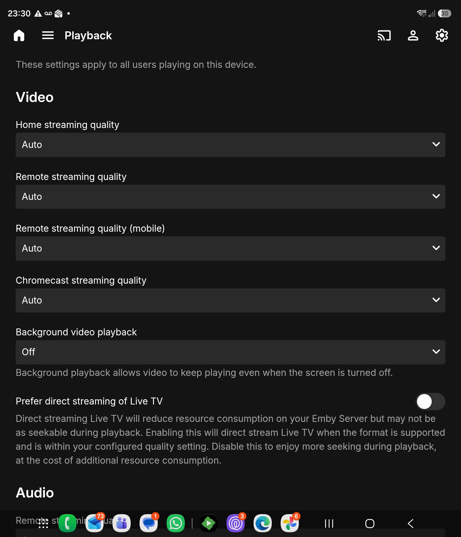

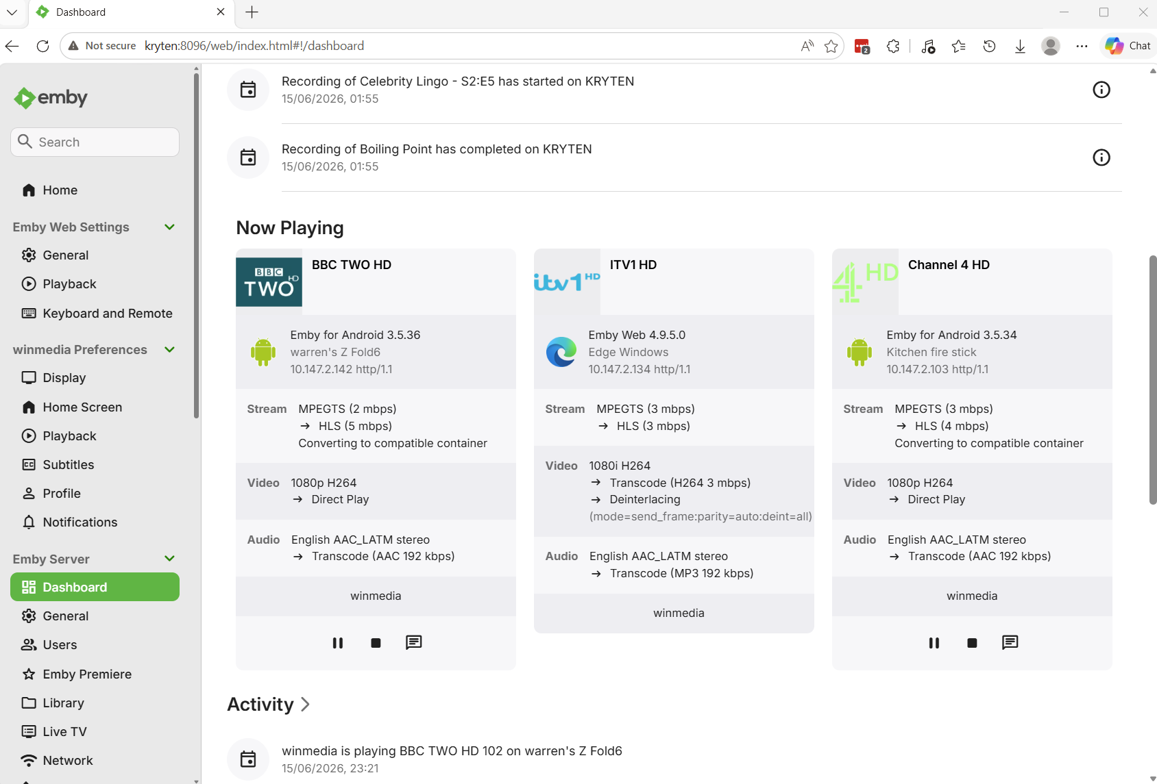

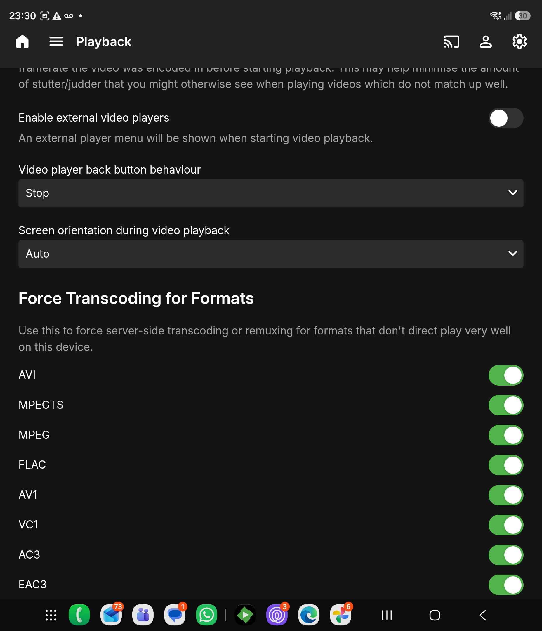

I'm not sure if this is related but I have spotted an issue that explains some of the issues I've been having.
On all the Emby for Android devices I have disabled Direct Play and forced transcoding since I want to FF/REW live TV.  I wondered why FF/REW still didnt work and found that android devices are still using Direct Play.  Please see screenshots attached and the Emby server log.
Emby Server is 4.9.5.0.  Emby Android is 3.5.34 on one, 3.5.36 on another.  Only Emby Web on Windows 11 is transcoding and has working FF/REW.
Please let me know what you think and if this could be related to it failing to start playback intermittently.
