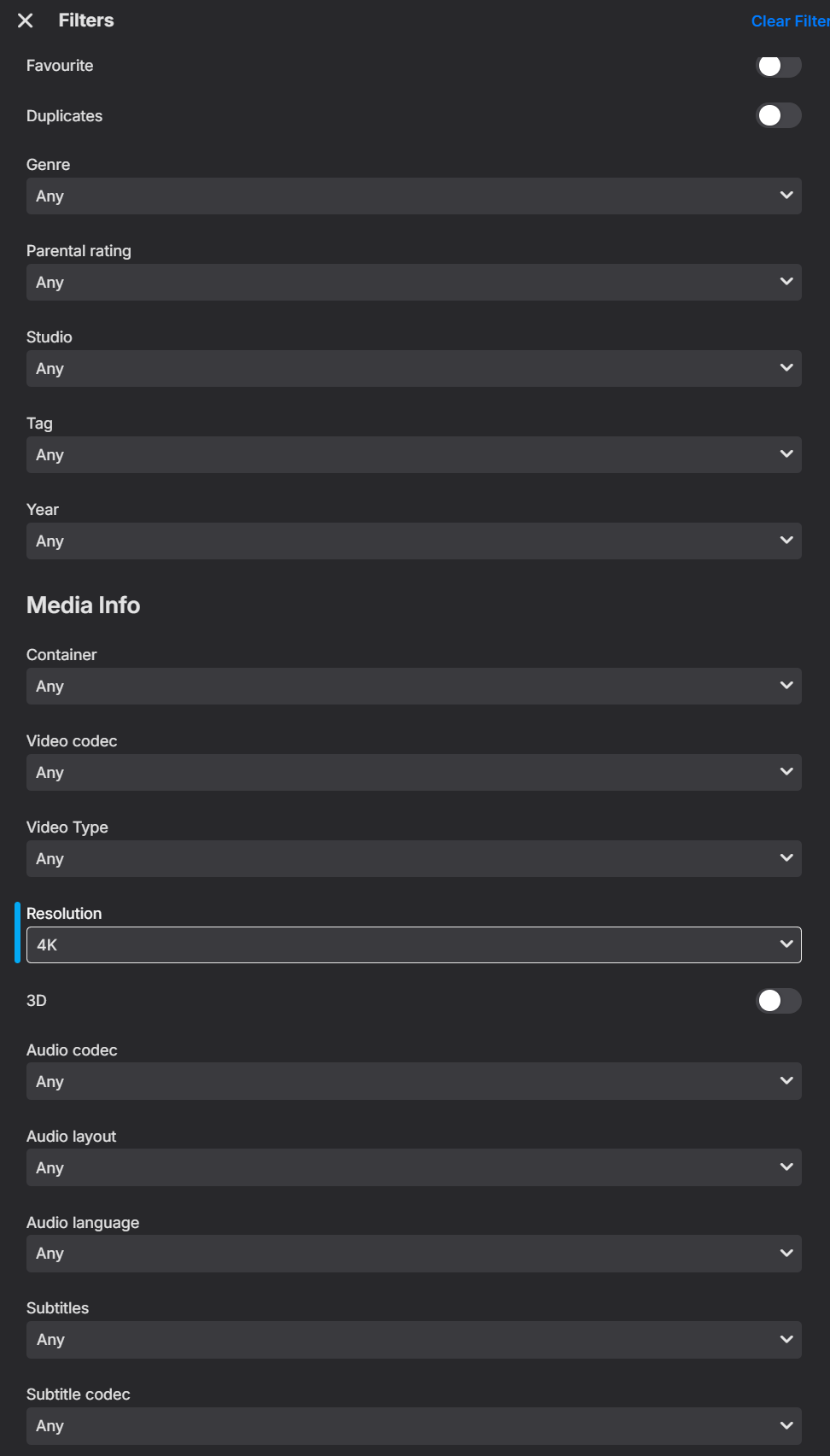

CHA0SENG7NE 31 Posted May 19 Posted May 19 Hi I would like to have two movie libraries. HD and Lower, 4k. I prefer to not use filters to see only 4k. Is it possible to have the separate libraries and use the Multi version detection option so it combines all the movies from both libraries?
js28194 76 Posted May 19 Posted May 19 Super confused by the question. You want separate libraries to differentiate based on quality but combine also based on differences? That makes ZERO sense to me but I digress and pass to the people smarter than I am. What "filters" do you speak of? Is a dropdown box too difficult for you on what version you would like?

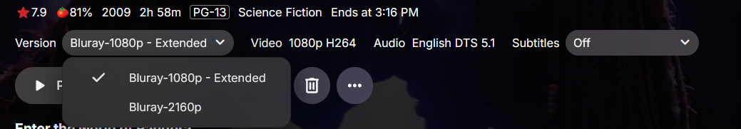

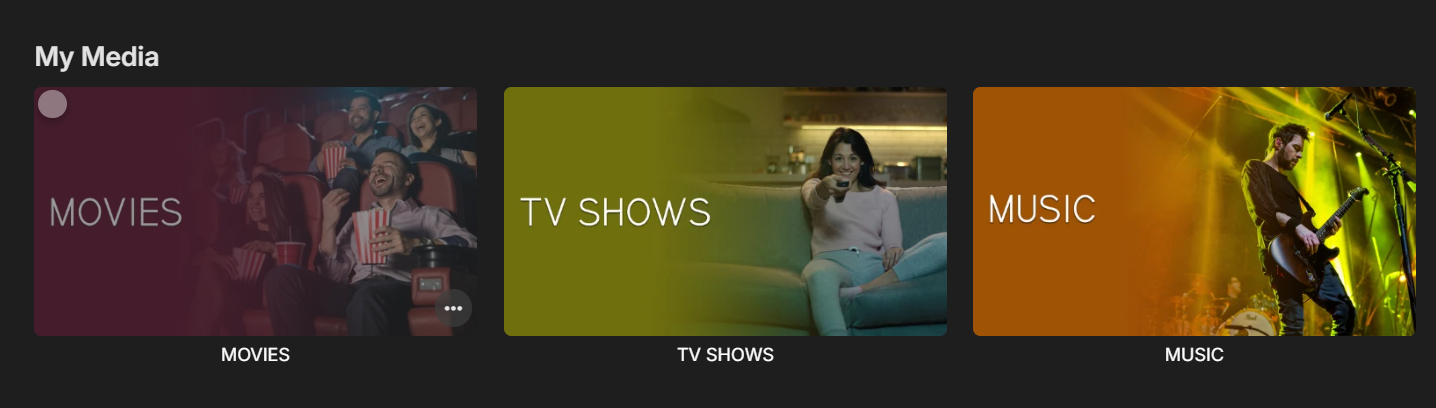

CHA0SENG7NE 31 Posted May 19 Author Posted May 19 Hi sorry to be confusing. Ill try and make it clearer... On the home screen I would Like Movies & 4K Movies Libraries. Not just Movies as shown in the example. This will allow me to look at 4k movies only with ease. No use of search filters required. But in the standard movies library I would like to use the multi detect function to include the 4k. So I can see all versions and use the drop down in the example you gave. Basically have a 4k movie shortcut as a library and also included inthe normal movie library. Hope that is clearer Thanks
Lessaj 613 Posted May 19 Posted May 19 (edited) I think you could achieve this with STRM files, depending on how you store the media. If you have the media in the same folder used for the non-4k content, you can create a folder for the 4k content with strm files that point to the originals. This would give you multi-version in your "main" library while also seeing the 4k separately, without duplicating the files on your storage since the strm is just a link to the other file. https://emby.media/support/articles/Strm-Files.html Edited May 19 by Lessaj
js28194 76 Posted May 20 Posted May 20 Try this an example below: Separate them at the library / folder level: Folder Structure - F:\Media\Movies\4K F:\Media\Movies\1080p Then you can create 3 different libraries. First is your main "Movie" library that includes all paths then... One called "4K Movies" that only includes the 4k folder and one called "1080p" that only includes the 1080p folder.

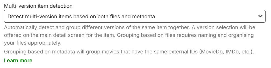

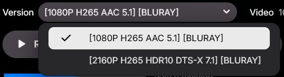

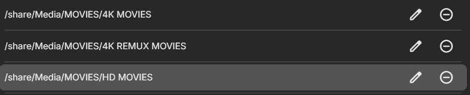

CHA0SENG7NE 31 Posted May 26 Author Posted May 26 I have tried with different libraries and seems to be working fine. I wanted to have a movies library but when I add separate folders for 4k, 4k remux, HD. It doesnt merge the movies between them. I have to add the top layer folder that contains these to work. Unless Im doing it wrong?
Luke 43549 Posted May 26 Posted May 26 4 hours ago, CHA0SENG7NE said: I have tried with different libraries and seems to be working fine. I wanted to have a movies library but when I add separate folders for 4k, 4k remux, HD. It doesnt merge the movies between them. I have to add the top layer folder that contains these to work. Unless Im doing it wrong? HI there, can you please provide a specific example? How to Report a Problem Thanks !
CHA0SENG7NE 31 Posted May 26 Author Posted May 26 If I add separate folders to a movie library in example (these folders are all contained within a parent folder) The multi-version wont merge them together like so.. That only works if I use the parent folder only, with the sub folders inside. Is this correct?
Luke 43549 Posted June 5 Posted June 5 No, it should work either way. But it likely will not work if these folders are also used in other libraries.
