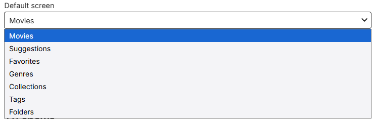

dyecast 8 Posted May 16 Posted May 16 I’ve seen this on multiple Rokus with multiple users. No matter what I set in the webUI from my phone or PC, in Roku it will default to the Suggestions section within each library every time 2

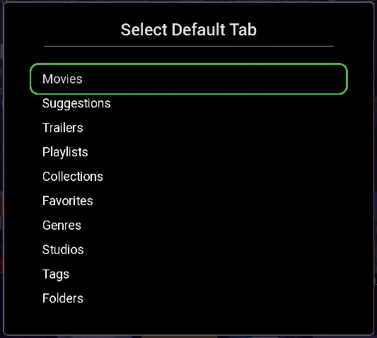

Solution speechles 2130 Posted May 17 Solution Posted May 17 (edited) The web app doesn't show all the same section headers that the Roku app does. Because of this the Roku expects you to set the default inside the Roku app. Press * or navigate to the cog/gear at the top of the screen. It will take you to the Settings menu. There will be an option for Application Settings. Then under that an option to "Set Default Tab". The tabs differ the Roku offers. What we could do is have the top option "Use Server setting". Then below list all the ones you can set different for just the Roku app. The idea was perhaps the Roku you want different than the web app. The Roku offers more landing tabs than the web app. This is why it differed. But we could do like I mention and that would solve this issue. I can add this to our issue tracker. Reference: Issue #1787: Library View - add option to landing tab selector "Use Server Setting" to inherit landing tab from server Edited May 17 by speechles
Luke 43550 Posted May 17 Posted May 17 HI, we are working on unifying these, but for now you will need to configure it separately in the Roku app. Thanks.
