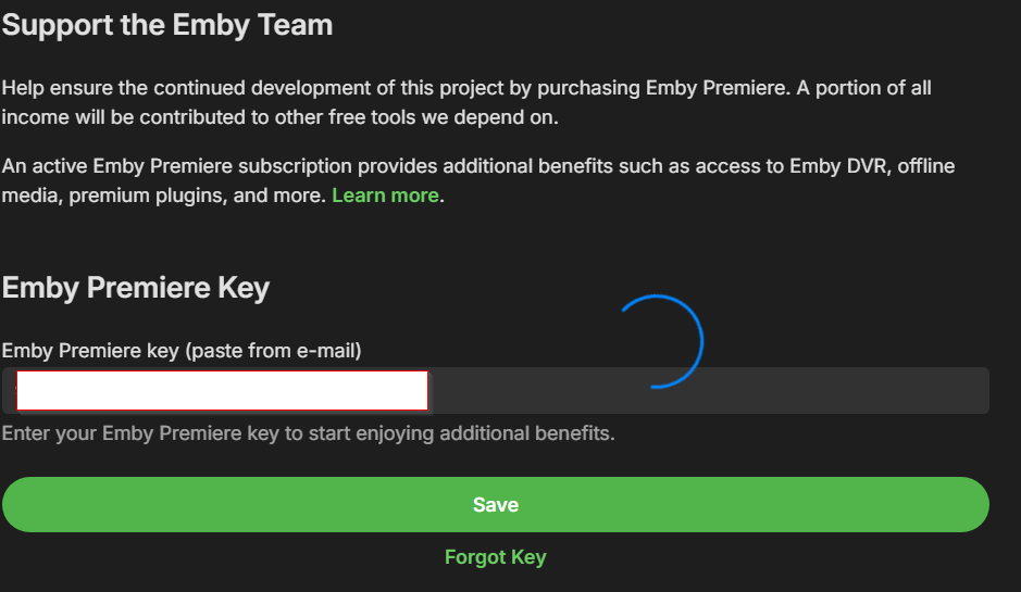

knet2020 3 Posted May 15 Posted May 15 I'm not sure when this started, and it's a bit unusual. I use the local web app and a few tablets/phones to access my instance. For the past few hours, the Premiere key has not been recognised, but so far as I can see, only on the web app. The key is correct, and it does seem to recognise it, but despite restarting my machine and Emby, the issue persists. I'm happy to provide logs or additional information if needed.

ebr 17032 Posted May 15 Posted May 15 There is no validation attempt in that log file. When you get that spinning circle, look in the browser console. Something is probably blocking the device validation.
Solution knet2020 3 Posted May 15 Author Solution Posted May 15 (edited) 35 minutes ago, ebr said: There is no validation attempt in that log file. When you get that spinning circle, look in the browser console. Something is probably blocking the device validation. Yeah, there is an entry of a connection to validate https://mb3admin.com/admin/service/registration/validateDevice? with the result of 'ERR Blocked by Client', which is not something I am familiar with at all. I have made no changes to my setup, which is/was working fine. I have disabled my proxy / vpn and whitelisted the root mb3admin.com. Quote Doh, I had noscript running, and mb3admin had no permissions. I enabled the 'trusted' flag and re-tried, and it worked 1st time. Always check extensions first, I have heard and seen, it's good advice. Marked as a solution Edited May 15 by knet2020 Marked as a solution 1
