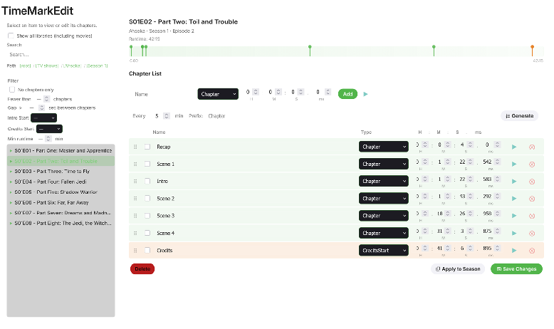

yocker 2084 Posted May 14 Posted May 14 (edited) About time this plugin gets it's own page instead just being mentioned in the EmbyCredits thread. This is a plugin for editing time marks metadata in Emby heavily inspired by ChapterAPI (with permission) and with idea from @GrimReaper While similar to ChapterAPI this plugin has some extra filters, a video preview with fint tuning option and other things to help editing time marks in videos. Download at: Releases · yocksers/TimeMarkEdit Please report any bugs you may find. As always, while i have tested and use the plugin my self it is USE AT YOUR OWN RISK! Edited May 15 by yocker 4 1

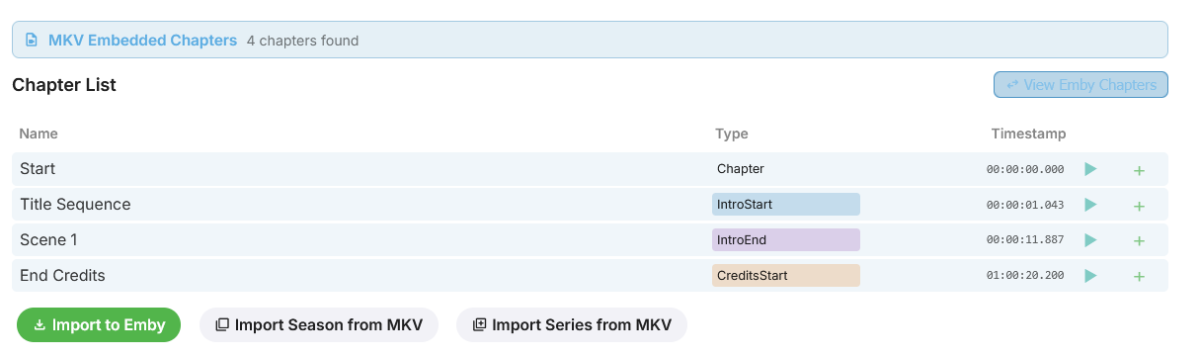

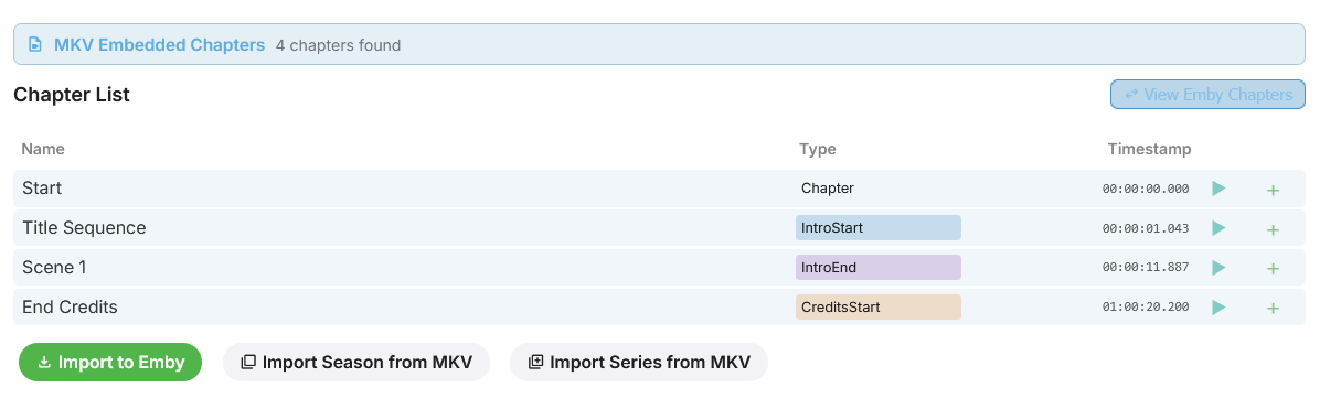

yocker 2084 Posted June 15 Author Posted June 15 Thought i would post a little preview of what i have been working on as it came up in conversation. I have been working on having this plugin and EmbyCredit work with embedded MKV time stamps. It's not finished and i'm taking a summer break atm. so release will maybe take a while. The code is nearly finished for both plugins though (TimeMarkEdit being 99% done). 1
yocker 2084 Posted June 16 Author Posted June 16 Decided to just finish it as it was very nearly done anyway and i have a little time to my self until next event in the summer calendar. It's available (v1.0.3.0) on Github. EmbyCredits still need some work for it to be able to read and import MKV data so that WILL take a while. Please report any bugs.
