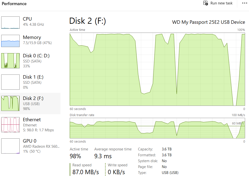

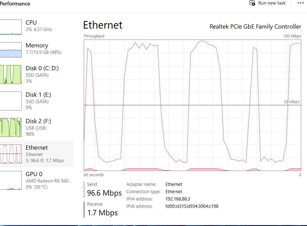

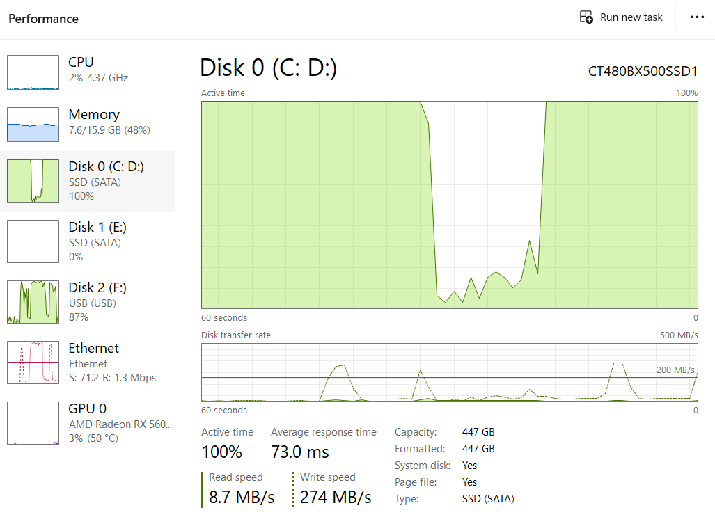

Bob1969 16 Posted May 11 Posted May 11 I am currently getting buffering problems when i stream 4k HDR movies to my Samsung Emby tv app. In the past it used to happen with 360p content too but that seems fine now. The movie plays fine on the pc app. When the movie start to buffer you can hear the fans in my pc get louder. My cpu and memory seem to be fine but the disk usage on C drive and F drive goes high. The C drive is the most affected and its the system drive and maxes out at 100%, the F drive is the external USB 3.2 drive. I have a cat 6 cable going from my pc to my router and then an unmarked cable going from the router to the tv, it came with the router. I moved the movie file to my D and E drives but it did not help at all.

Lessaj 613 Posted May 11 Posted May 11 The provided server log doesn't correspond to the ffmpeg log. Seems pretty straightforward to me, it's transcoding the audio and your transcoding temp directory is on C. I don't see any mention of throttling being active, so it's processing as fast as it can. The server log that corresponds would show the time taken by the client to request for the ts segments. Between the video and audio bitrates it's actually getting quite close to the 100 Mbit limit of the ethernet jack on pretty much any TV. Ironically wifi can often be faster, but there are a lot of factors. Looks like a bandwidth problem to me. 1 2
