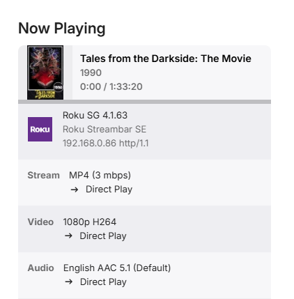

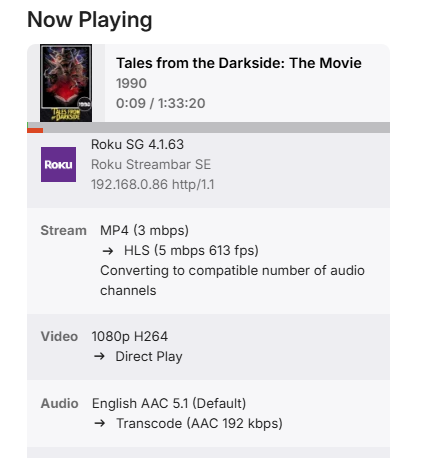

chrisrobbins1970 93 Posted May 10 Posted May 10 (edited) Before the roku update. All my files would direct play. Now within seconds the audio starts transcoding? trying to narrow down - roku emby update or roku os update? Yes, older LG tv using HDMI to Roku Streambar, but it never transcoded audio before.... Why?? enclosed are the logs... embyserver.txt ffmpeg-remux-07f282f1-c7ee-47c7-ad97-be4c87d5304a_1.txt UPDATE: Plugged in a Roku Stick 4K that also got the Emy update..same thing, files that have 5.1 have now started to transcode. This roku stick is on a different build of the Rok OS than the Roku Strembar. Of course, playing through Chrome or Firefox is a direct play both audo/video.; same with android phone, direct play of audio/video. UPDATE 2: Roku Ultra same issue, transcoding 5.1 audio when it hasn't before. So three different Roku devices, same issue... Edited May 10 by chrisrobbins1970 updates

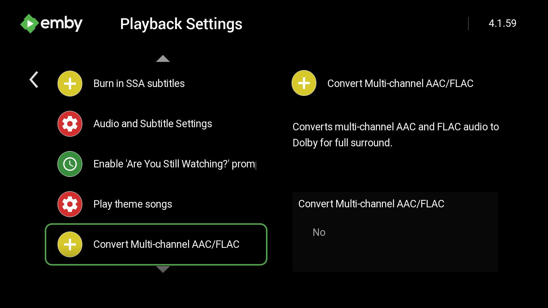

speechles 2130 Posted May 10 Posted May 10 (edited) What do you set for this setting? For the AAC 5.1 not to be transcoded this must be set to NO. You also cannot use "Volume Mode" on your Roku and keep surround sound. This must be set to OFF. Once you confirm it is set to OFF, stop playback of the item, then start playback. When Leveling or Night is used only MP3/AAC stereo audio is allowed. No pass-through codecs can be used. Quote Roku's Volume Mode (found under Sound Settings) offers three options to manage audio levels: Off (default), Leveling (consistent volume, ideal for ads), and Night (boosts quiet sounds and lowers loud ones). These settings can be accessed by pressing the * button during content playback or in the audio settings menu. [1, 2, 3] Edited May 10 by speechles

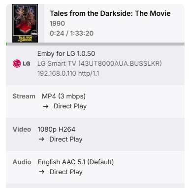

chrisrobbins1970 93 Posted May 10 Author Posted May 10 UPDATE 3: On a new LG tv with a roku stick 4K connected here are the results....same issue with transcoding audio when it never did before... Now using the emby app from the LG store....Direct Playing.... So, 4 different roku devices; same audio transcoding when it never did before the update..and a different device using the emby app; with direct play; no audio transcodding....hmmmmmm
chrisrobbins1970 93 Posted May 10 Author Posted May 10 (edited) new logs... embyserver.txt ffmpeg-remux-6ddf358f-8d0d-44bb-a788-4de48db15083_1.txt Double checked...VOLUME MODE - OFF and NIGHT was already OFF...SOND MODE is standard; CONVERT MUTI_CHANNEL is NO restarted same movie...still same audio transcoding Edited May 10 by chrisrobbins1970
chrisrobbins1970 93 Posted May 10 Author Posted May 10 Sorry... Double checked...VOLUME MODE - OFF and NIGHT was already OFF...SOUND MODE is standard; CONVERT MUTI_CHANNEL is NO restarted same movie...still same audio transcoding

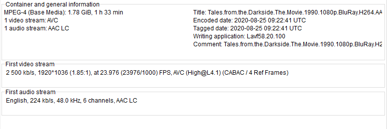

chrisrobbins1970 93 Posted May 10 Author Posted May 10 Thats the strange thing three rokus are on Roku OS 15.2.4 Build 3442 and the other Roku that is connected to the new LG tv is 15.1, has not updated to the 15.2.4 yet and is getting the same results. Agreed something has changed.The Roku OS 15.2.4 build 3442 rolled out this month May 2026...so maybe??, then why woudl the other roku stick not having the update still have the same results. . Here is the mediainfo for the Tales From The Darkside...ALL movies but a few have the same settings and have been playing direct play for years UNTIL this month....

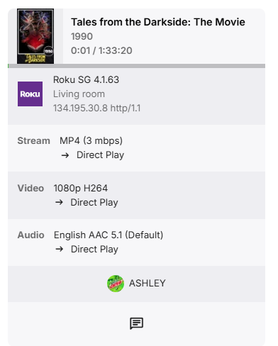

chrisrobbins1970 93 Posted May 10 Author Posted May 10 OK...my daughter in-law is having no issues.... Roku Stick 4K audio settings are on AUTO.. HOWEVER her Roku OS build is 15.1.4 build 3321and mine is 15.2.4 build 3442.. She has made no changes to her ROKU or her TV. Her TV is a newer Vizio...

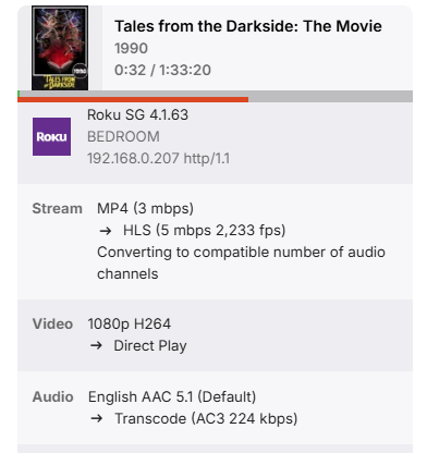

chrisrobbins1970 93 Posted May 10 Author Posted May 10 OK..forcing the audio on my ROKU to DOLBY..did not fix the issue..same audio transcoding...
