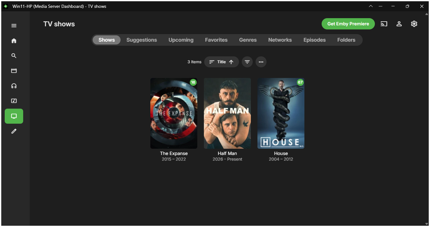

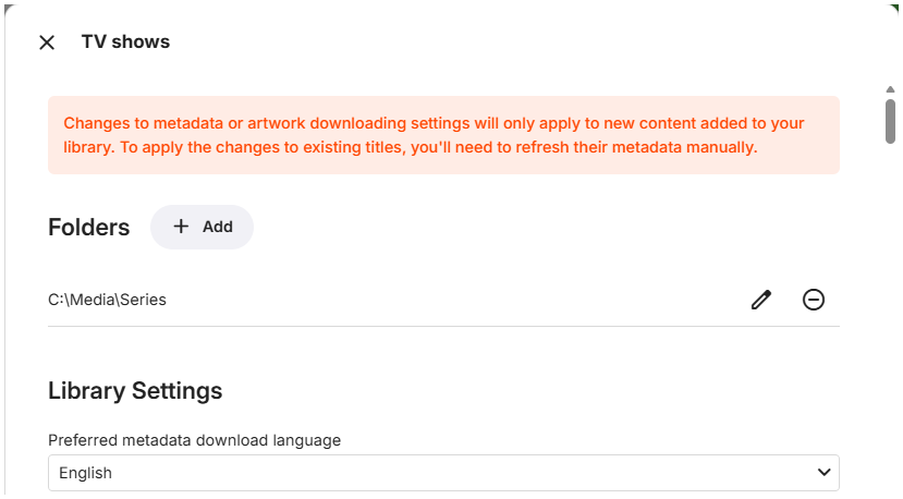

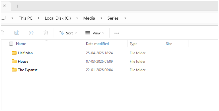

ramansgdeep 4 Posted May 17 Author Posted May 17 Thumbnail of TV shows library on home screen. This thumbnail is a collage of shows that it portrays as being part of the current library. The actual current shows in the library. The shows in the thumbnails have been deleted months ago, the library has been re-scanned many times since, the server has been restarted many times, the computer has been restarted many times. I have manually deleted the thumbnail pic via mouse hovering > three-dot menu > Edit images > Primary > delete. (the thumbnail is the primary image). Deleting it removes the thumbnail and makes it blank. It regenerates another collage afterwards after a while. The new thumbnail is of other set of deleted shows. Actual folders on device. Settings of the library pointing to the folder. Do you also want server logs?

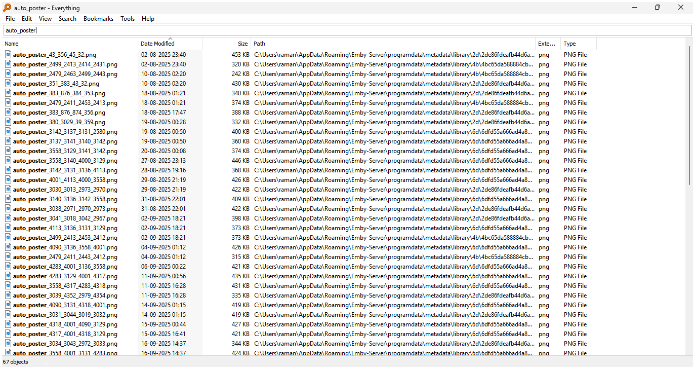

yocker 2078 Posted May 22 Posted May 22 4 hours ago, ramansgdeep said: been there, done that. unfortunately it doesn't help. In Emby-Server\programdata\metadata you will find all the posters that Emby has saved. I would suggest not just deleting the folder as i don't know what will happen but maybe deleting the posters will work. Again i don't know, but i would guess if you delete the wrong poster that you can just refresh metadata. Remember to make a backup!!
ramansgdeep 4 Posted May 23 Author Posted May 23 15 hours ago, yocker said: In Emby-Server\programdata\metadata you will find all the posters that Emby has saved. I would suggest not just deleting the folder as i don't know what will happen but maybe deleting the posters will work. Again i don't know, but i would guess if you delete the wrong poster that you can just refresh metadata. Remember to make a backup!! I went to the metadata location and found that files with the name of `auto_poster_[Number1]_[Number2]_[Number3]_[Number4].png` are the library hero images that we are talking about. Each number is an identification for an individual item trickling down to its respective primary image. I could delete all these images to force emby to generate new auto-posters to test if the bug lies here in the non-deletion of them but I'd rather not risk testing this workaround only to lose this data (referrring to the old and now-defunct library hero images) which could be used to actually fix the bug in emby itself. Here's a screenshot of me finding a total of 67 auto-poster images with the oldest one dating back to 02-08-2025. I'd appreciate if a dev could take a look at this @Luke 1
Luke 43549 Posted May 25 Posted May 25 There was an issue in an older version of the server not cleaning those up. Newer versions of the server will delete the file once it is no longer used, however it won't go and clean up all of those older ones. So for any given folder, I would think it should be safe to delete all of them except for the newest one.
