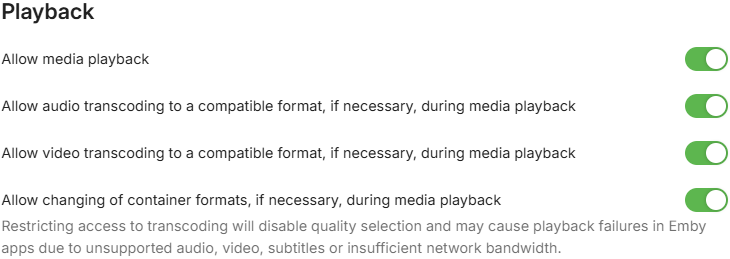

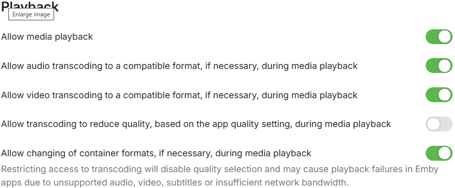

dprovencher 6 Posted May 10 Author Posted May 10 (edited) 49 minutes ago, Luke said: Hi, have you explored user permissions on the server where you can already do this? Well I didn't see this option. In the thread I linked above you said the option was dropped in favor of the "auto" bitrate. Is it incoming already in beta? This is what I have : This is what I need : Edited May 10 by dprovencher
Luke 43667 Posted May 10 Posted May 10 53 minutes ago, dprovencher said: Well I didn't see this option. In the thread I linked above you said the option was dropped in favor of the "auto" bitrate. Is it incoming already in beta? This is what I have : This is what I need : OK right that isn't there anymore, but you have two choices that can still help. You can set the default auto quality which will be used as long as they don't touch the client-side option. Then as a last resort, you can cut off all video transcoding if absolutely necessary.
dprovencher 6 Posted May 10 Author Posted May 10 56 minutes ago, Luke said: OK right that isn't there anymore, but you have two choices that can still help. You can set the default auto quality which will be used as long as they don't touch the client-side option. Then as a last resort, you can cut off all video transcoding if absolutely necessary. Thanks Luke, I did know about those 2 options. What I would like is a middle-ground option, to force "auto" quality so the bitrate I set in "default auto quality" is used , or bring back the option in the screenshot above, that would be exactly what I need. So keep the absolutely necessary transcoding activated but disable or ignore the quality setting (max bitrate) on the client. Thanks, 1
