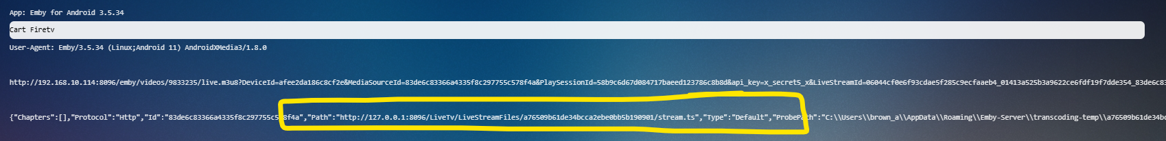

ab123ga 25 Posted May 8 Author Posted May 8 It must be because as noted it works fine for ios, firestick etc. Roku is the only app that cannot support the proxy structure. The general log has where I played this same channel on firetv. I don't know if i'm displaying everything needed but this shows when I tested the same channel 2026-05-07 13:00:13.050 Info SessionManager: Playback start reported by app Emby for Android 3.5.34 on Cart Firetv playing American Heroes Channel. Position: 0 ms. PlaySessionId: 3ec6d9243e204257848560ad3402b08f. IsPaused: False 2026-05-07 13:00:13.051 Info PlaystateService-0HNL9A0CUHT11:00000001: http/1.1 Response 204 to host11. Time: 3ms. POST http://192.168.10.114:8096/emby/Sessions/Playing?X-Emby-Client=Emby for Android&X-Emby-Device-Name=Cart Firetv&X-Emby-Device-Id=afee2da186c8cf2e&X-Emby-Client-Version=3.5.34&X-Emby-Token=x_secret9_x&X-Emby-Language=en-us&reqformat=json. 2026-05-07 13:00:13.051 Info Trakt: Playback Started

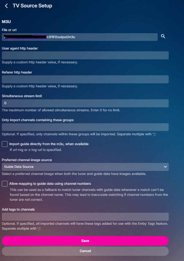

ab123ga 25 Posted May 9 Author Posted May 9 (edited) Help me understand why you say that. The emby server and the proxy are on the same physical computer. And that proxy server should access the same set of streams since it all goes through emby then the proxy. If I'm on Firestick the same emby server has access to the same proxy then the same streams and it works. However when I access from Roku, that same emby server which should be talking to the same proxy server cannot play the same set of streams. I don't get that sequence of steps since both Roku and Firestick are running their respective Emby apps connected to the same emby server. Using what you said, it would be assumed that the proxy streams for channel "x" are different for Firestick vs Roku. And I will remind you that I noted a specific stream on my proxy is set to redirect where the direct provider url comes to emby. In that scenario the emby server plays that ok on Roku. And to answer the other question: I have dropped all the other tuners in emby I had since it is managed via dispatcharr. The URL for that dispatcharr system is http://mydomain:9191/output/m3u. This URL is fed into emby like any other tuner and it obtains the channels. I don't know any more about how dispatcharr works to answer any more than that. Edited May 9 by ab123ga
ebr 17032 Posted May 9 Posted May 9 8 minutes ago, ab123ga said: Help me understand why you say that. Because of this: Connection to tcp://127.0.0.1:8096 failed Again I ask, is that mapping correct? Should it not be http://127...? The port also looks questionable. Why is ffmpeg trying to connect back to the Emby server port? Shouldn't it be directed to the actual source, or the proxy port?
