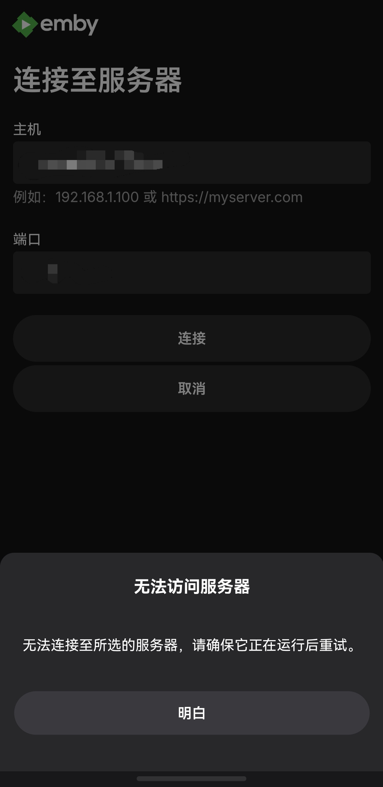

ruiliuhuo 3 Posted May 8 Posted May 8 (edited) My phone can access Emby Server by entering and resolving an IPV6 domain name through a web browser in a public network environment, but accessing the same domain name using the Emby app immediately displays "Unable to access server" Sorry, my English is not good. Edited May 8 by ruiliuhuo

ruiliuhuo 3 Posted May 11 Author Posted May 11 Sorry, the same issue has occurred again. The emby app still cannot access the emby server through the domain name, but the web browser can. How can I solve this problem.
ruiliuhuo 3 Posted May 22 Author Posted May 22 On 2026/5/20 at PM12点15分, Luke said: 嗨,你尝试我建议的方法了吗? I have restored system.xml to its original settings, but I still cannot access it via the domain name. My domain name only has an AAAA record configured. When I enter the domain name in the app and tap "Connect", it immediately jumps to the "unable to access" screen without even attempting to connect to the URL.

ruiliuhuo 3 Posted May 24 Author Posted May 24 On 2026/5/22 at PM12点53分, Luke said: 是什么让你认为它没有尝试连接到该网址? Sorry, after investigation, the issue seems to be with the phone system. The Android software I installed on the HarmonyOS 6.1 system may not have sufficient network support. Entering IPV6 is possible, but domain names are not supported. I can successfully access the internet by entering a domain name on an Android phone. May I ask, will your company develop apps that run on the HarmonyOS system? 1
