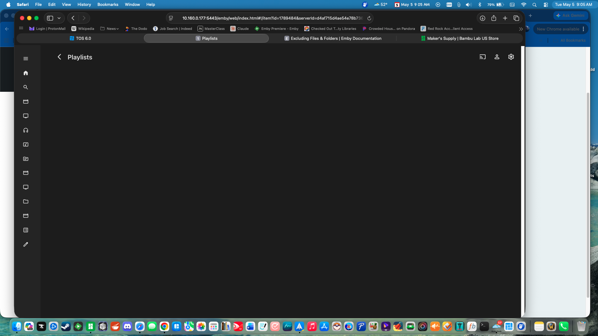

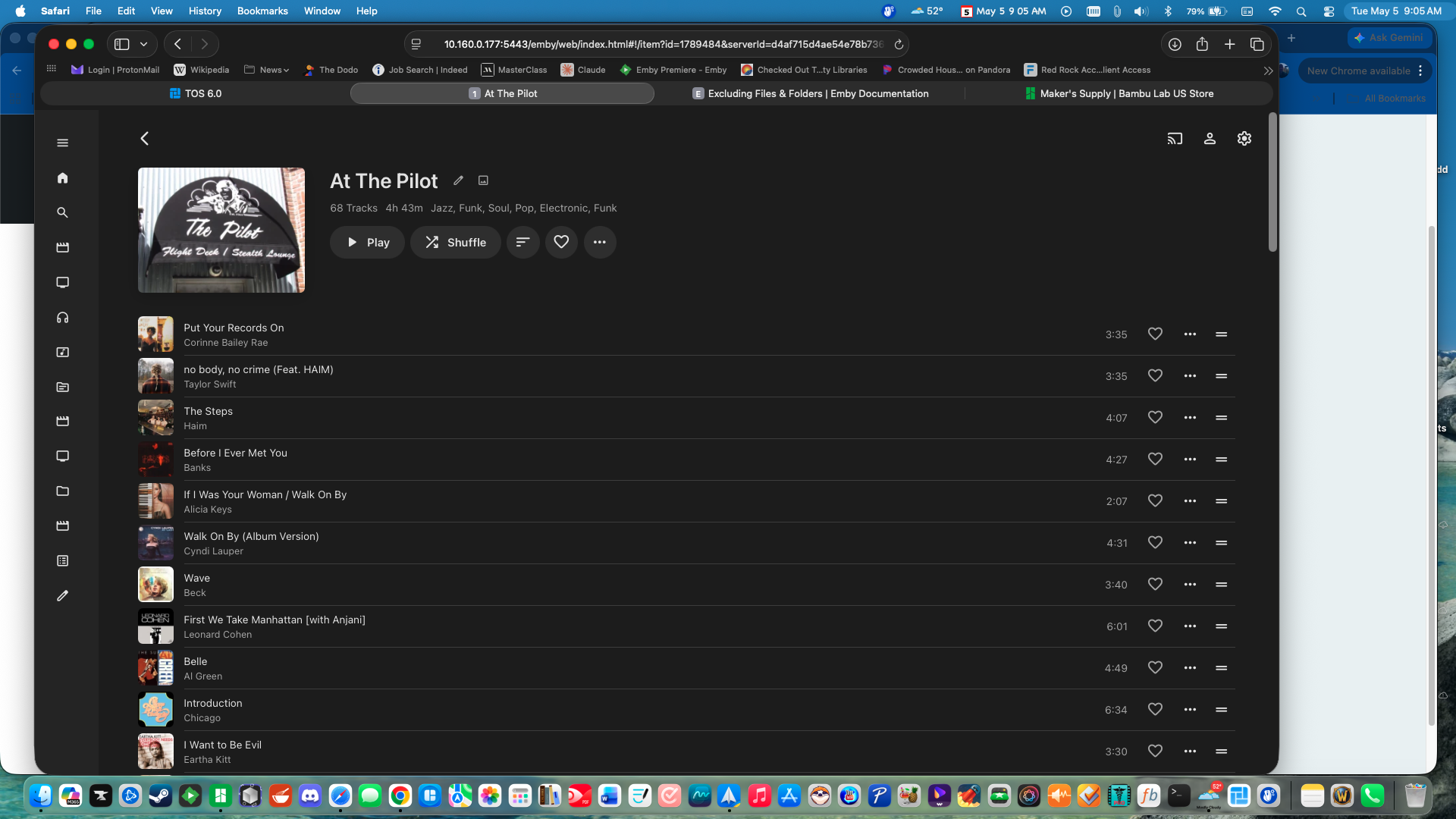

brucesnelgrove 2 Posted May 5 Posted May 5 I'm running a TM F4-424 Pro On TOS 6 and Emby 4.9.3.0. I've recently migrated from Plex and rebuilt the playlists manually. Everything runs super fast, EXCEPT for the playlists. Emby opens the Playlist Library fast, when I open(not play) a Playlist, it takes about 30 seconds to load. This is the only aspect of the server that behaves this way. I have double checked the settings and permissions for both Emby and 424 PRO. Each Playlist is either all audio, or all music video, never combined. I have noticed that the server store all playlists in the same folder(userplaylists). This was a sudden development. Could storing the playlists this way be causing the problem? Can you separate the audio and video playlists? If I do have to separate what do I name the new folder? I've included screen shots of the process(that's how long it takes.

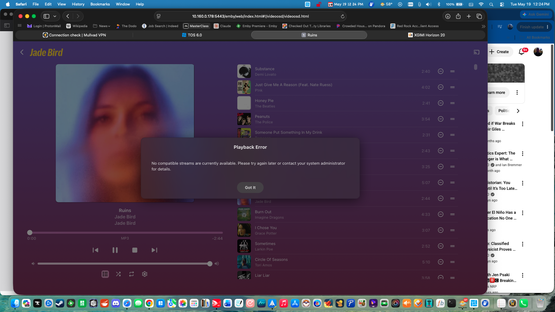

brucesnelgrove 2 Posted May 19 Author Posted May 19 I confirmed permissions for the files you outlined and the rest of my media files fyi- the files outlined weren't in any playlists or collections. I tried downloading Playlists to my iphone and ipad. It failed because it downloaded just the audio files separately, no playlist . I am also getting " no streaming channels available" errors which is a recent development. Tried rebuilding db - no go. Problems seems to concentrated in Playlist feature of Emby.
brucesnelgrove 2 Posted May 19 Author Posted May 19 This is what I've been encountering both in Playlists and regulat audio files. Don't know if it's related.
Luke 43719 Posted May 25 Posted May 25 On 5/19/2026 at 2:27 PM, brucesnelgrove said: This is what I've been encountering both in Playlists and regulat audio files. Don't know if it's related. Hi there, let's look at an example. Please attach the information requested in how to report a media playback issue. Thanks!

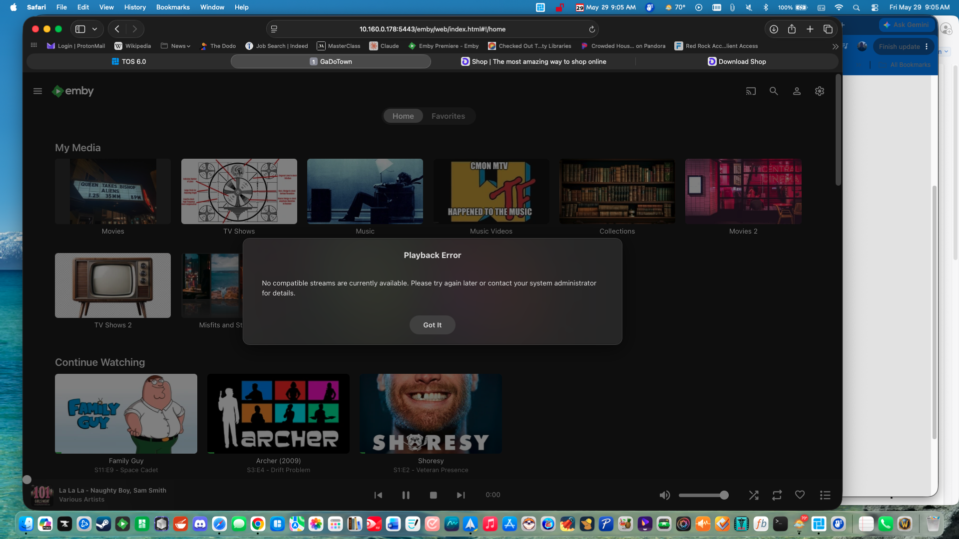

brucesnelgrove 2 Posted May 30 Author Posted May 30 This is error when I attempted to "shuffle" directly from the music folder. This does not happen on iOS. embyserver-2.txt
Luke 43719 Posted June 5 Posted June 5 On 5/30/2026 at 11:42 AM, brucesnelgrove said: This is error when I attempted to "shuffle" directly from the music folder. This does not happen on iOS. embyserver-2.txt 1.99 MB · 0 downloads Maybe this is your issue? 2026-05-30 09:38:00.006 Error UniversalAudioService-0HNLS95NDSS62:00000001: Error processing request *** Error Report *** Version: 4.9.3.0 Command line: /Volume1/@apps/emby/emby-server/system/EmbyServer.dll -programdata /Volume1/Emby -ffdetect /Volume1/@apps/emby/emby-server/bin/ffdetect -ffmpeg /Volume1/@apps/emby/emby-server/bin/ffmpeg -ffprobe /Volume1/@apps/emby/emby-server/bin/ffprobe -defaultdirectory /mnt/public -updatepackage emby_TOS5_APP_{version}_x86_64.tpk Operating system: Linux version 6.1.120+ (root@51f02058744a) (x86_64-tnas-linux-gnu-gcc.br_real (Buildroot 2023.08.1) 13.2.0, GNU ld (GNU Binutils) 2.40) #52 SMP PREEMP OS/Process: x64/x64 Framework: .NET 8.0.22 Runtime: Volume1/@apps/emby/emby-server/system/System.Private.CoreLib.dll Processor count: 8 Data path: /Volume1/Emby Application path: /Volume1/@apps/emby/emby-server/system System.UnauthorizedAccessException: System.UnauthorizedAccessException: Access to the path '/Volume1/GaDo_Storage1/MediaSource/Music/Andrea Bocelli/Passione (Super Deluxe Edition)/Love Me Tender.mp3' is denied. ---> System.IO.IOException: Permission denied The server is being denied access to the file. Can you get this corrected and then try again?
