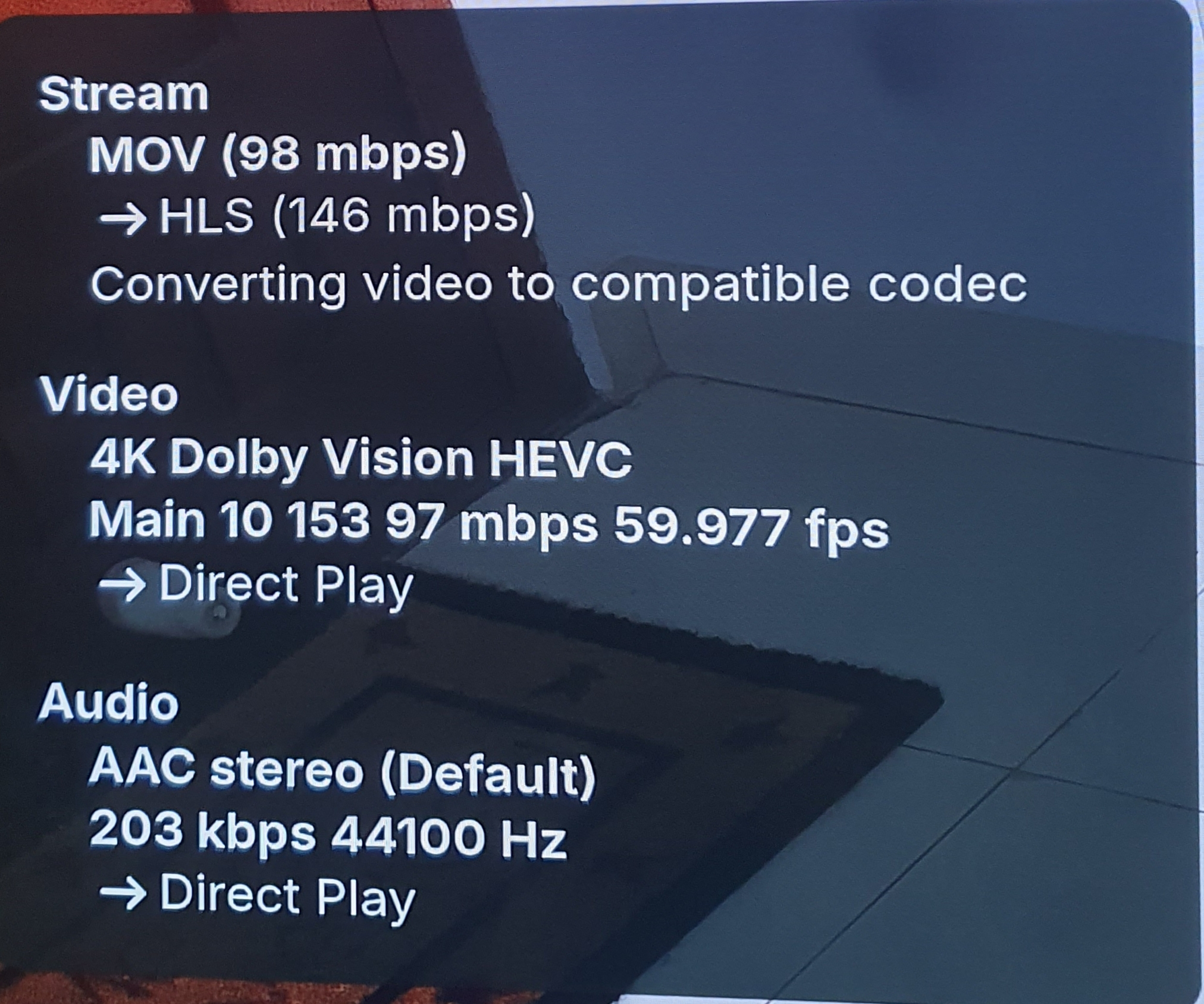

Justin757 9 Posted May 4 Author Posted May 4 Screenshot attached, no clue why its bumping up video bit rate above 100

visproduction 381 Posted May 7 Posted May 7 (edited) Justin, Acceptable quality based on your transcoding settings requires a bandwith of 146 mbps on your hardware. You can get encoding with lower bandwidth, if your hardware can process the encoding fast enough in real time based on your quality settings. At 4K with minimal acceptable quality and your encoding hardware / CPU server speed, during server activity, the media bitrate gets larger to allow real time encoding. You can either get hardware that encodes faster, lower quality settings, use lower resolution master media, change master media to a codec that does not require transcoding (h.264) or pre-encode, not in real time, with a high quality setting and a lower bitrate. The issue to consider is that encoding has to happen faster than playback, so in real time. Your gear has to be able to do that with whatever highest quality media you have. Faster real time encoding means larger bit rates. The ability for each user to view something also depends on the connection, Wifi or Ethernet, their hardware processing, their computer activity load, their Network speed with any issues. It is often something in these links that can cause a slow down of performance. Each user's system can contribute to the issue differently. The TV being able to play the media back in a different method is like saying my car is not running well, but when I take my friends sportscar, it zooms along the highway without an issue. === Also noticed this error - lines 230+ Not sure what this is. Quote Mon May 04 12:58:21.620 GMT+05:30 2026 Error sending request to http://192.168.1.145:8096/emby/Sync/Items/Ready?TargetId=049c7d9b4113a18f: Unexpected code Response{protocol=http/1.1, code=401, message=Unauthorized, url=http://192.168.1.145:8096/emby/Sync/Items/Ready?TargetId=049c7d9b4113a18f} Access token is invalid or expired. java.io.IOException com.mb.android.apiinteraction.RequestHelper$1.onResponse(RequestHelper.java:155) okhttp3.internal.connection.RealCall$AsyncCall.run(RealCall.kt:519) java.util.concurrent.ThreadPoolExecutor.runWorker(ThreadPoolExecutor.java:1167) java.util.concurrent.ThreadPoolExecutor$Worker.run(ThreadPoolExecutor.java:641) java.lang.Thread.run(Thread.java:920) Edited May 7 by visproduction
