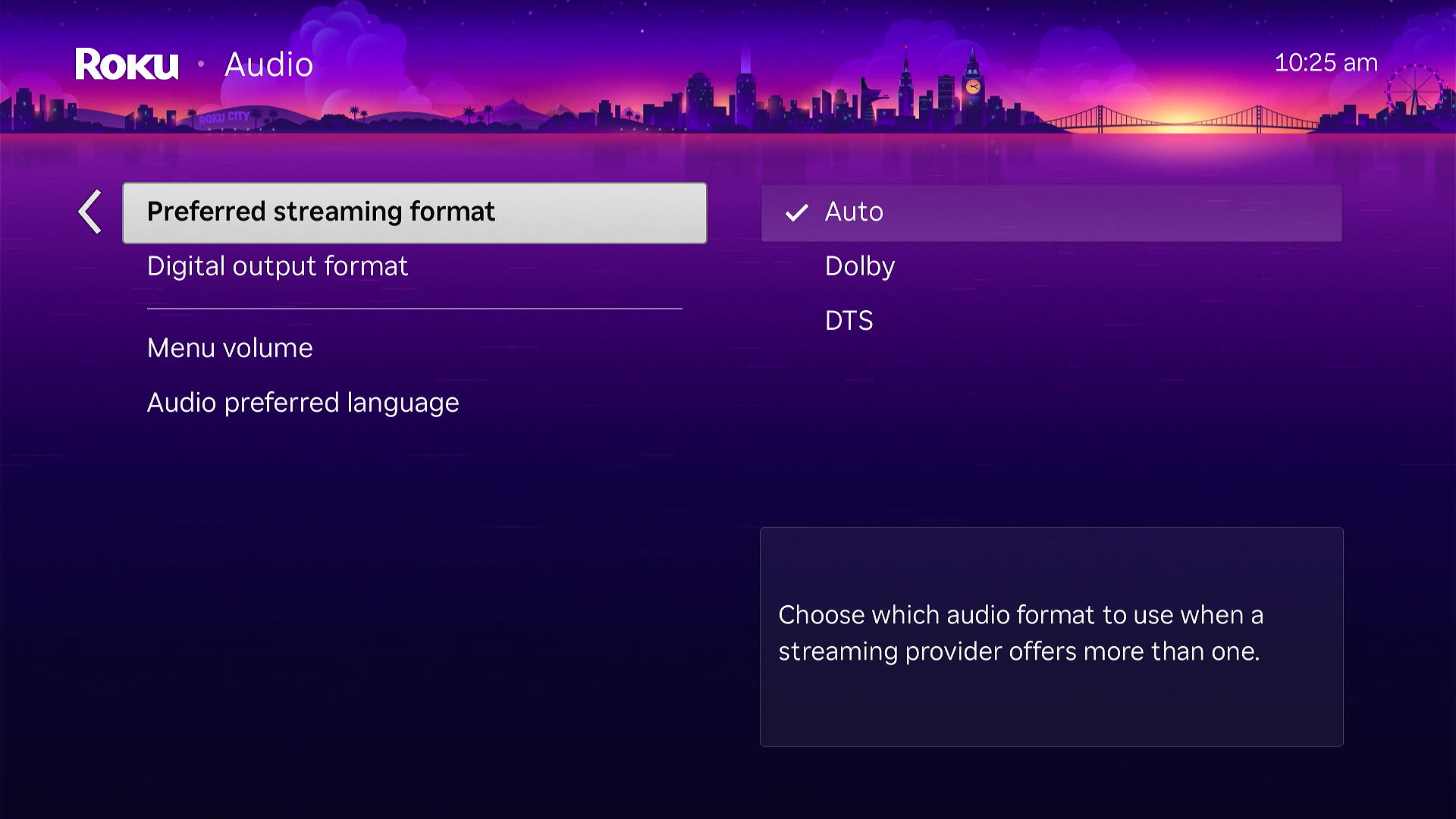

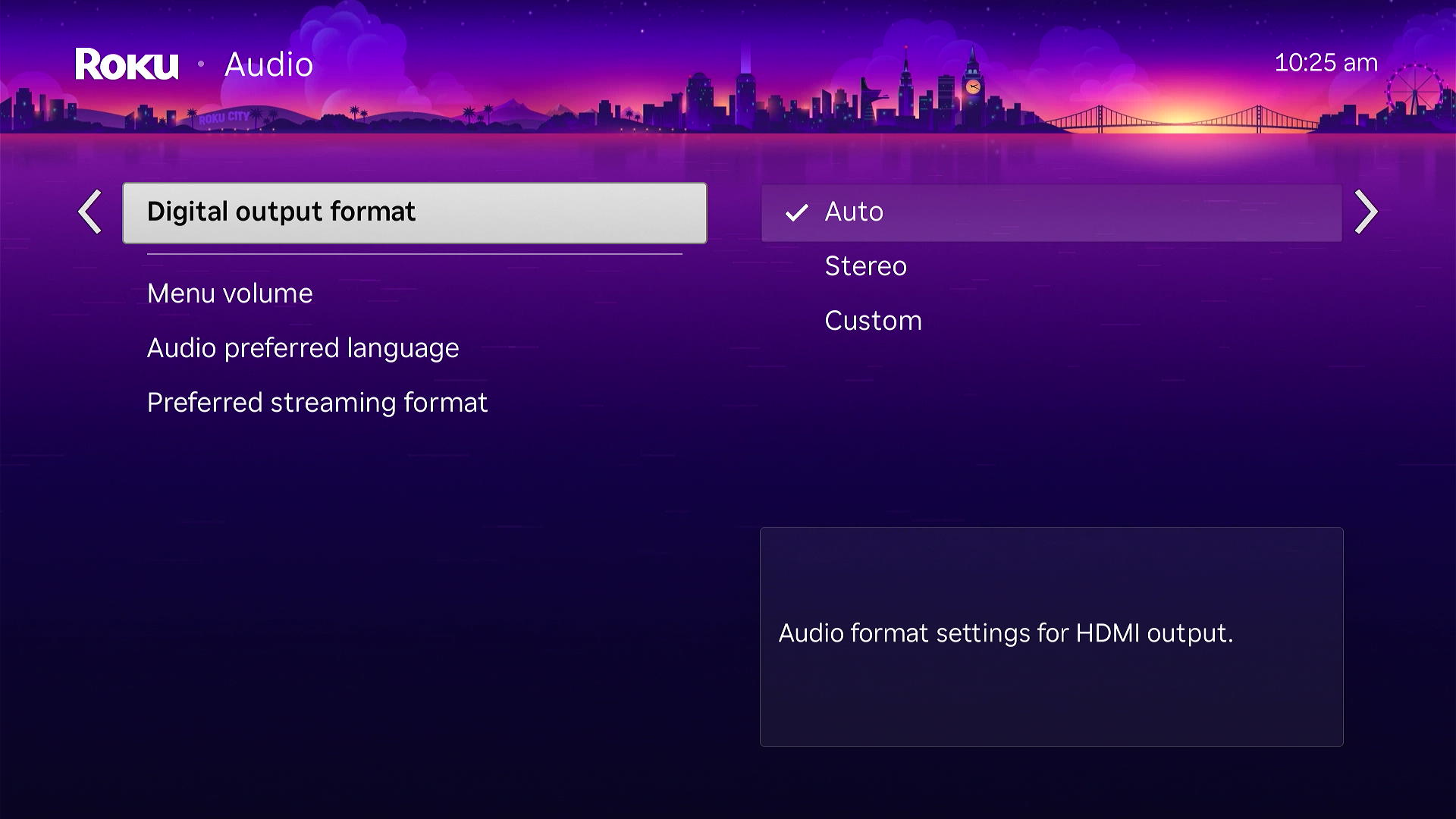

speechles 2130 Posted May 2 Posted May 2 (edited) What do you have set for the options above on your Roku? Realize that "Auto" will only detect things correctly if your TV and AVR are turned on before the Roku is turned on. You might just need to restart the Roku (while TV and AVR are turned ON first) and let the auto-detect run again and it might work. The order the devices are turned on matters when Auto is used. You can also choose to use Dolby for Preferred Streaming Format and then use Custom in Digital Output Format. Then on the Custom make sure Dolby is selected and DTS is not. If your audio equipment is capable of supporting DTS too. You can choose Auto for Streaming Format and on Custom choose both Dolby and enable DTS. Certain Roku devices will convert 5.1 AAC into 2.0 AAC on the device. Other Roku devices do not support AAC 5.1 at all. The setting is to keep the devices which do not support AAC 5.1 from getting fed it. It also works on the devices which support AAC 5.1 to not allow the Roku to strip the extra channels and reduce it to AAC 2.0. You want that setting set to YES if you expect surround sound. AAC should be told to only send in 2 channel when that setting is set. This is what alerts the server it shouldn't go above that with AAC. Edited May 2 by speechles
threnos 0 Posted May 2 Author Posted May 2 Thanks for the replies so far. To clarify, "switching to surround speakers" means using the TV remote to select a different audio-output device. My soundbar/surround system is plugged in via a single HDMI eARC cable. The TV then sees two options for audio out: either the TV speakers, or the soundbar. It's easy to toggle back and forth between them when anything is playing. I usually don't have to, though, because I have previously always just left it on the soundbar 100% of the time. Regarding the audio setting screenshots, I most recently tried with "Preferred streaming format" set to Dolby, and "Digital output format" set to "Custom", where I then select "Dolby Digital", where I then select "Dolby Digital Plus". Before this issue, I wasn't aware of these settings, and they were both on Auto, and I never had problems. Only from reading other posts did I become aware of them, but honestly in the 6+ hours I've spent on this problem before posting to the forum, I tried every possible combination of these settings (with a restart after each change) and nothing affected the issue. I will try to post complete logs soon.
