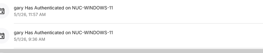

garyro 0 Posted May 1 Posted May 1 I can login fine but shows no content. this happened after roku updated to 4.1.59 i have another tv running an earlier version and it has not problems. I guess the issue is with the latest update. Like I said my server logs show the login is fine so i defiantly connected to the server. A side note I hate the fact the roku does not allow you to NOT update.

garyro 0 Posted May 1 Posted May 1 Here is so more info from me. This morning when I woke up 2 of my tcl roku tv's had updated to 4.1.59 1 had not. the had not works fine. the updated do not work i can login and the server log show i have logged in. there is just no content the app on the tv works just no content. an hour ago my other roku updated to 4.1.59 now that has the same problem. so i would assume the update is the issue. if you need more info just ask. a note that has nothing to do with emby i just hate the fact that roku forces app updates (and no way to roll back)

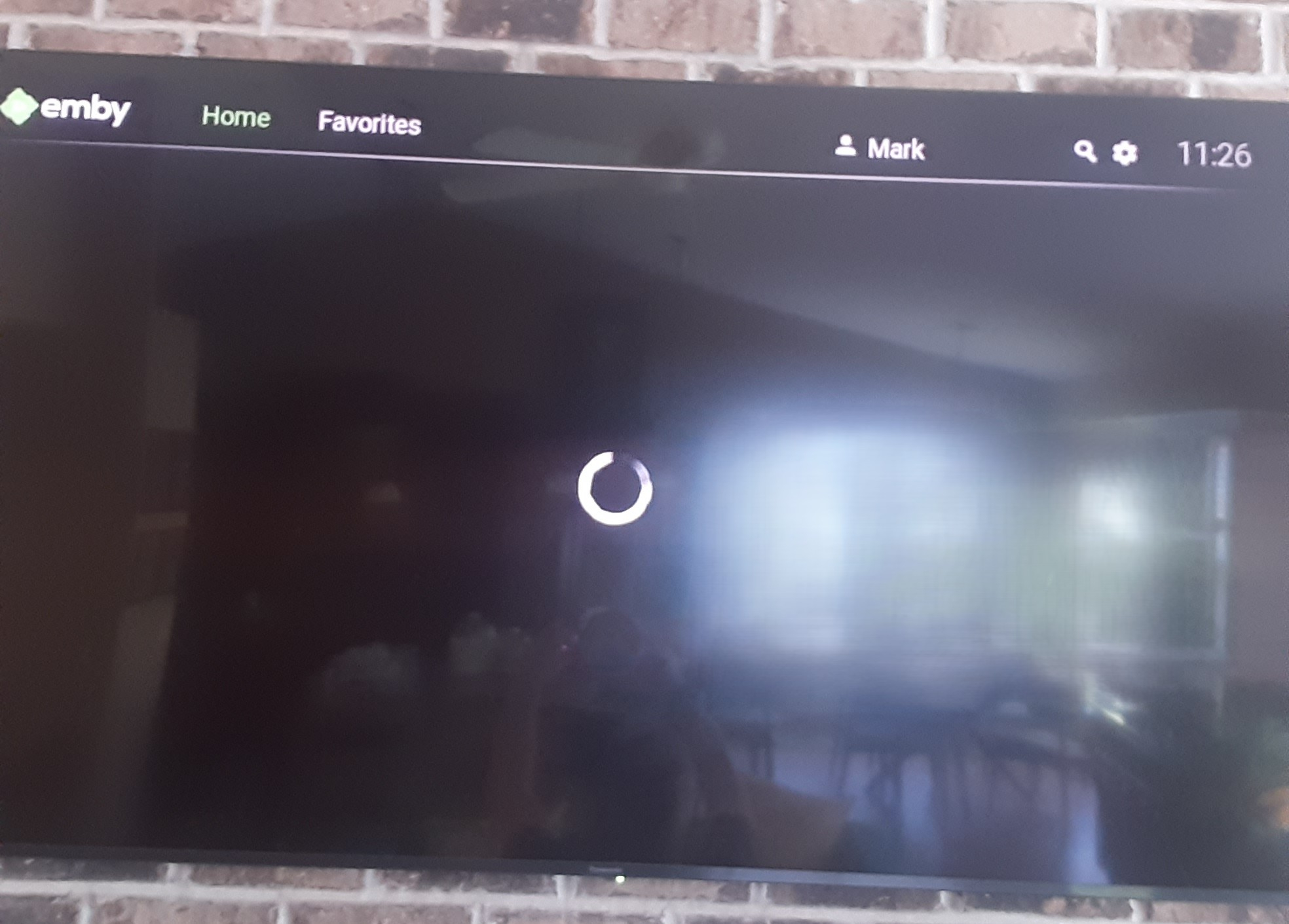

wixwonkity 10 Posted May 1 Posted May 1 In the Roku app my start up behavior is set to "Remember Me" so that the Roku app auto logs in to my server using my (Mark) account. However, when I manually signed out and signed back in, by selecting a server and a user, I still got the same spinning wheel on the home screen. I have a second user that we never use and I basically use that user for testing on the server. I tried manually logging in with that user, and again got the spinning wheel on the home screen. On the server, my home screen selection for (Mark) is: Home screen section 1 = My Media Home screen section 2 = None Home screen section 3 = None Home screen section 4 = None Home screen section 5 = None Home screen section 6 = None Home screen section 7 = None Attached is a photo of the home screen on my Roku Streaming Stick 4K. Sorry for the glare. It just sits on the home screen and spins. I let it sit there for about 1/2 hour yesterday. I hope these adequately answer your questions. Thank you! 1
garyro 0 Posted May 1 Posted May 1 my windows 11 server is 4.9.3.0 login process is as follows: turn on tv click on emby roku app since i am a single user i usually dont have to login as i never logout. I did logout an login. then there is no content the problem is not logging in. as i stated i can see in the windows 11 server that i have logged in
ebr 17032 Posted May 1 Posted May 1 So the app is responsive. You can navigate the top items and get to the user menu, etc.? What about the "Favorites" tab? @garyroWhat home sections do you have?
wixwonkity 10 Posted May 1 Posted May 1 6 minutes ago, ebr said: So the app is responsive. You can navigate the top items and get to the user menu, etc.? What about the "Favorites" tab? Yes, the app is responsive. Yes, I can navigate to the top and get to the user menu and the setting (which is how I logged out and logged back in for testing purposes). So, this is interesting, yes, I can access the favorites tab and it lists my (one and only) favorited tv episode and plays the epsiode. When I go back to the home tab it sits and spins.
Solution ebr 17032 Posted May 1 Solution Posted May 1 @wixwonkityuntil we can push a fix out, you can make your home screen load by adding any other section to it. Put a "Continue Watching" section below your My Media and everything should load for you. Everyone else - do you all have this exact same setup? Nothing on home except "My Media"? 2
wixwonkity 10 Posted May 1 Posted May 1 15 minutes ago, ebr said: @wixwonkityuntil we can push a fix out, you can make your home screen load by adding any other section to it. Put a "Continue Watching" section below your My Media and everything should load for you. That worked!!! Choosing pretty much anything as a second home screen section allows the home screen to load and I can then browse and play media. Any clue what caused this current behavior? You're the best. I appreciate your dedication and tenacity!
