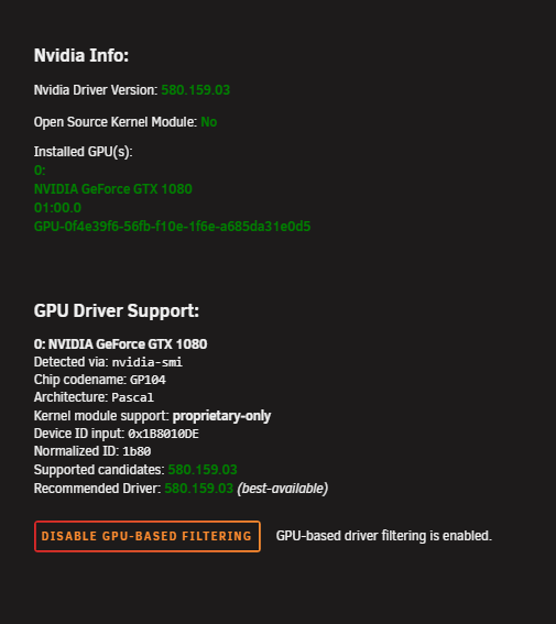

Neminem 2007 Posted May 1 Posted May 1 (edited) Calling out to all unRaiders. When you update to unRaid 7.2.5 you might have issues with Nvidia support in your docker containers. Read this https://forums.unraid.net/topic/198521-unraid-os-version-725-available/#findComment-1620492 to fix it. I'm still not sure if this fix will persist a shutdown or reboot of unRaid. Here is a quick how to. unRaid 7.2.5 Nvidia Bug Might needs to be done after Reboot and after shutdown. I really like my UPS right now Stop Docker Open terminal copy / paste the following lines into terminal. 1 line at a time. nvidia-ctk cdi generate --output=/etc/cdi/nvidia.yaml nvidia-ctk runtime configure --runtime=docker --cdi.enabled Start Docker Edited May 1 by Neminem 1 1

yocker 2094 Posted May 1 Posted May 1 Isn't it just that the driver has been updated and that 10 series and below cards are no longer supported on the the newer drivers? If so choosing a lower version in the plugin should fix it.
Neminem 2007 Posted May 1 Author Posted May 1 No it was not that simple. I was on the last driver version that was supportet / recommended. Hence the quick fix, was to do the following, and that would not be persistent. 5 hours ago, Neminem said: nvidia-ctk cdi generate --output=/etc/cdi/nvidia.yaml nvidia-ctk runtime configure --runtime=docker --cdi.enabled What the updated plugin did was to automatic do the above and persistently apply on reboot / shutdown and reapply after driver update. The funny thing is that it only afflicted docker containers, and docker was updated to 29. 1
