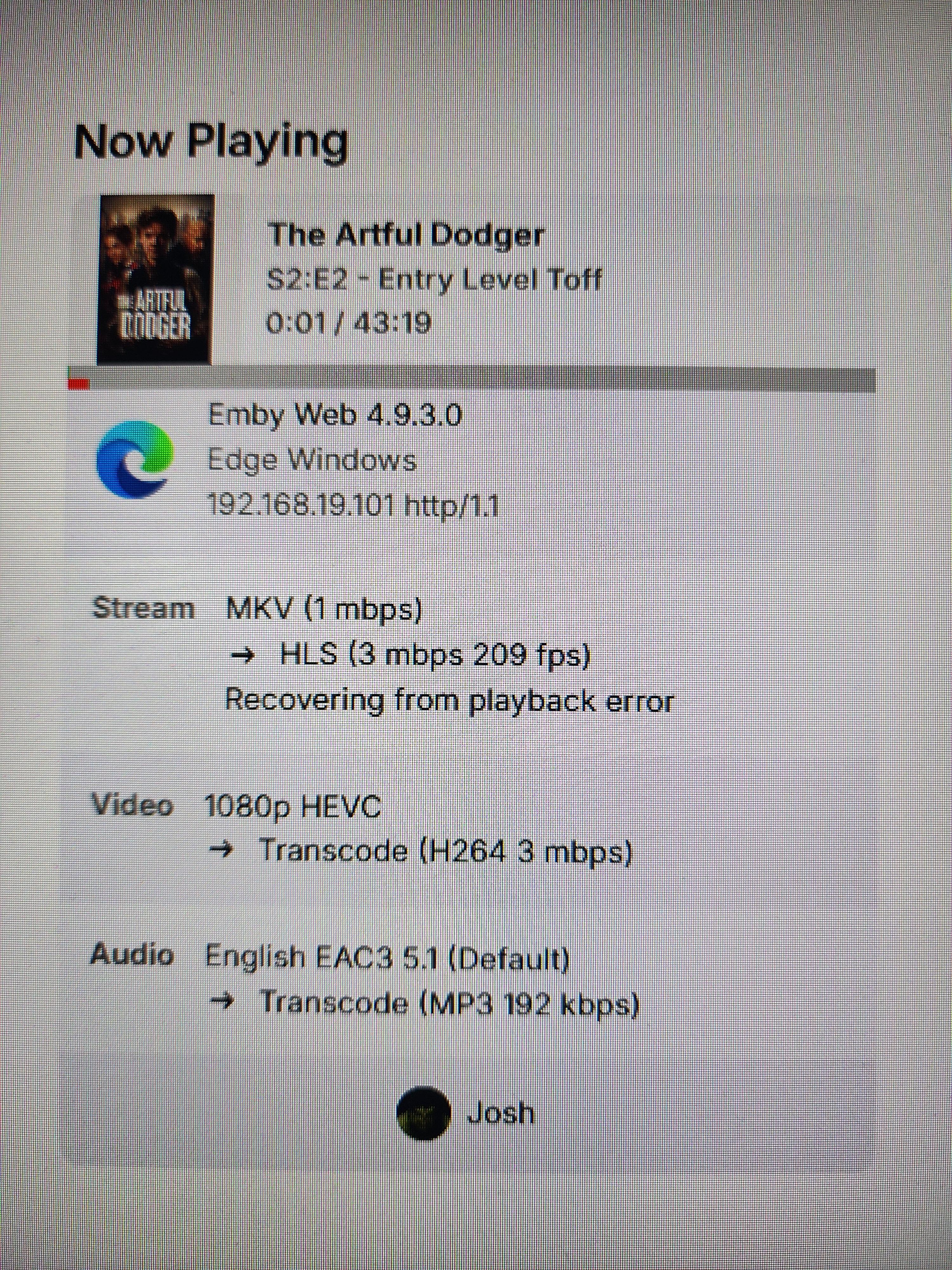

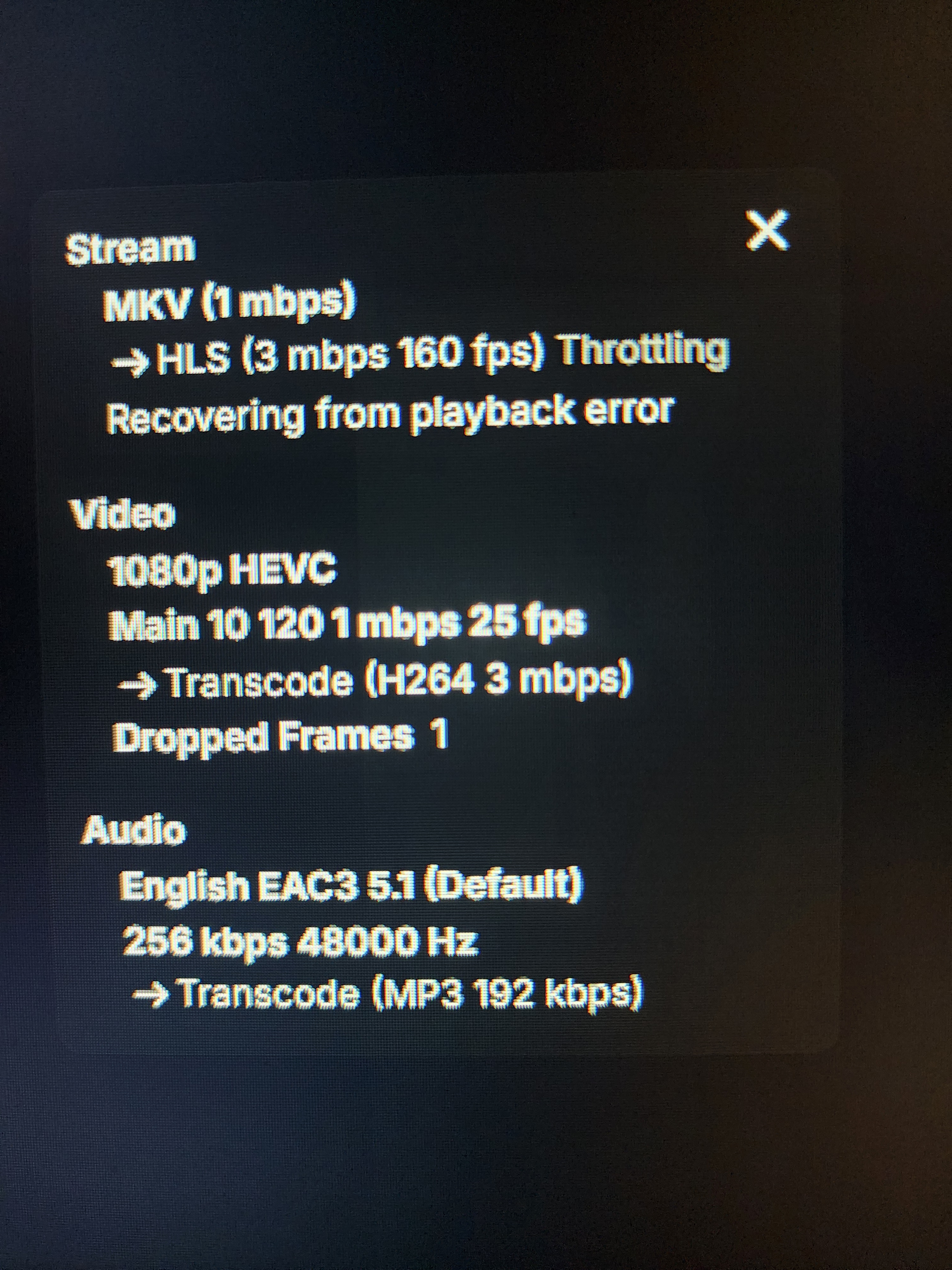

JoshuaAJones 73 Posted April 25 Author Posted April 25 When I first hit Play, it says Direct Play but does not stay there. It starts transcoding (see pic). Nerd stat pic also there. It does it for both local and web address playbacks on Edge. Chrome is awful and hates mkv so I expect it to transcode. Most of the other clients Direct Play most of the time... Shield, Samsung, LG, Hisense, FireTV Just trying to get back to never transcoding. I thought that it might be a networking issue, as I had quite the time connecting to the server yesterday, while my ISP was broken. Everything was super slow. Connection took multiple tries. Sometimes, I had to manually input the IP address. Once on the Home screen, it would play (with a delay), there would be multiple times of random pausing for variable lengths of time (I was thinking maybe an IO problem), and, once an episode completed, the green checkmark would occasionally appear (sometimes that page did not update at all). I could be having new server woes. Not sure. I am trying to get more input from viewers to share and track down a culprit. 1 - ffmpeg-remux-5c1fa27d-a616-468f-b151-be7f388650ed_1.txt 2 - ffmpeg-transcode-95110e3d-d9fc-4477-b7e2-b90e28c7dd36_1.txt
Luke 43549 Posted April 29 Posted April 29 Hi, it starts by direct playing, then the browser video player reports a decoding error of some sort, and so we automatically switch to transcoding to ensure successful playback. By error I mean the browser video player has trouble playing the file. Does this answer your question?
