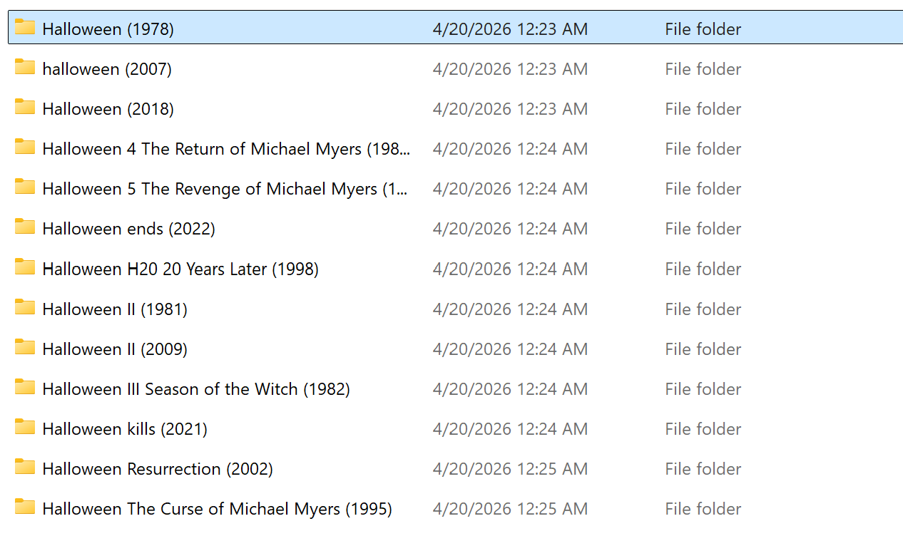

Nelcruz 3 Posted April 19 Posted April 19 Hi, quick question. Can you please explain what I am doing wrong? For example, say I have two movies Carrie (1976) and Carrie (2013). When updating library, it will always populate both movie folders with nfo, jpg and png files for Carrie (1976). This happens consistently. Another example would be Halloween (1978) and Halloween (2018). Thank you for your time. Library is set to use TMDB.

Nelcruz 3 Posted April 21 Author Posted April 21 The same as before in that it retrieved jpg and nfo for same movie, 1978 Halloween. I've attached the nfo files for confirmation. Halloween 1978.nfo Halloween 2018.nfo

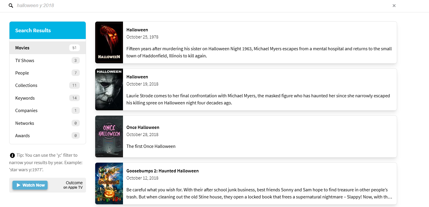

Happy2Play 9840 Posted April 22 Posted April 22 (edited) @LukeI have not tested this but it would appear the 2018 query does not get the 2018 version as it is second in the list. But not sure if I missed something as the queries get mixed up in log but don't see version 424139 in the log at all. And uses the 1978 imdbid on TVDB. Halloween 2018 Quote 2026-04-21 16:31:04.467 Info TheMovieDb: MovieDbProvider: Finding id for item: Halloween 2026-04-21 16:31:04.467 Info HttpClient: GET https://api.themoviedb.org/3/search/movie?api_key=x_secret4_x&query=Halloween&language=en-US&year=2018 2026-04-21 16:31:04.658 Info HttpClient: Http response 200 from https://api.themoviedb.org/3/search/movie?api_key=x_secret4_x&query=Halloween&language=en-US&year=2018 after 191ms 2026-04-21 16:31:04.660 Info HttpClient: GET https://api4.thetvdb.com/v4/search?type=movie&q=tt0077651&remote_id=tt0077651 Here is the query from TMDB for 2018 version Spoiler { "page": 1, "results": [ { "adult": false, "backdrop_path": "/sHI9xlFRWCJ38AIIfOqnGjuEvXz.jpg", "genre_ids": [27, 53], "id": 948, "title": "Halloween", "original_language": "en", "original_title": "Halloween", "overview": "Fifteen years after murdering his sister on Halloween Night 1963, Michael Myers escapes from a mental hospital and returns to the small town of Haddonfield, Illinois to kill again.", "popularity": 13.621, "poster_path": "/wijlZ3HaYMvlDTPqJoTCWKFkCPU.jpg", "release_date": "1978-10-24", "softcore": false, "video": false, "vote_average": 7.556, "vote_count": 6131 }, { "adult": false, "backdrop_path": "/8VjIXC2x8SHwAO52rfFpejKL4wc.jpg", "genre_ids": [27, 53], "id": 424139, "title": "Halloween", "original_language": "en", "original_title": "Halloween", "overview": "Laurie Strode comes to her final confrontation with Michael Myers, the masked figure who has haunted her since she narrowly escaped his killing spree on Halloween night four decades ago.", "popularity": 6.4911, "poster_path": "/f7JAX5EGk4GgsEnus6OxyzwpFp7.jpg", "release_date": "2018-10-18", "softcore": false, "video": false, "vote_average": 6.564, "vote_count": 5031 }, { "adult": false, "backdrop_path": null, "genre_ids": [], "id": 1036062, "title": "Once Halloween", "original_language": "ko", "original_title": "Once Halloween", "overview": "The first Once Halloween", "popularity": 0.2132, "poster_path": "/tkSL4xQuFXNzDsmhuUcQfsIMTWr.jpg", "release_date": "2018-10-28", "softcore": false, "video": true, "vote_average": 0, "vote_count": 0 }, { "adult": false, "backdrop_path": "/h5BvesqaxL7V3vl1CmaR8waGyiM.jpg", "genre_ids": [35, 14, 27, 10751], "id": 442062, "title": "Goosebumps 2: Haunted Halloween", "original_language": "en", "original_title": "Goosebumps 2: Haunted Halloween", "overview": "Be careful what you wish for. With their after school junk business, best friends Sonny and Sam hope to find treasure in other people’s trash. But when cleaning out the old Stine house, they open a locked book that frees a supernatural nightmare – Slappy! Now, with the help of Sonny’s sister Sarah, they’re in a race against time to get the sinister dummy and all the creatures he’s brought to life back into the pages before he unleashes total pandemonium!", "popularity": 7.032, "poster_path": "/t2wy38iiMpB8WsgJi3lYeDnGh2H.jpg", "release_date": "2018-10-11", "softcore": false, "video": false, "vote_average": 6.097, "vote_count": 1616 }, { "adult": false, "backdrop_path": "/pbFNn8idgbfCgn3VHQgTjgDkTfU.jpg", "genre_ids": [35, 27], "id": 641321, "title": "Halloween Horror", "original_language": "en", "original_title": "Halloween Horror", "overview": "An unidentified killer sets loose on Halloween to terrorize the inhabitants of a home in Texas.", "popularity": 0.0823, "poster_path": "/shWoHiWuuHKJdKTjOPMhQRrpckx.jpg", "release_date": "2018-10-31", "softcore": false, "video": false, "vote_average": 7, "vote_count": 2 }, { "adult": false, "backdrop_path": null, "genre_ids": [16, 10402], "id": 1550646, "title": "Starmyu in Halloween", "original_language": "ja", "original_title": "スタミュinハロウィン", "overview": "Halloween has arrived at Ayanagi Academy, bringing copious amounts of pumpkins, decorations, and delicious seasonal foods with it. Yuuta Hoshitani and his classmates enjoy preparing for the festivities until Kouki Nanjou tells a creepy ghost story, putting all of them on edge. As night draws closer, the lights in their dormitory go out and ghosts begin to appear, making the group believe that Nanjou's eerie tale is actually rooted in truth! While Hoshitani and a few others cower in fear, the rest of them investigate the supernatural occurrence to find the truth behind what is really going on.", "popularity": 0.1714, "poster_path": "/bqSs0igEKCjFVfgzXqOFBQ3I8Zv.jpg", "release_date": "2018-10-24", "softcore": false, "video": false, "vote_average": 0, "vote_count": 0 }, { "adult": false, "backdrop_path": "/t02GQ6bY28Eyk4My7oq3suhzMVE.jpg", "genre_ids": [10751, 27, 35], "id": 512584, "title": "Trico Tri Happy Halloween", "original_language": "en", "original_title": "Trico Tri Happy Halloween", "overview": "A family moves back to Miami to take care of its widowed abuela. After moving into a haunted house, the family learns the intentions of the ghosts that inhabit it.", "popularity": 0.453, "poster_path": "/hJBcj7Gx2BCNWbPj7HlfrsLYgmD.jpg", "release_date": "2018-09-28", "softcore": false, "video": false, "vote_average": 4.9, "vote_count": 22 }, { "adult": false, "backdrop_path": null, "genre_ids": [27], "id": 1316530, "title": "EAR PIERCING FOR HALLOWEEN", "original_language": "de", "original_title": "EAR PIERCING FOR HALLOWEEN", "overview": "Short horror film directed by Wilhelm Müller.", "popularity": 0.7397, "poster_path": "/8RJZgzTPHq1mb01DlO6Nes7KYbZ.jpg", "release_date": "2018-10-31", "softcore": false, "video": false, "vote_average": 0, "vote_count": 0 }, { "adult": false, "backdrop_path": null, "genre_ids": [27], "id": 1407049, "title": "Halloween Babes", "original_language": "es", "original_title": "Halloween Babes", "overview": "Horror film directed by Kev V.", "popularity": 0.0357, "poster_path": null, "release_date": "2018-10-01", "softcore": false, "video": false, "vote_average": 0, "vote_count": 0 }, { "adult": false, "backdrop_path": "/6AO9qHG10QwxCP5vFVp0VAWsGT4.jpg", "genre_ids": [28, 35, 14, 27], "id": 1292267, "title": "House Hardy Halloween", "original_language": "en", "original_title": "House Hardy Halloween", "overview": "A Halloween celebration at the Hardy family compound featuring their wrestling friends the Hurricane, the Boogeyman, the Godfather, and Papa Shango.", "popularity": 0.2431, "poster_path": "/dEAlJRxq09Q8e6jQOishBHocTMY.jpg", "release_date": "2018-10-28", "softcore": false, "video": false, "vote_average": 0, "vote_count": 0 }, { "adult": false, "backdrop_path": null, "genre_ids": [], "id": 572741, "title": "Halloween Girls", "original_language": "en", "original_title": "Halloween Girls", "overview": "A young London horror fan is making a Halloween pilgrimage to Los Angeles to visit a famous location from a 1970s classic. She discovers the past never dies…and it's armed with a knife! Shot in Pasadena, this quirky short shows it's never safe to tread in the footsteps of horror heroines.", "popularity": 0.0214, "poster_path": "/9EvmTf6wTCRiYf5vhjBfvIvK4cO.jpg", "release_date": "2018-06-01", "softcore": false, "video": false, "vote_average": 0, "vote_count": 0 }, { "adult": false, "backdrop_path": null, "genre_ids": [27], "id": 1040095, "title": "Halloween Party", "original_language": "en", "original_title": "Halloween Party", "overview": "October 31, 1995 - Local hero and fire fighter Ben Davister is hosting his annual Halloween Party when a woman covered in blood shows up on his doorstep. Will it be a trick or treat?", "popularity": 0.0071, "poster_path": "/xn5yI3dMzsv9vi9hWPtwnonIgJC.jpg", "release_date": "2018-10-30", "softcore": false, "video": false, "vote_average": 0, "vote_count": 0 }, { "adult": false, "backdrop_path": "/lL3j45DKlbPlsZ2rbuZ6TJMKEtI.jpg", "genre_ids": [10751, 10402, 14], "id": 1434917, "title": "ZOMBIES Halloween Cast Party", "original_language": "en", "original_title": "ZOMBIES Halloween Cast Party", "overview": "Stars from Disney's hit Disney Original Movie \"ZOMBIES\" - Meg Donnelly, Milo Manheim, Kylee Russell, Carla Jeffery and Kingston Foster - host the most spook-tacular party!", "popularity": 0.1685, "poster_path": "/bifIIOOY9Ckr0tbIAFPiiMB5qaa.jpg", "release_date": "2018-10-05", "softcore": false, "video": false, "vote_average": 5, "vote_count": 1 }, { "adult": false, "backdrop_path": null, "genre_ids": [35], "id": 546943, "title": "A Meowy Halloween", "original_language": "en", "original_title": "A Meowy Halloween", "overview": "The sequel to \"A Meowy Christmas\" pits Ms. Whiskers and Chuck against supernatural evil! Or something like that.", "popularity": 0.1647, "poster_path": "/cx3GRylPEs3cQ8OqXufi6Noi89a.jpg", "release_date": "2018-09-07", "softcore": false, "video": false, "vote_average": 9, "vote_count": 1 }, { "adult": false, "backdrop_path": "/bfTYiZ2OqOFSLxEtAYAlGdYhMJj.jpg", "genre_ids": [27, 53], "id": 567920, "title": "Halloween Horror Tales", "original_language": "en", "original_title": "Halloween Horror Tales", "overview": "A movie featuring four stories. First is about a psychotic killer clown stalking a young woman. In the second a scream queen gets more than she bargained for when she is interviewed by a TV talk show hostess. The third is a nature run amok tale and the fourth tells the story of an FBI agent investigating a series of brutal murders in a small town.", "popularity": 0.2665, "poster_path": "/EwUCvMKVC4CDfL8n7WeIMDlIYE.jpg", "release_date": "2018-11-29", "softcore": false, "video": false, "vote_average": 3.7, "vote_count": 8 }, { "adult": false, "backdrop_path": null, "genre_ids": [35, 27], "id": 1273533, "title": "Halloween in Hertford", "original_language": "en", "original_title": "Halloween in Hertford", "overview": "A man is hanged 100s of years ago in Hertford; and comes back seeking immortality in present day Hertford on Halloween. He is assisted by a vampire. Only Jean-Pierre van Slam - Monster Killer can save the day?", "popularity": 0.0261, "poster_path": null, "release_date": "2018-09-24", "softcore": false, "video": false, "vote_average": 0, "vote_count": 0 }, { "adult": false, "backdrop_path": "/9VDDze0N7BQ7xVuVkFUhMdZeuq5.jpg", "genre_ids": [27, 35], "id": 1424007, "title": "KNEGG (HALLOWEEN SPESIAL)", "original_language": "nb", "original_title": "KNEGG (HALLOWEEN SPESIAL)", "overview": "", "popularity": 0.0536, "poster_path": "/d8AV85EArF36nlBRF5qvpPCvbo5.jpg", "release_date": "2018-10-31", "softcore": false, "video": false, "vote_average": 0, "vote_count": 0 }, { "adult": false, "backdrop_path": null, "genre_ids": [27, 35], "id": 563635, "title": "Halloween Mind Massacre", "original_language": "en", "original_title": "Halloween Mind Massacre", "overview": "Meet Carl, he's a little out of his mind. His Doctor has been giving him experimental medication, and the side effects are out of control. And it happens to be Halloween.", "popularity": 0.0286, "poster_path": "/esoCaqtY6zNR07aNRuCzr9Vm4D4.jpg", "release_date": "2018-10-01", "softcore": false, "video": false, "vote_average": 0, "vote_count": 0 }, { "adult": false, "backdrop_path": "/cvARJtqipTpbE36I9BAQkuhdQYO.jpg", "genre_ids": [99, 10751], "id": 1400676, "title": "Behind the scenes of Halloween 2018 at Disney", "original_language": "fr", "original_title": "Les coulisses d'Halloween 2018 chez Disney", "overview": "A highly anticipated annual event for all thrill-seekers, the Halloween season has become one of the major and unmissable periods on the Disneyland Paris calendar. Discover the dancers, choreographers, vendors, technicians, and cooks who work tirelessly, both behind the scenes and in the spotlight, to make this season a resounding success.", "popularity": 0.0552, "poster_path": "/6GN0q5kDTlBe4OE7ftuCvlLlrbM.jpg", "release_date": "2018-10-28", "softcore": false, "video": false, "vote_average": 0, "vote_count": 0 }, { "adult": false, "backdrop_path": null, "genre_ids": [], "id": 1042475, "title": "Halloween Horror at Midnight", "original_language": "en", "original_title": "Halloween Horror at Midnight", "overview": "Anthology film comprising two episodes: one on Lady Dracula, the other on aliens hunting for secrets of Earth sexuality.", "popularity": 0.2406, "poster_path": null, "release_date": "2018-01-01", "softcore": false, "video": true, "vote_average": 0, "vote_count": 0 } ], "total_pages": 3, "total_results": 49 } Edited April 22 by Happy2Play

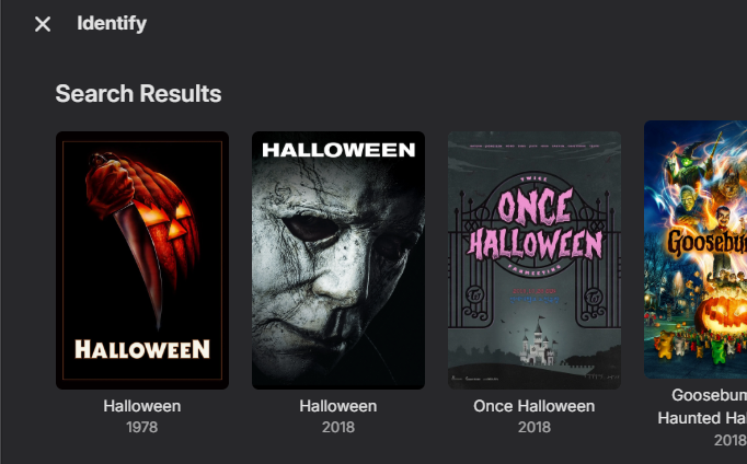

Happy2Play 9840 Posted April 22 Posted April 22 (edited) Using Halloween 2018 in Identify Tested movie, Emby is not matching year for second item in query list same as above. 2026-04-21 23:22:34.041 Info TheMovieDb: MovieDbProvider: Finding id for item: Halloween 2026-04-21 23:22:34.041 Info HttpClient: GET https://api.themoviedb.org/3/search/movie?api_key=key&query=Halloween&language=en-US&year=2018 2026-04-21 23:22:34.329 Info HttpClient: Http response 200 from https://api.themoviedb.org/3/search/movie?api_key=key&query=Halloween&language=en-US&year=2018 after 288ms 2026-04-21 23:22:34.335 Info HttpClient: GET https://api.themoviedb.org/3/movie/948?api_key=key&append_to_response=alternative_titles,reviews,casts,releases,images,keywords,trailers&language=en-US&include_image_language=en-US,null Edited April 22 by Happy2Play
Happy2Play 9840 Posted April 22 Posted April 22 In the end it is a defect of TMDB other country Release dates as the 1978 version has a lot of them 1
Happy2Play 9840 Posted April 22 Posted April 22 (edited) So ones options are limited in this scenerio to splitting apart and manually identifying or adding providerid to naming scheme. Existing topic as primary_release_year query would make a difference here. query=Halloween&language=en-US&primary_release_year=2018 Edited April 22 by Happy2Play
