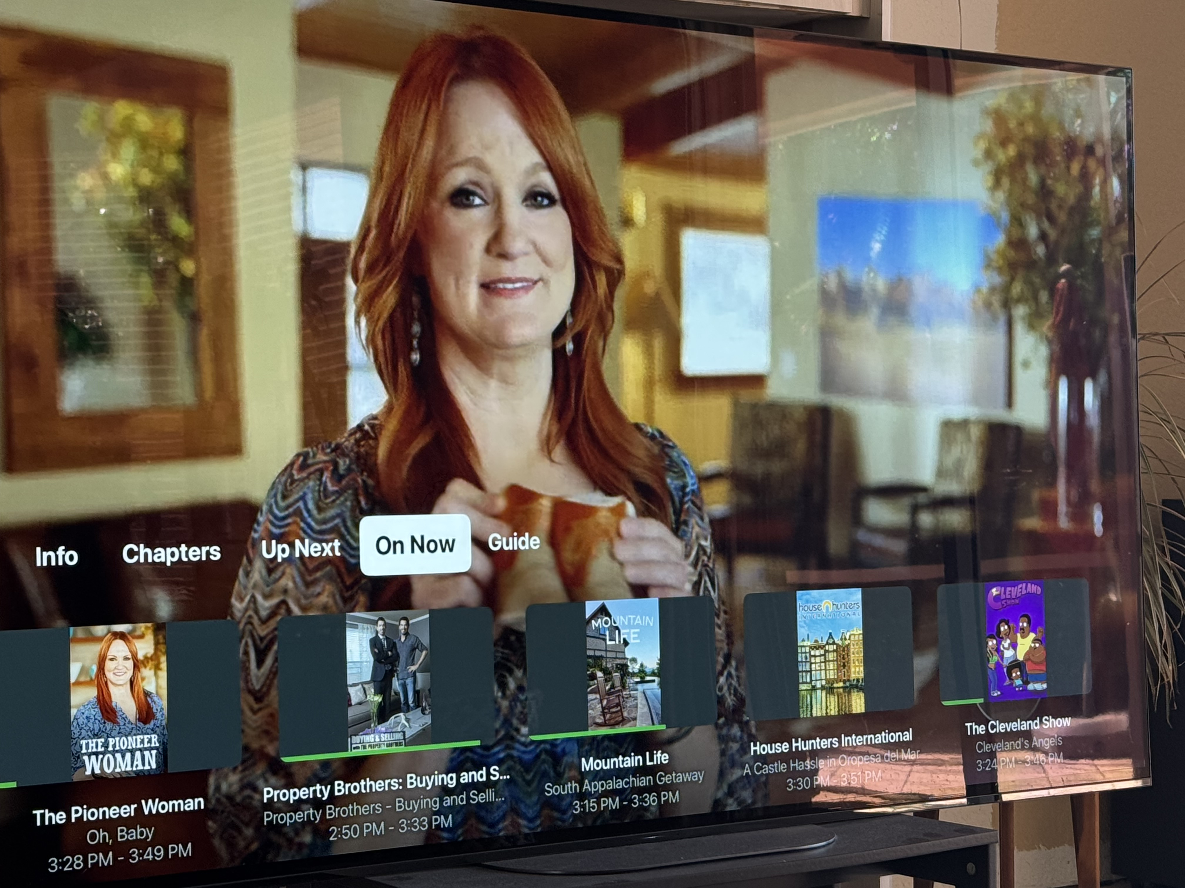

hstamas 181 Posted April 18 Posted April 18 (edited) Getting back into Apple TV/Emby combo and notice that the Live TV “On Now” section is showing show posters instead of landscape images like the placeholder seems to indicate it should be? Note that I am using the VirtualTV plugin as my TV source. Anyway to fix this? Note that the menu item to the left, “Up Next” is correct having landscape thumbnails. *wasn’t sure where to put this question? Here, Live TV or Plugin topic areas? Edited April 18 by hstamas 1

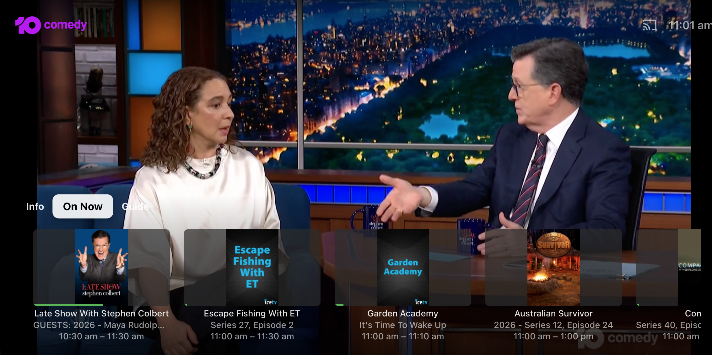

SamES 1143 Posted April 19 Posted April 19 Can you please try this on the web app? I think the same thing occurs there as well
alex77777 54 Posted April 19 Posted April 19 @SamESThe web app doesn't display it the same way from my testing

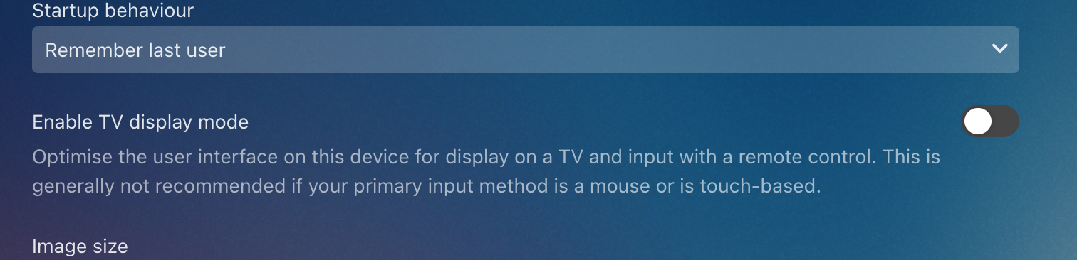

SamES 1143 Posted April 19 Posted April 19 1 hour ago, alex77777 said: The web app doesn't display it the same way from my testing Try it in TV mode, or using https://tv.emby.media Enable this setting
hstamas 181 Posted April 19 Author Posted April 19 12 hours ago, SamES said: Can you please try this on the web app? I think the same thing occurs there as well Web app using the TV setting looks incorrect as well @SamES. Viewed as the regular web interface, it looks correct.
SamES 1143 Posted April 19 Posted April 19 Yes, I can see that the logic is to use the 16:9 format for TV mode. I'm not sure why

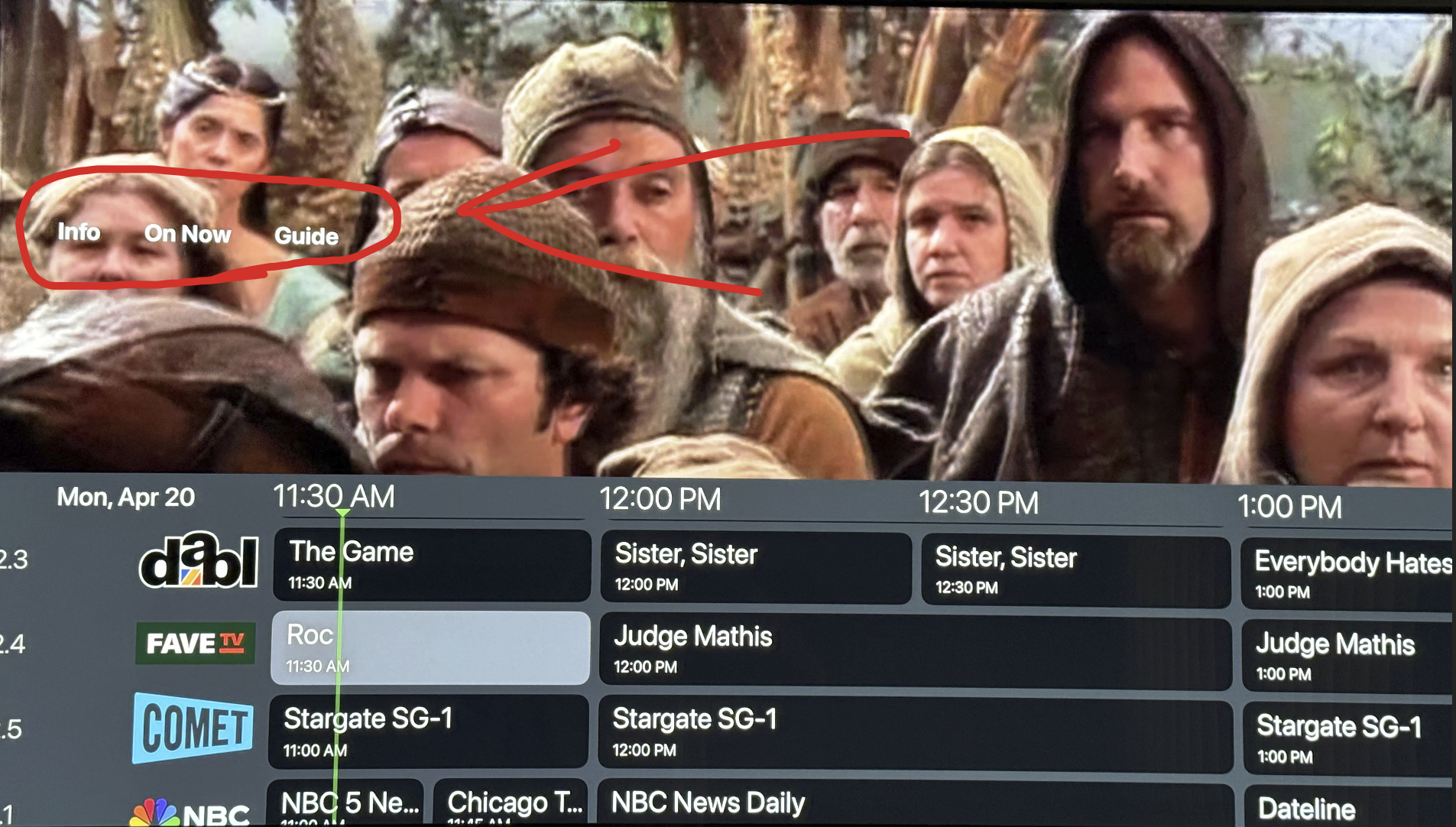

alex77777 54 Posted April 20 Posted April 20 I also wanted to point out that the Live TV Guide is slightly messed up when you access it while watching a program, when you scroll to it while watching it drops the guide down to the lower half of the screen while the UI elements get raised way above the guide. This started when I updated the Emby App to 2.0.5 on the Apple TV. Here is a picture that demonstrates the issue. 1
Luke 43542 Posted April 24 Posted April 24 On 4/20/2026 at 12:45 PM, alex77777 said: I also wanted to point out that the Live TV Guide is slightly messed up when you access it while watching a program, when you scroll to it while watching it drops the guide down to the lower half of the screen while the UI elements get raised way above the guide. This started when I updated the Emby App to 2.0.5 on the Apple TV. Here is a picture that demonstrates the issue. Hi, we'll take a look at that. Thanks. 1
