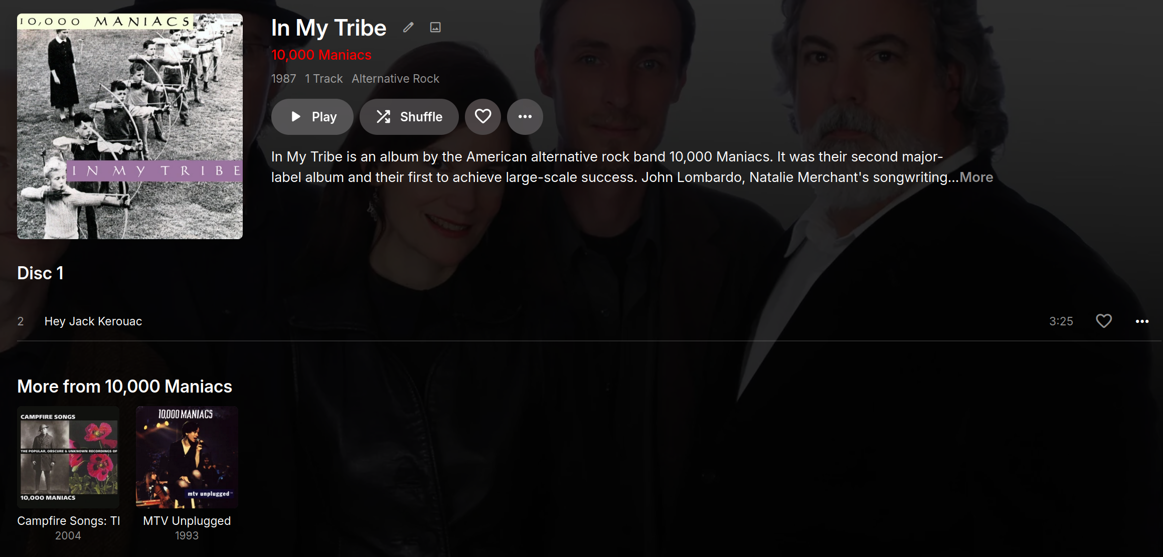

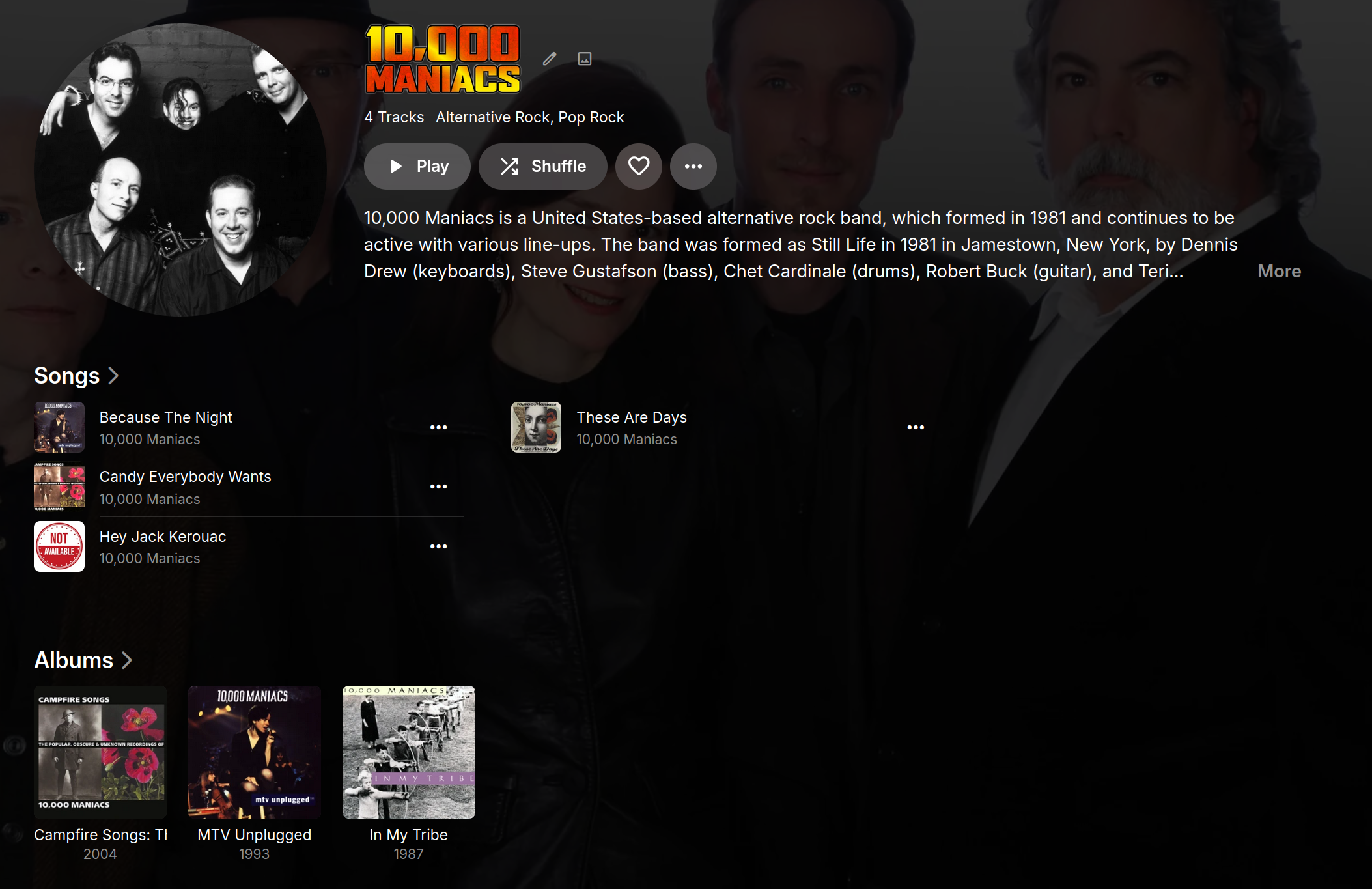

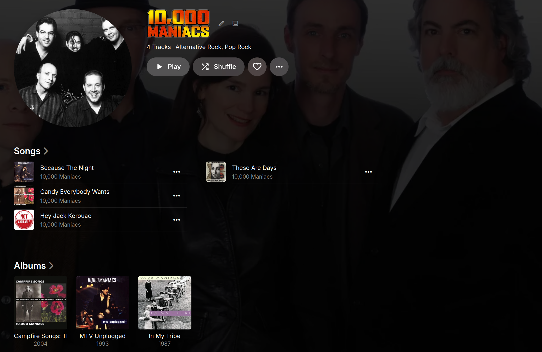

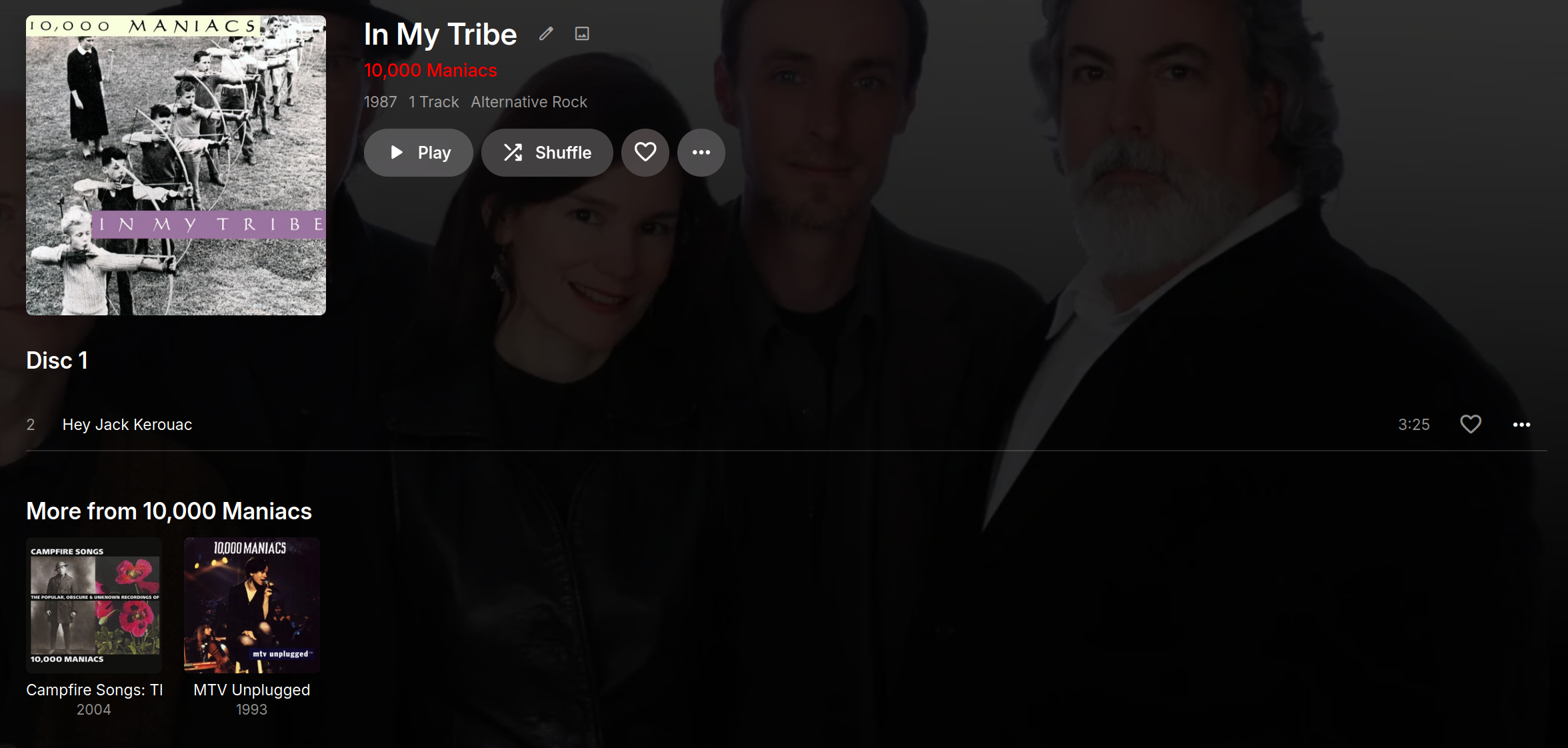

HouseOfCards 121 Posted April 18 Posted April 18 Good day, I'm not sure exactly when this began. I have two servers reading the same music locations on my NAS. Both servers have been set to read .NFO data and write .NFO files. One server is set to refresh metadata periodically, and I noticed that server has no descriptions in "artist.nfo" or "album.nfo", so no overview of the artists or albums. I attached screenshots of the same screens from the different servers. So as it stands, the server set to periodically refresh has no information for ALL of the music, since it seemed to get removed. The one that does not refresh will remove the data if I manually refresh. It rewrites the .NFO but no description info is included. I've also noticed that even though both are set to read/write .NFO's, the information is not in them. In other words, the server showing the descriptions is not getting the information from the .NFO's, as they don't have the descriptions in them. Must be stored locally in the database. If I manually edit the description, the information saves to the .NFO, so it's not permissions. So a metadata refresh wipes all artist and album information, and rewrites the .NFO without that information. No refresh will re-add the data, so deleting your information is a one-way destructive operation. It should be reading .NFO's, and if the data is missing, it should be rewriting with the updated information. None of this is happening. Here is the log after refreshing one artist. embyserver.txt

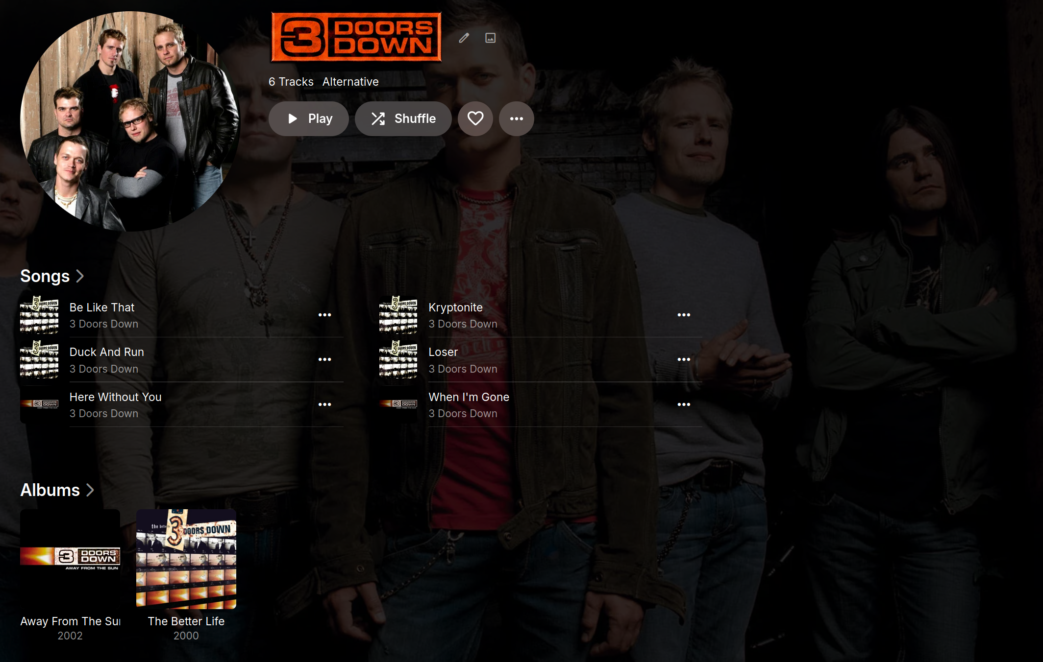

HouseOfCards 121 Posted April 19 Author Posted April 19 1 minute ago, Happy2Play said: Hard to say here as looks like your music has not refreshed yet and the last entry if for only one artist RefreshItem Complete: 254 MusicArtist 3 Doors Down But the plugin update is to only read existing nfo files that contain data. So we would need to look at a specific example to include the nfo file. I only refreshed the one artist as a test. Before the refresh, it had a description of the artist as expected. After the refresh...

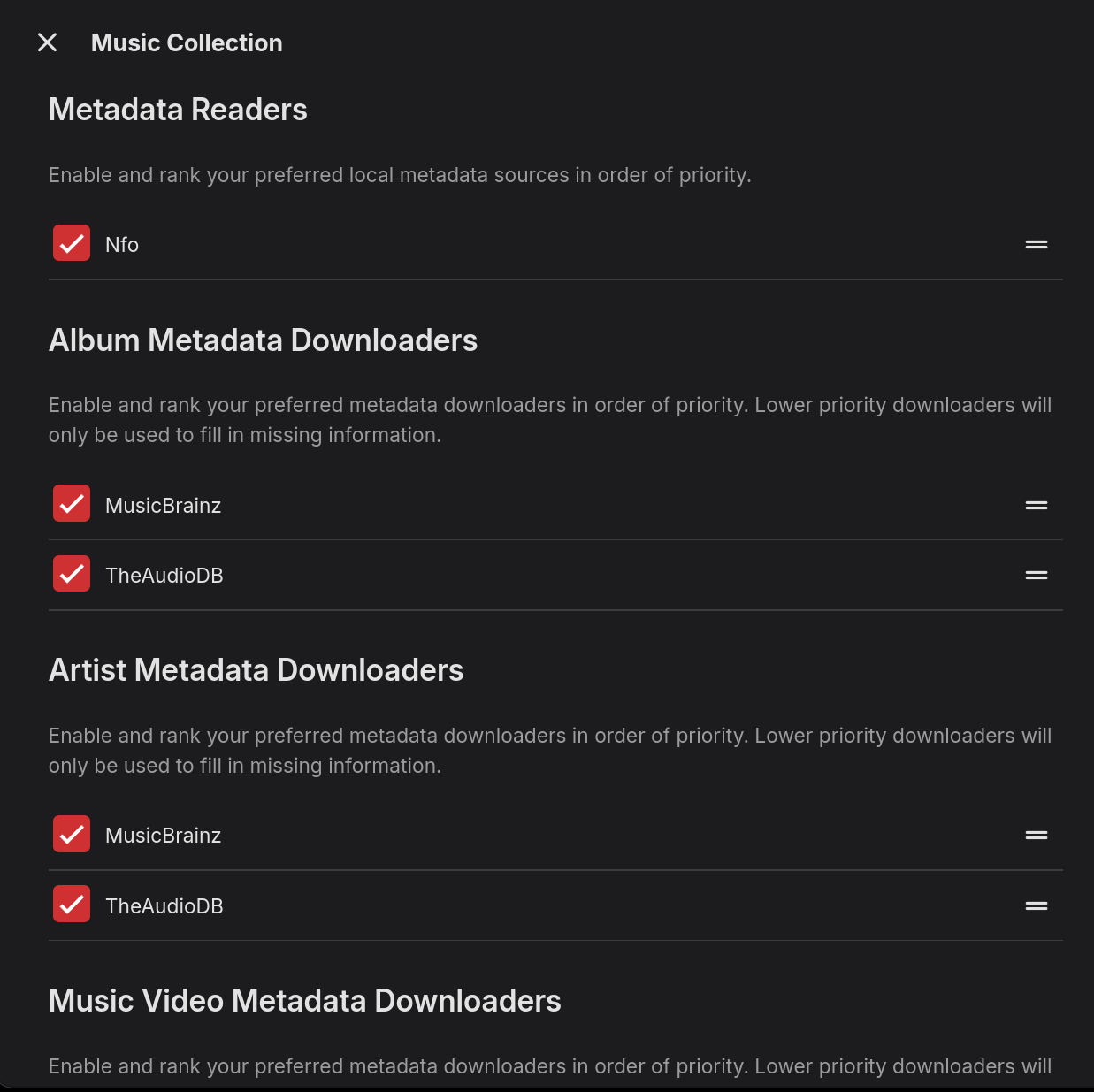

Luke 43549 Posted April 19 Posted April 19 What metadata fetchers have you enabled on each of your music libraries?
HouseOfCards 121 Posted April 19 Author Posted April 19 3 hours ago, Luke said: What metadata fetchers have you enabled on each of your music libraries? I've tried changing the order also. No difference. I don't remember how long ago, but I set this server to periodically refresh metadata. That's why this one doesn't have the information anymore. It used to be fine, but at some point the automatic refresh wiped it. And now when I refresh an artist or album on the server that still has the metadata, it wipes it on that one also. Both servers run from Docker containers on a NAS, and the files are stored right on the NAS and mapped in the Docker container configuration. Never had this issue before now, and only this library from what I see. TV and movies seem to work fine.

Solution Luke 43549 Posted April 20 Solution Posted April 20 OK the update to the audiodb plugin that just went up should help a little. But make sure to check what info they actually have in their database. The musicbrainz website doesn't count. Whatever descriptions they display are not included in their api. I think they're just pulling from somewhere like wikipedia but are not licensed to redistribute.
HouseOfCards 121 Posted April 24 Author Posted April 24 On 4/19/2026 at 10:58 PM, Luke said: OK the update to the audiodb plugin that just went up should help a little. But make sure to check what info they actually have in their database. The musicbrainz website doesn't count. Whatever descriptions they display are not included in their api. I think they're just pulling from somewhere like wikipedia but are not licensed to redistribute. My AudioDB plugin is v1.0.20.0. I changed all my music libraries to have the AudioDB first, and Musicbrainz second. Still no metadata populating at all.

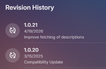

Happy2Play 9840 Posted April 24 Posted April 24 37 minutes ago, HouseOfCards said: My AudioDB plugin is v1.0.20.0. But the updated version is 1.0.21.0
HouseOfCards 121 Posted April 24 Author Posted April 24 33 minutes ago, Happy2Play said: But the updated version is 1.0.21.0 Yup. It installed earlier today, just saw it needed a restart. I refreshed one artist with the new AudioDB plugin and artist and album descriptions are populating as expected. So there was clearly something going on. I appreciate the info about MusicBrainz not being the best source for audio. Didn't know that. And the help, of course. I'll do a full refresh on the server missing the data, and post back if I have any more problems. Thanks again... 1
