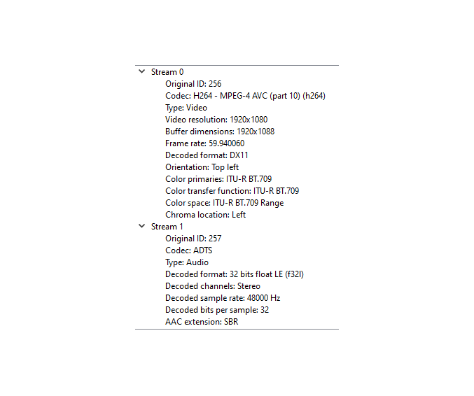

GaryG 12 Posted April 23 Author Posted April 23 (edited) Ive compared the streams in VLC, the only difference I can see between the stream that works in EMBY vs the one that doesnt, are color references. 3 Items in attachment, strating with "Color Primaries". The stream that does work in emby doesnt have these references. Maybe a red Herring? Edited April 23 by GaryG Spelling

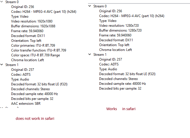

Chillout 142 Posted April 23 Posted April 23 (edited) My workaround is switching apps or I go to my backup provider. The codec on the left does not work in Safari but works in Chrome. The codec on the right works in Safari. Something similar was happening in the Roku app but they have fixed in the beta. Maybe whatever they did to fix it in Roku would work across different apps. @ebr edit: our "problem streams" have identical footprint. Possibly we use the same source content. Edited April 23 by Chillout 1
GaryG 12 Posted April 23 Author Posted April 23 (edited) 29 minutes ago, Chillout said: My workaround is switching apps or I go to my backup provider. The codec on the left does not work in Safari but works in Chrome. The codec on the right works in Safari. Something similar was happening in the Roku app but they have fixed in the beta. Maybe whatever they did to fix it in Roku would work across different apps. @ebr edit: our "problem streams" have identical footprint. Possibly we use the same source content. Interesting, The two codecs look identical except for those color references. Just like my screenshot, H264 - MPEG_4 AVC (part 10) (h264). Resolution issue maybe? A mystery. Edited April 23 by GaryG
