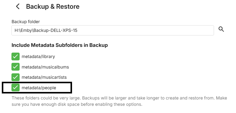

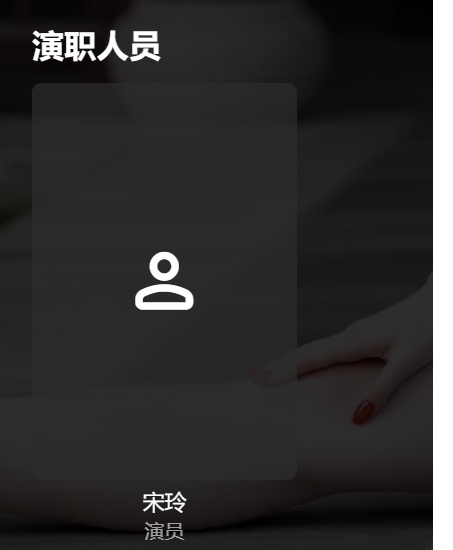

sa2000 860 Posted April 21 Posted April 21 6 hours ago, zlhyh said: I finished copying everything this morning, following your steps exactly. Everything you mentioned has been perfectly restored, but I've noticed one thing is missing for now: the actor images (the pictures I uploaded). Was it all actors ? It should have been backed up when selecting the 4th metadata backup option here The backed up actor images would be in this backup folder "embyserver-backup-full\metadata\people" could you check what images are within the folder structure below this
zlhyh 34 Posted April 21 Author Posted April 21 8 hours ago, sa2000 said: Was it all actors ? It should have been backed up when selecting the 4th metadata backup option here The backed up actor images would be in this backup folder "embyserver-backup-full\metadata\people" could you check what images are within the folder structure below this Everything is restored perfectly! This plugin is excellent; it can restore everything. The playlist might be due to the file. 2

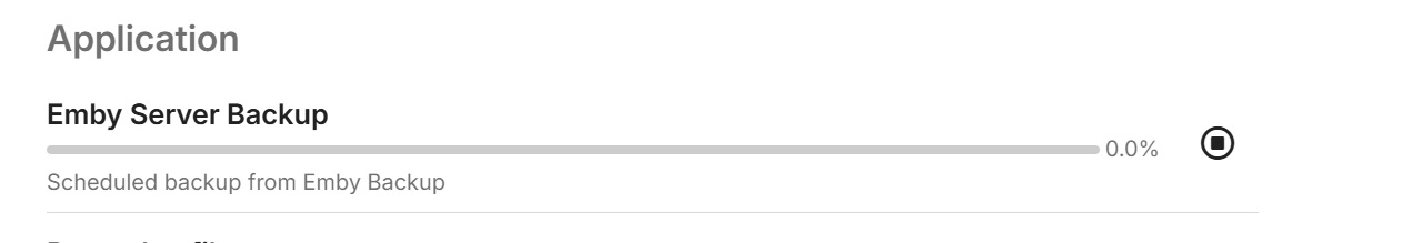

zlhyh 34 Posted April 24 Author Posted April 24 On 4/21/2026 at 3:17 PM, sa2000 said: Was it all actors ? It should have been backed up when selecting the 4th metadata backup option here The backed up actor images would be in this backup folder "embyserver-backup-full\metadata\people" could you check what images are within the folder structure below this I have finally completed the restoration of my media library today, and all data has returned to normal. However, I am encountering an issue. The backup function on my new NAS has been running for more than an hour and still hasn’t finished. It used to take only about 12 seconds to finish a backup. I don’t know what caused this abnormality.
zlhyh 34 Posted April 24 Author Posted April 24 It finally finished after 1 hour and 20 minutes. Probably because it's the first full backup.
Luke 43391 Posted April 24 Posted April 24 7 minutes ago, zlhyh said: It finally finished after 1 hour and 20 minutes. Probably because it's the first full backup. Hi, yes that is correct.
zlhyh 34 Posted April 24 Author Posted April 24 4 hours ago, Luke said: Hi, yes that is correct. The second run was super fast—just 15 seconds. 2
