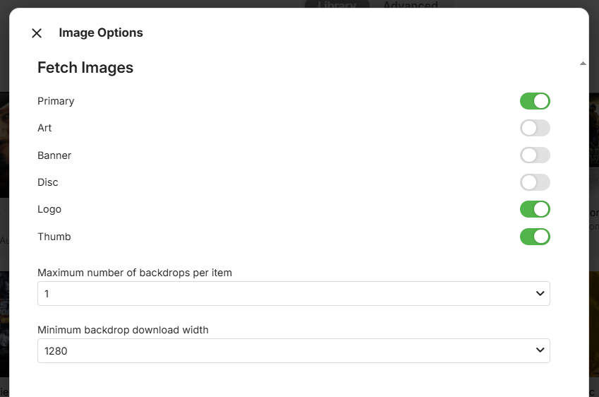

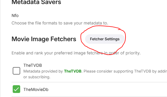

Luke 43720 Posted April 15 Posted April 15 what image types are enabled for download in fetcher settings?
MAX92 110 Posted April 16 Author Posted April 16 @LukeI don't understand your first question "what image types are enabled for download in fetcher settings?". No item is locked in the metadata.

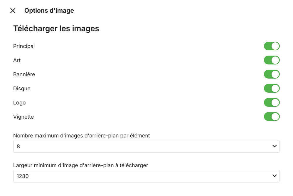

Solution MAX92 110 Posted April 24 Author Solution Posted April 24 EActually, the last checkbox was checked. When I unchecked it, it worked. @Luke: There might be a translation issue—what exactly does this button do?
