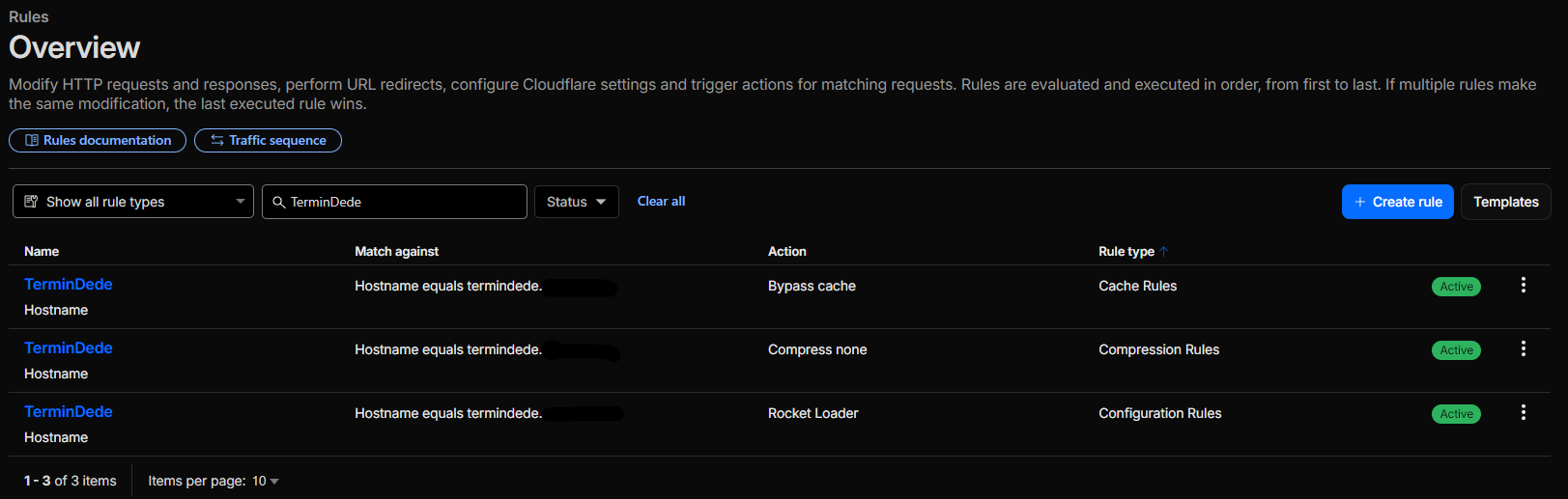

Termindiego25 6 Posted June 2 Author Posted June 2 Hi, I noticed there's a new server version and the Docker Hub repository has been archived, so I updated the repository and version to v4.9.5.0. I also checked Cloudflare again to see if there were any changes due to a platform update, but it seems to be the same as when it was working correctly: I tried again with my old LG TV using webOS v4.64.0 and the Emby v1.0.50 app, but the result is the same: "No compatible streams are currently available"
