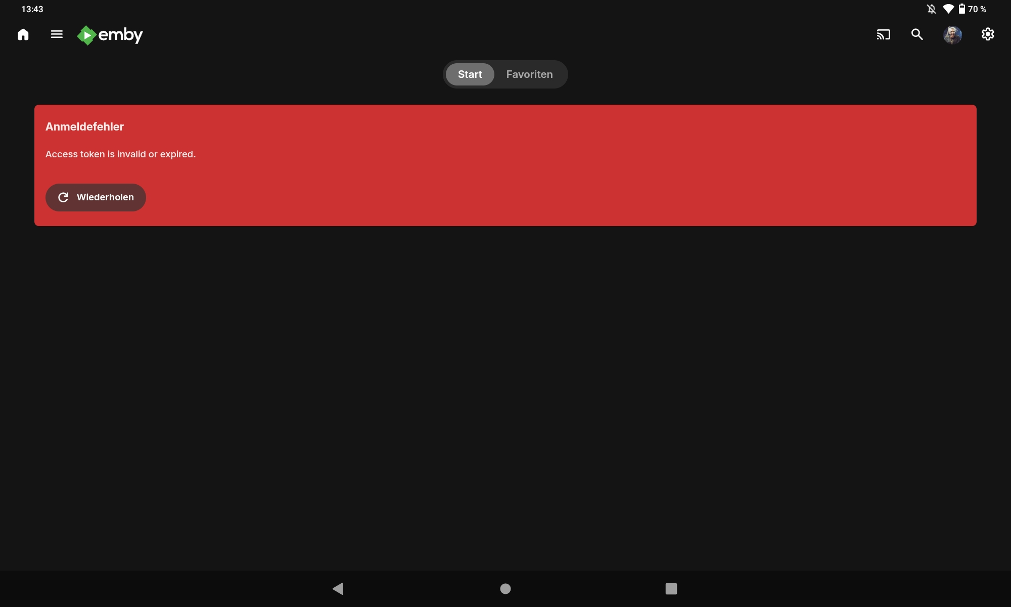

I'm trying to play an MP3 from my collection, which initially works, but when skipping to the next track, the connection to the server drops. This doesn't always result in a server crash. In any case, I then get the error message "Access token is invalid or expired" on the client. This is typical for remote connections. However, the client and server are on the same network.
This happens with both my Android and iPhone clients.
And as already mentioned, playback of images and videos is unaffected.
