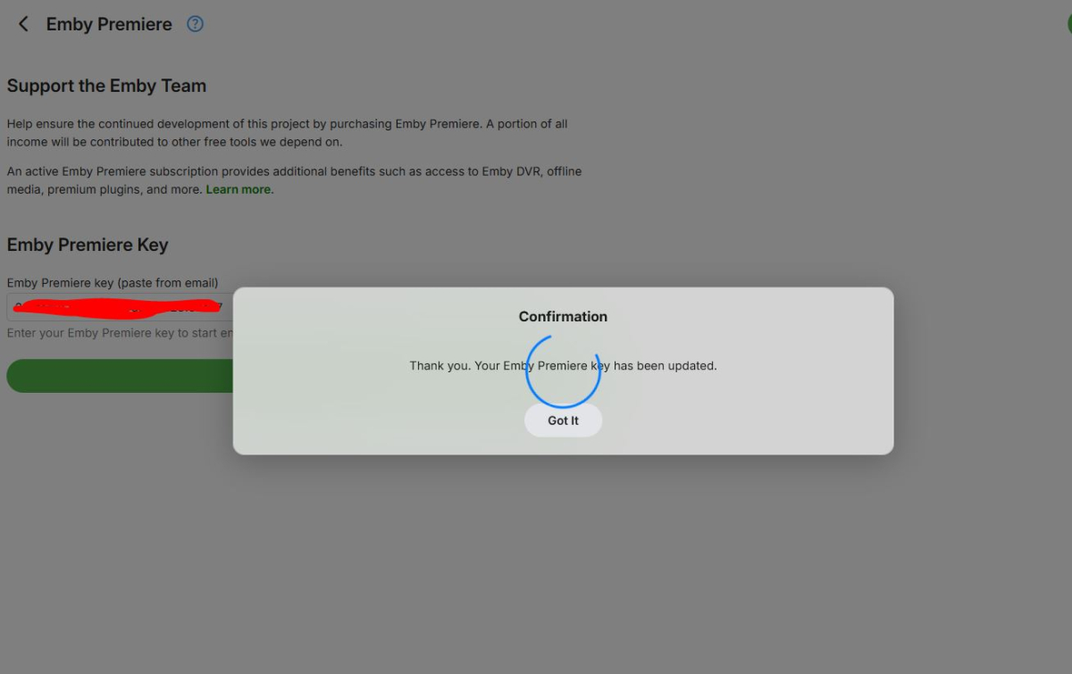

achalmers 3 Posted February 17 Author Posted February 17 @ebr one more weird seemingly related issue that only occurred after implementing the suggested fix... Let me know if I should open a new thread. Now my server still has the "Get Emby Premiere" at the top right, and when I go to the Emby Premier settings page and enter my license key it says it works, but doesnt seem like it. It says "Thank you, Your Emby Premiere Key has been updated" but I get a weird spinning circle that never goes away. Please see screen shot. I restarted Emby and same issue. Attaching Screen Shot and fresh logs embyserver.txt
ebr 16335 Posted February 17 Posted February 17 Something in your browser is blocking the browser device validation call. Look in the browser console and you will see the error.

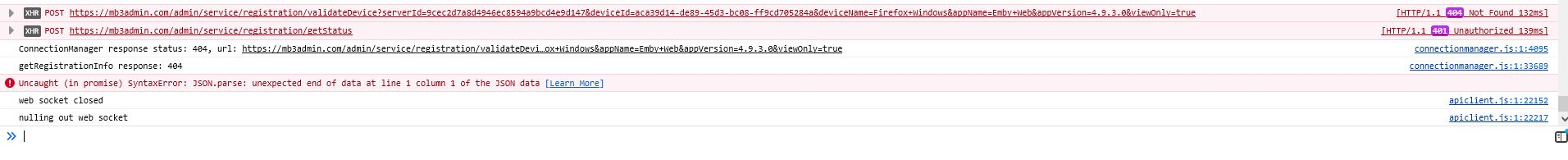

achalmers 3 Posted February 17 Author Posted February 17 12 minutes ago, ebr said: Something in your browser is blocking the browser device validation call. Look in the browser console and you will see the error. I figured it might be browser related but it's doing it in all browsers (even private) and all computers I try. Browser console shows the attached image
ebr 16335 Posted February 17 Posted February 17 Okay, that would actually indicate that your server is not validating properly but it could also be some sort of proxy interfering. The log you provided above does not contain a validation attempt. Please try the procedure here: My Emby Key Says it is Invalid or Missing
achalmers 3 Posted February 18 Author Posted February 18 39 minutes ago, ebr said: Okay, that would actually indicate that your server is not validating properly but it could also be some sort of proxy interfering. The log you provided above does not contain a validation attempt. Please try the procedure here: My Emby Key Says it is Invalid or Missing Wow I feel like a dumb-dumb now. Blanking out the key, saving, and then re-attempting resolved it. Thanks again! 1
