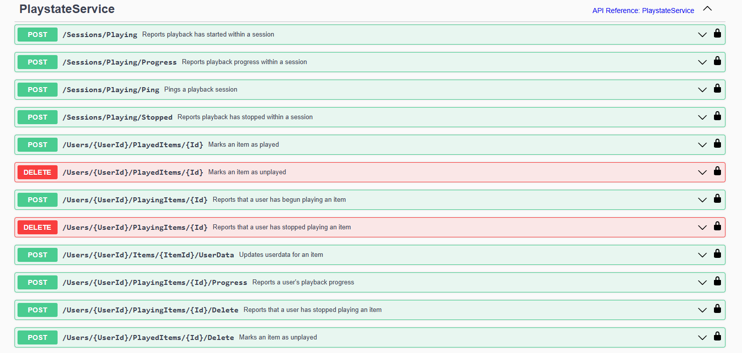

You can use the api and mark the whole library as played/unplayed per parentid shown in the url via the web client (along with your userid).  You can see a link to the api at the bottom your your Dashboard in the web client.
PlaystateService

When I open it up in Chrome, I found this below, but now sure what to do with it. My screen was basically all test, no listing as above.
"/Users/{UserId}/PlayedItems/{Id}/Delete": {
      "summary": "Marks an item as unplayed",
      "post": {
        "tags": [
          "PlaystateService"
        "description": "Requires authentication as user",
        "operationId": "postUsersByUseridPlayeditemsByIdDelete",
        "parameters": [
            "name": "UserId",
            "in": "path",
            "description": "User Id",
            "required": true,
            "style": "simple",
            "schema": {
              "type": "string"

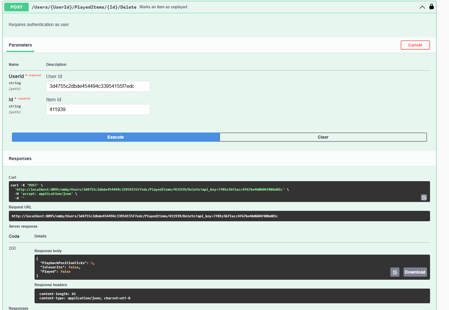

From the UI you just enter Userid and Parentid.
My example from my test system.  You can use Delete or Post.

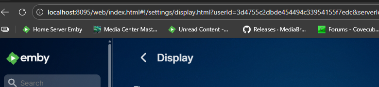

You can see your userid in your URL in user settings.

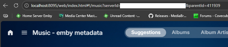

And library parentid within the library

It worked! Little tricky, which would be nice to have a simple reset button. But if the current version doesn't double count anymore, I should be good.
Mega thank you, that took some effort to get those screen captures!
