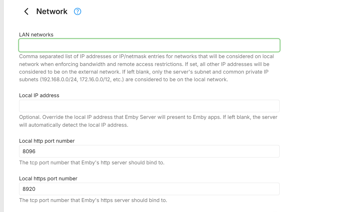

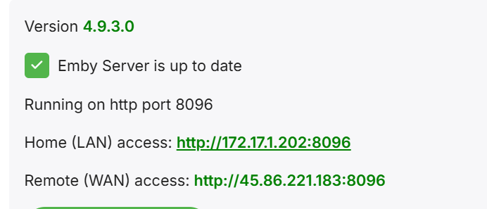

Luke 42243 Posted February 12 Posted February 12 What address does your server dashboard display for your LAN address? Is it correct?

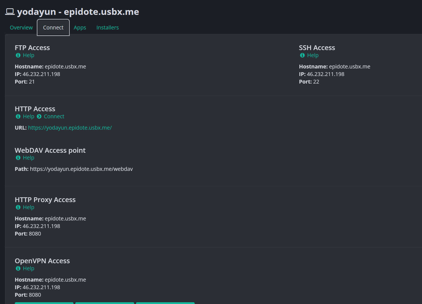

yodayun 1 Posted February 12 Author Posted February 12 This is the info from the remote server And this is the emby lan If it wasn't correct, should I be able to use the browser/desktop app normally through LAN? why only the wifi wouldn't work?
ebr 16335 Posted February 12 Posted February 12 It doesn't appear to be correct. 9 minutes ago, yodayun said: If it wasn't correct, should I be able to use the browser/desktop app normally through LAN? why only the wifi wouldn't work? That depends. For example, if you use the domain name in the browser or desktop app, then that is why it works.
yodayun 1 Posted February 12 Author Posted February 12 I guess so, so the IP changed for wifi/remote access and that screws it up, but the PC app uses the domain. But if it were the case, I could use the host/domain name to connect to it from the tv app, and it still isn't reachable through the host name. How do I change the IP it pings manually, if I can, and which one should I use from the screen above? The HTTPs one, right?
Luke 42243 Posted February 12 Posted February 12 3 hours ago, yodayun said: This is the info from the remote server And this is the emby lan If it wasn't correct, should I be able to use the browser/desktop app normally through LAN? why only the wifi wouldn't work? Is that lan address correct? 172 is not typical.
