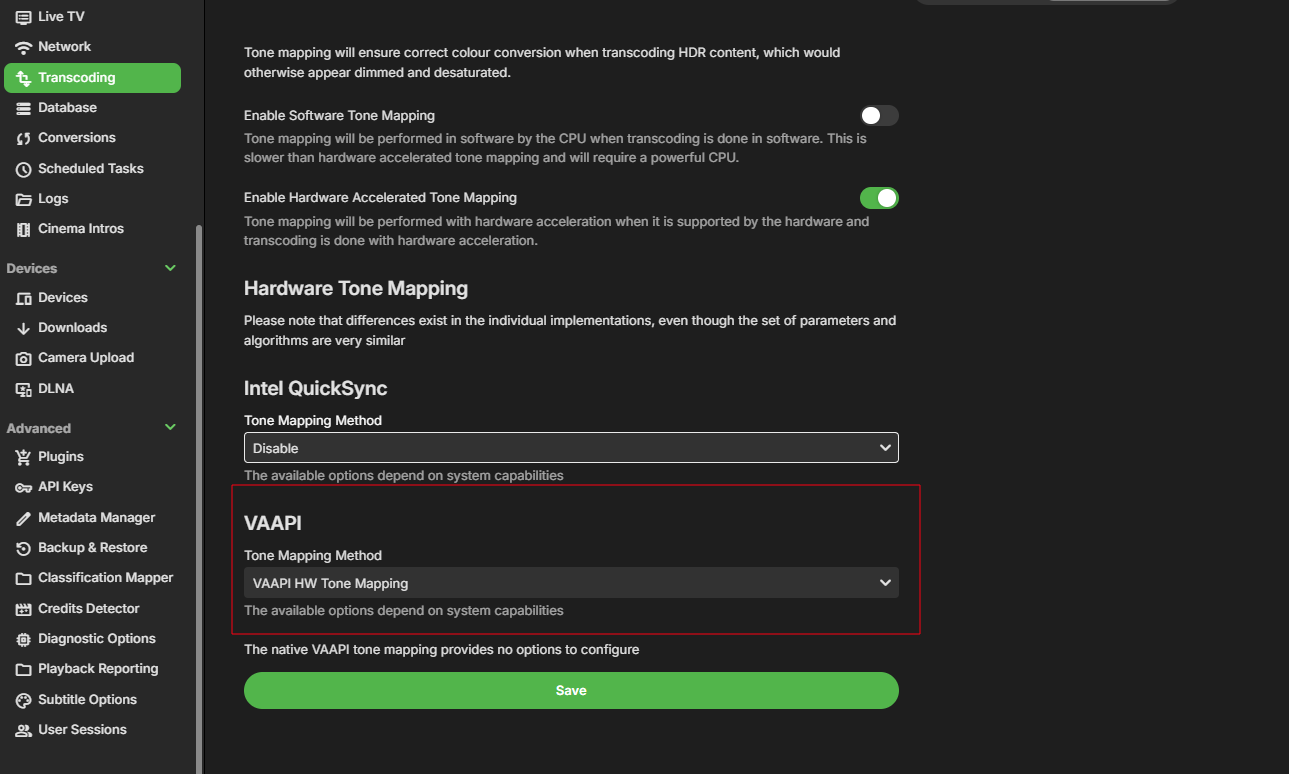

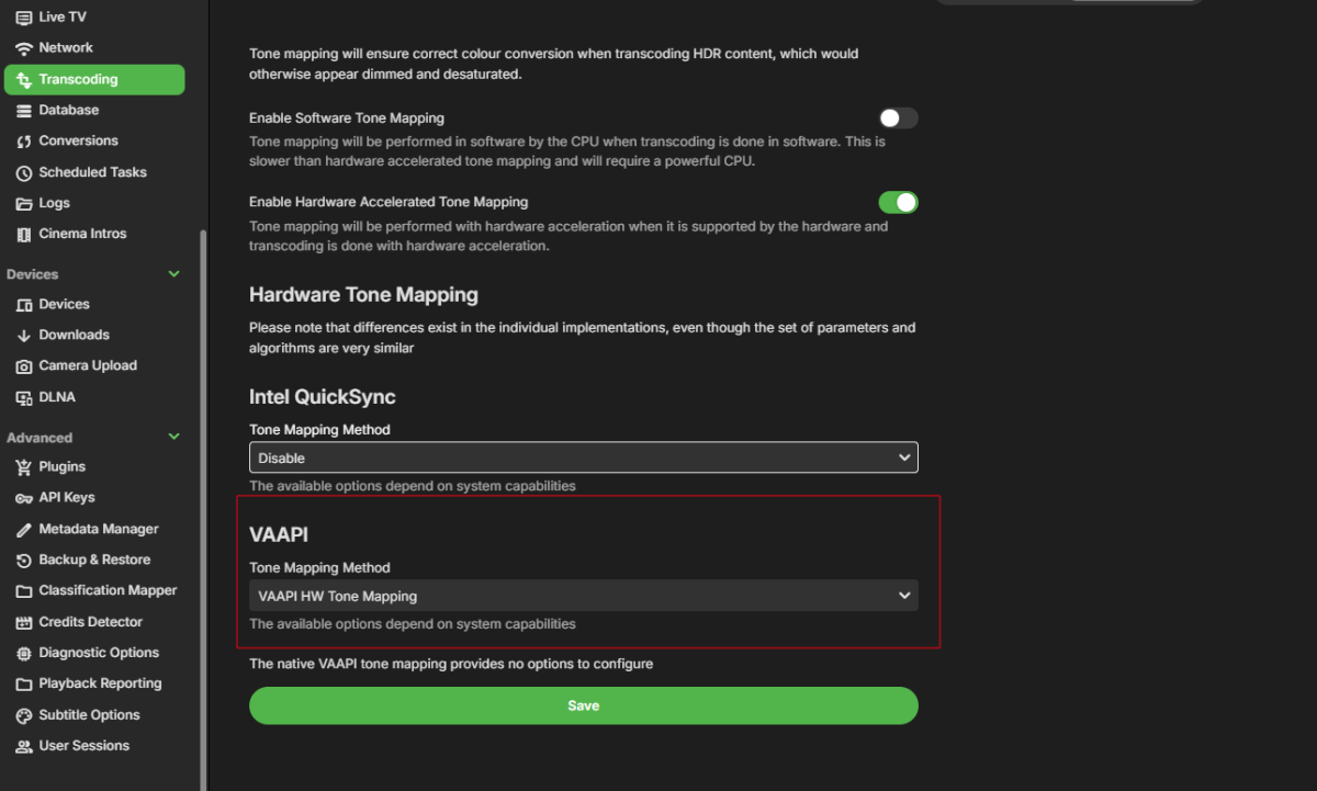

fireplex 12 Posted February 9 Posted February 9 New user here, just trying out Emby 4.9.3.0 via docker on unRAID. HW transcoding works fine when I have tone mapping disabled, I can see my Intel i7 7700 GPU doing the decoding and CPU usage is low. Problem is the video is took dark (as expected), so I enable tone mappnig but this results in Emby always falling back to software decoding, the errors seem to be: 13:47:58.952 Stream mapping: 13:47:58.952 Stream #0:0 (hevc_qsv) -> vpp_qsv:default (graph 0) 13:47:58.952 hwmap:default (graph 0) -> Stream #0:0 (h264_qsv) 13:47:58.952 Stream #0:1 -> #0:1 (dts (dca) -> ac3 (native)) 13:47:58.952 Press [q] to stop, [?] for help 13:47:59.090 [AVHWDeviceContext @ 0xd56700] Failed to get number of OpenCL platforms: -1001. 13:47:59.090 [hwmap@f3 @ 0xcee540] Failed to created derived device context: -19. 13:47:59.090 [hwmap@f3 @ 0xcee540] Failed to configure output pad on hwmap@f3 13:47:59.090 Error reinitializing filters! 13:47:59.090 Failed to inject frame into filter network: No such device 13:47:59.090 Error while processing the decoded data for stream #0:0 13:47:59.092 Conversion failed! 13:47:59.092 EXIT I see a few posts around OpenCL and -1001, is this a known bug? I've attached the transcode log (server log has references to my domain and maybe other private stuff so omitted that) ffmpeg-transcode-b140920c-c476-434c-b139-75c87857b724_1.txt
Neminem 1623 Posted February 9 Posted February 9 have you tried with VAAPI tone mapping. Not using OpenCL.

fireplex 12 Posted February 9 Author Posted February 9 1 hour ago, Neminem said: have you tried with VAAPI tone mapping. Not using OpenCL. Thanks, I think that helps. Colors maybe a bit weird just testing... 1

Neminem 1623 Posted February 9 Posted February 9 Yes Emby need's to improve. Its ether to dark "CPU" or to Color off "VAAPI" there are other options under VAAPI - OpenCL. If that works for you, try Mobius, still off but better. But the best solution would be to have a copy that does not need Tonemapping. 1
