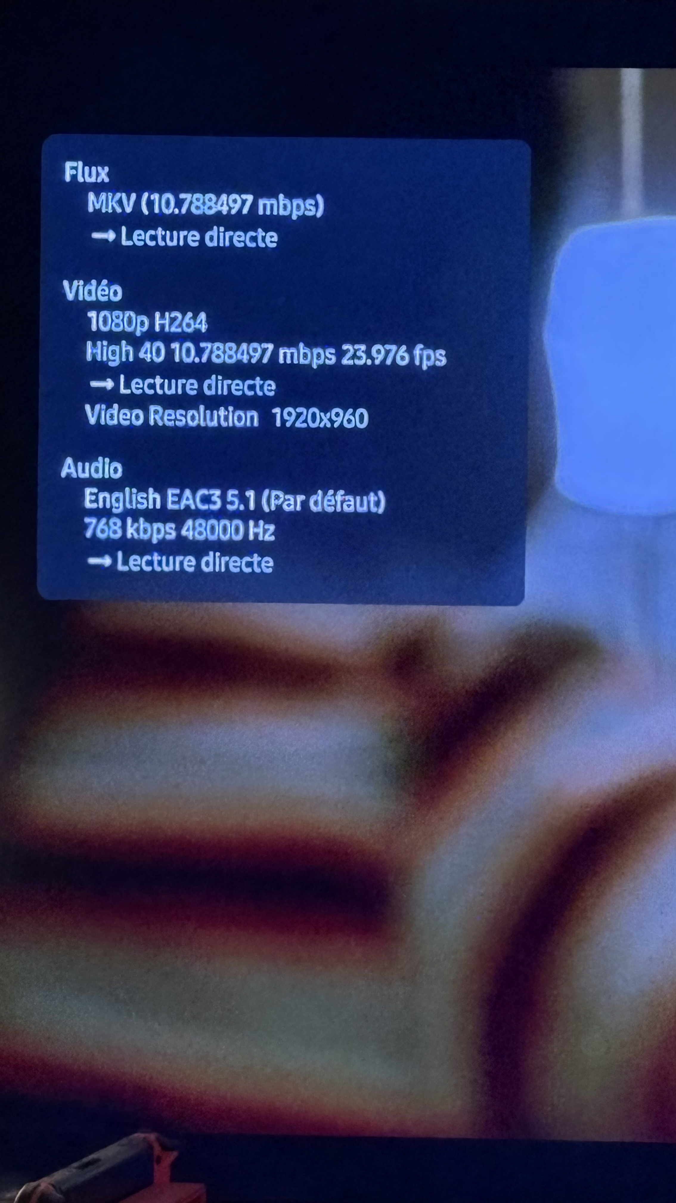

SamES 1084 Posted February 13 Posted February 13 I suspect that on the devices where you are hiving issues, it is using DirectPlay, and on the ones working correctly, it is possible Transcoding video, audio or both. You can confirm that in stats for nerds in the apps during playback or on the server dashboard during playback. If that is true, then the transcoding is probably dropping the bitrate which is helping playback. So are you using a wifi connection to the TV and AppleTV or a wired lan? If wifi, is it 2.4GHz band or 5GHz? Do you have any other network switches, etc, or just the router? I think your problem is network related
BenjaClacla 3 Posted February 14 Author Posted February 14 It appears indeed to be in direct play. Tv is on WiFi, I suppose it is using 5ghz as it has both options and the router is supposed to choose whichever is best. We do not have any switch, only the router.

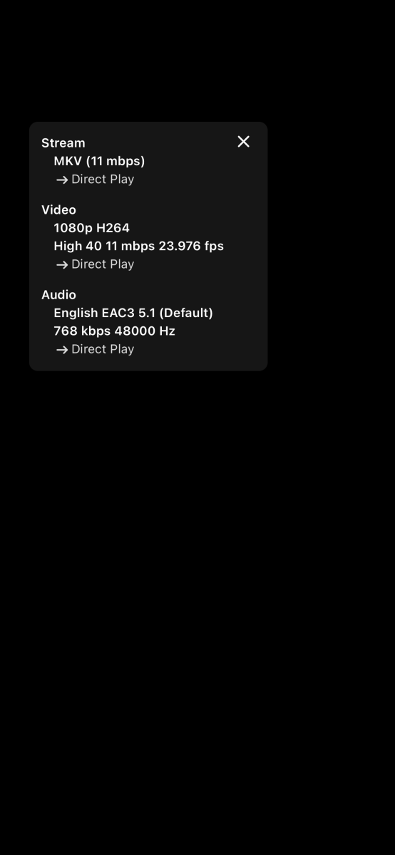

BenjaClacla 3 Posted February 14 Author Posted February 14 (edited) But it seems to be playing also in direct play on the iPhone app, though playback nitrate seems to be different. I am using the same WiFi than the TV is on. Edited February 14 by BenjaClacla
SamES 1084 Posted February 14 Posted February 14 I would double check and force it to 5GHz. I wouldn’t rely on the auto switching of bands as the 2.4 might be the stronger signal but it will be much slower than a 5GHz signal I normally set the SSID differently for 2.4 and 5 so that I can control which devices use which band. You want any devices playing media to avoid 2.4GHz
SamES 1084 Posted February 14 Posted February 14 3 minutes ago, BenjaClacla said: playback nitrate seems to be different. It’s just displaying it weirdly and not rounding to 11. I’ve not seen that occur before, is that the Samsung app? The phone will have much better buffering to cope with a slower/less stable network and because the phone is mobile, it’s probably getting a better signal. How far away from the router is the TV, and how many walls between them. Try forcing it to 5GHz, but I’m still certain your problem will be network
BenjaClacla 3 Posted February 14 Author Posted February 14 (edited) Yes, this the fort screenshot is from the Samsung tv app. The other one is from the iOS app on my iPhone. I’ll try the router thing tomorrow, thanks ! Tv is like 10 meters away from the router. No walls at all between them ! Edited February 14 by BenjaClacla 1
