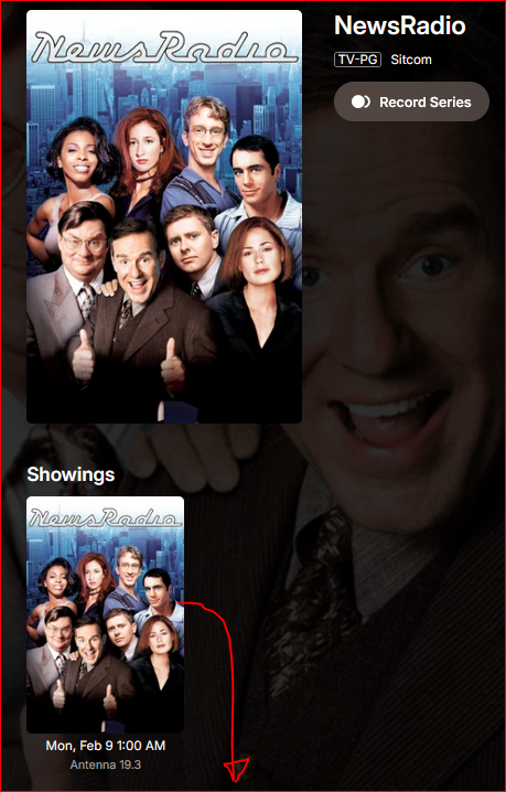

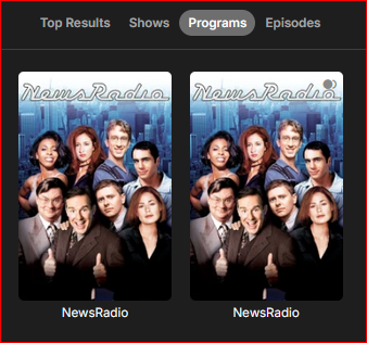

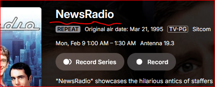

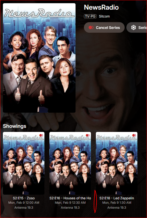

justinrh 266 Posted February 5 Posted February 5 Once I had 2 Cheers series (one without a date), and this might be another case. Two series for NewsRadio: But one is missing its identity What season and episode is this one? It's the missing episode in the other series:
Luke 42234 Posted February 5 Posted February 5 Hi, the guide data probably just doesn’t have that info. Sometimes it gets filled in as you get closer to the air date.
justinrh 266 Posted February 13 Author Posted February 13 Actually, I have it backwards. This is another case where I got a second series folder. Did you notice one has the year and one doesn't? And did you notice the missing episode? Another part 2 missed.
