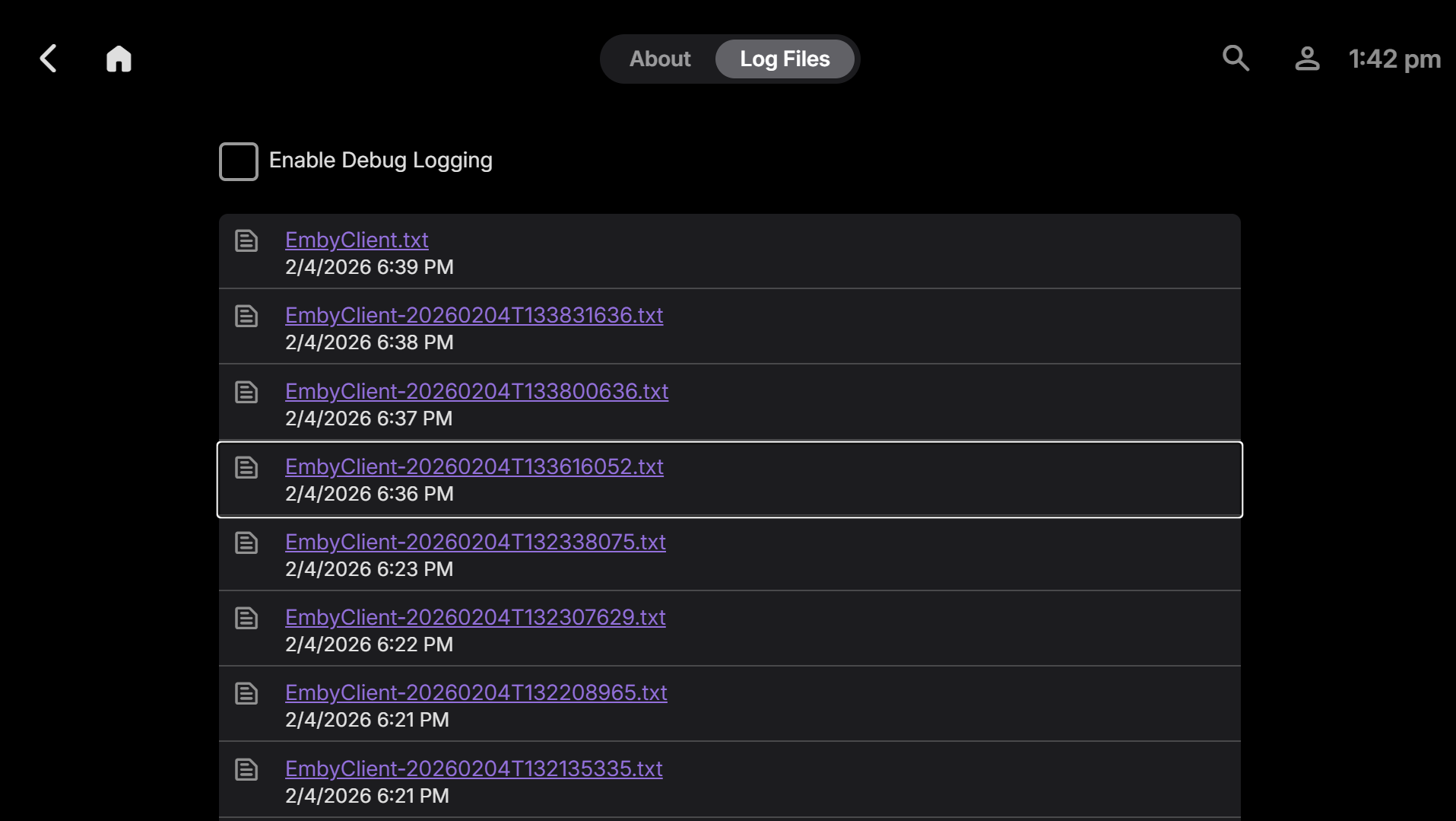

saj 14 Posted February 5 Author Posted February 5 Thank you for looking into this. I also meant to mention that when I was investigating this issue, I noticed an odd anomaly with the view log files display in the app. The log file name is listed followed by a display of the date and time for the entry. However, the displayed time is incorrect. In my case it showed times that were hours into the future. I am attaching a screenshot that illustrates this. Note that this screenshot was from 2/4, and several log files list times far beyond the current time on the display, and they don't match with the times in the log file names.
