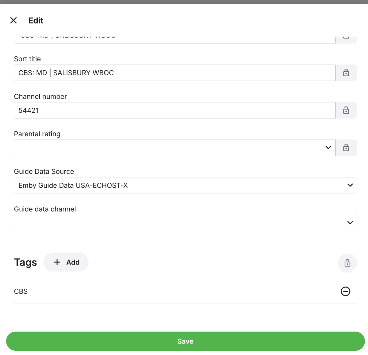

nobody40 0 Posted February 2 Posted February 2 There isn't anything on the dropdown when I press it so my epg doesn't update.
nobody40 0 Posted February 2 Author Posted February 2 When I press Guide data channel there isn't anything there and it doesn't matter which service I use. Using Version 4.10.0.2 beta has always worked will this update.

sa2000 696 Posted February 4 Posted February 4 On 02/02/2026 at 20:18, nobody40 said: There isn't anything on the dropdown when I press it so my epg doesn't update. Suggests that no channel list was obtained from gracenote for the lineup USA-ECHOST-X. You should see the channels that are available and then you can map 54421 to the one you select Whilst WBOC CBS does not appear in the lineup, there are other CBS channels "CBSSN" and "CBSSNHD" Could you try the following - Enable debug logging on Emby Server - see Log Files - Delete the files below this path C:\Users\Administrator\AppData\Roaming\Emby-Server\programdata\cache\httpclient - Restart the Emby Server - Manually run a Guide Refresh: Server Settings > Live TV> Setup tab and click on "Refresh Guide Data" - When this completes, see if the Channels tab shows a drop-down of channels to choose from when selecting Guide Data Source: Emby Guide Data USA-ECHOST-X If it does, then you can do your manual matching If it does not, provide a screenshot and giving the time and also download and attach the embyserver.txt log
