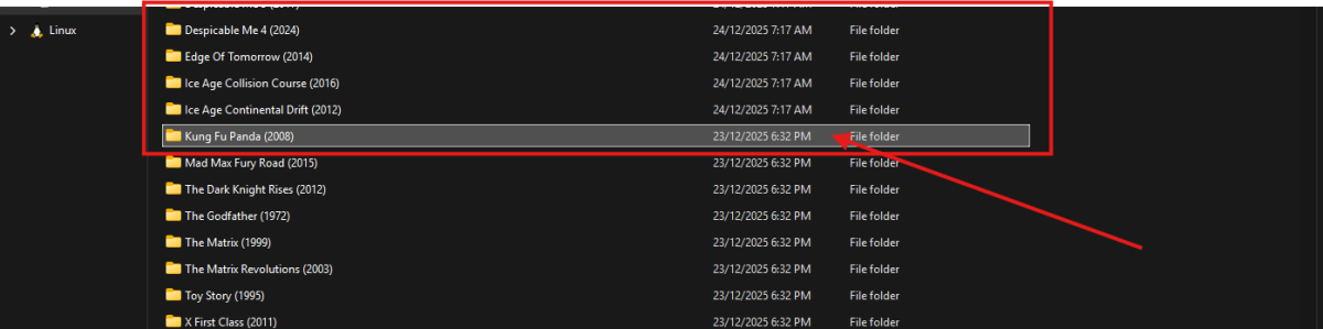

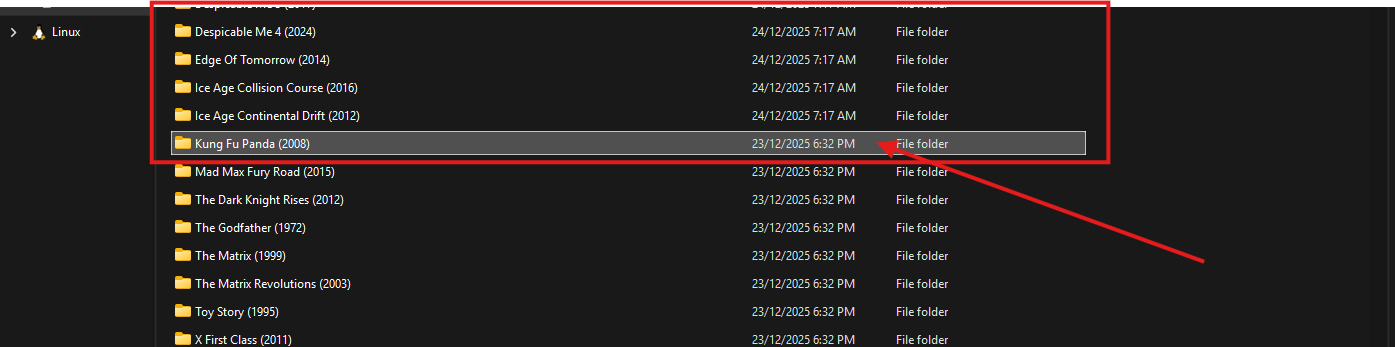

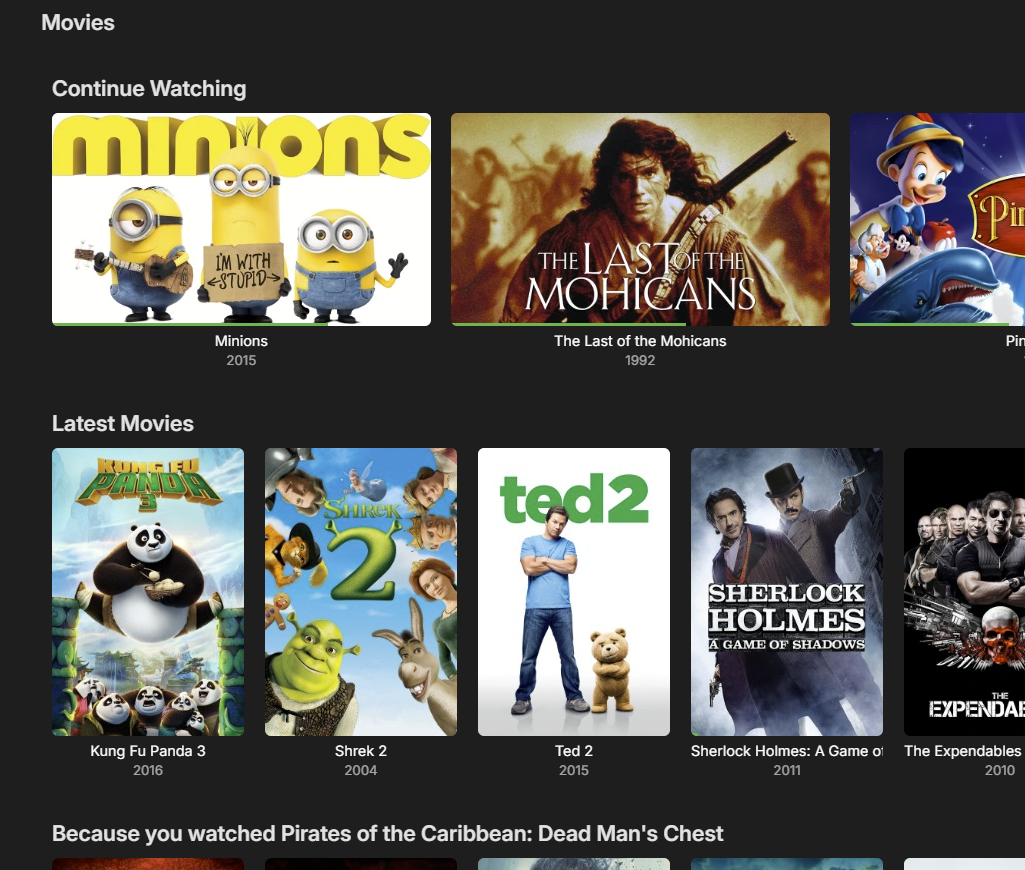

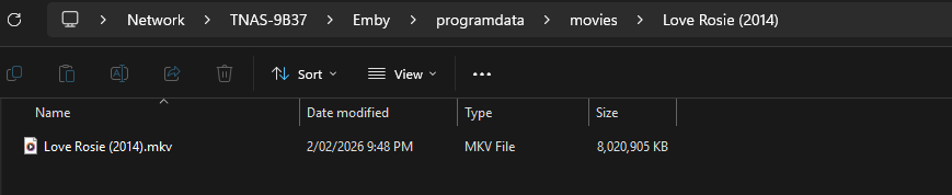

Micgroover 2 Posted February 3 Posted February 3 Hey all. I recently added a bunch of new movies to the collection and for some reason emby is not picking them up? I have tried restarting the server, scanning files and vacuuming the database. no idea what went wrong. As you can see from the screenshots Kung Fu Panda 3 was the last one but since then i've added quite a few from blu rays I've had lying around. Any help would be greatly appreciated. I've tried renaming the files with their IMDB ID's as well and it just fully isn't pulling them in.
Luke 43719 Posted February 4 Posted February 4 Hi, what exactly makes you think that Emby isn’t picking them up? Is it just due to what you see in the latest list?

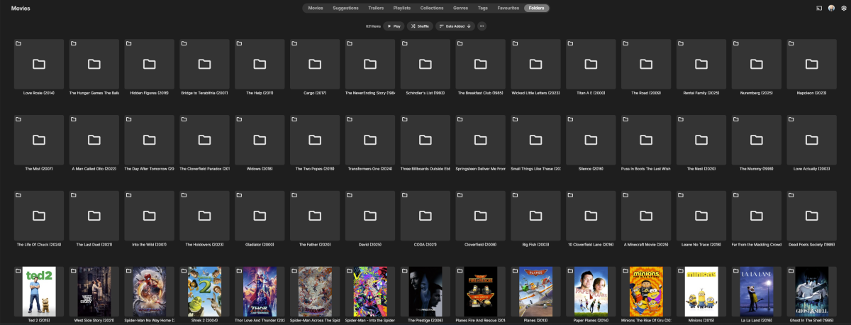

Micgroover 2 Posted February 4 Author Posted February 4 8 hours ago, Luke said: Can you try using the duplicates filter in your movies list? They may have been merged with other titles as multi version. Just tried that and there are only a handful of movies here that are flagged as duplicates (just some wedding videos I didn't name well enough). To give some further information, when I go to folders, I can see all the folders there, but it says every one of them is empty? Seems to not be picking up the files maybe?

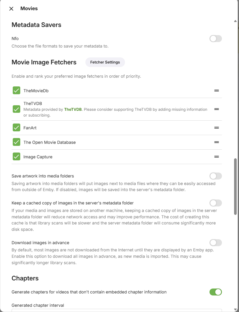

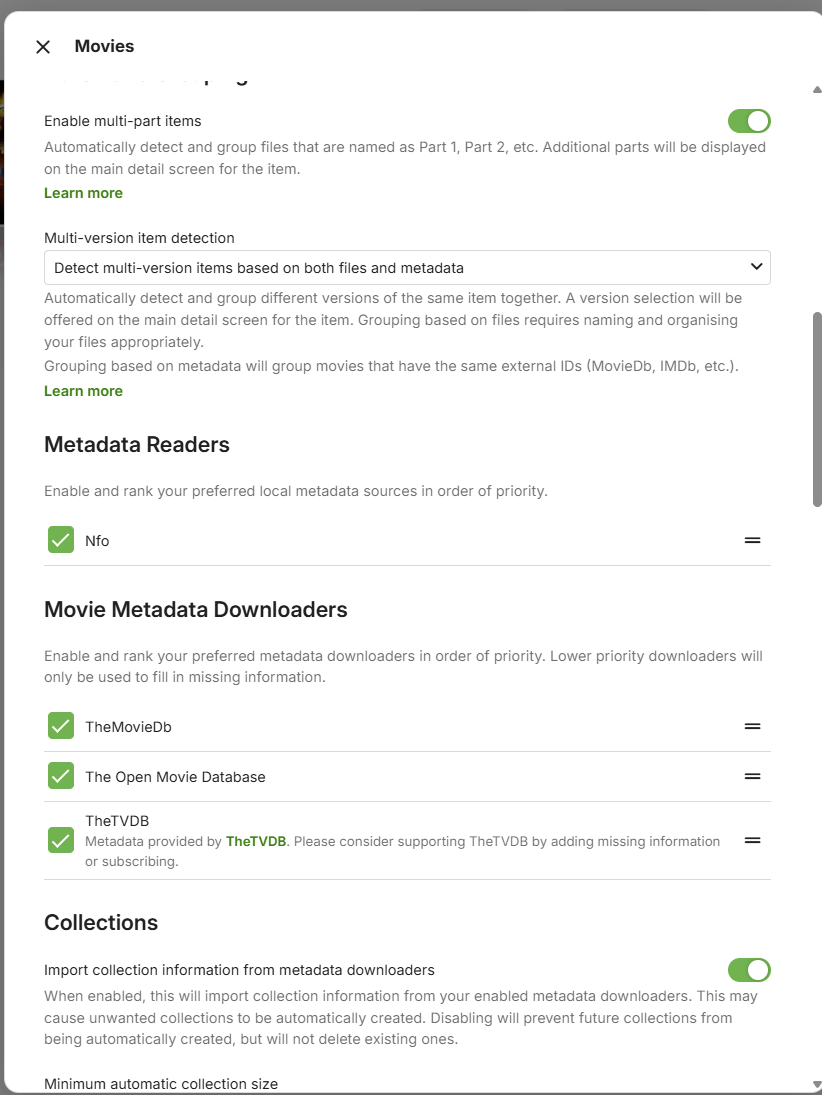

sa2000 890 Posted February 4 Posted February 4 Please also include with the log screenshots of the library settings for metadata providers
Neminem 2007 Posted February 4 Posted February 4 Yes check Metadata providers in your Library settings. Mine was not enabled after updating to server to 4.9.3.0
Micgroover 2 Posted February 8 Author Posted February 8 On 2/4/2026 at 9:38 PM, sa2000 said: Please also include with the log screenshots of the library settings for metadata providers Thanks for the recs. I have done the following: 1) Moved all missing movie folders out of the /config/movies folder. Did a library Scan 2) Moved them all back. Did another library scan. 3) Did a "scan for missing metadata" on the movies folder where they are housed. 4) Downloaded the embyserver.txt log file and attached it below. 5) Eagerly awaited response from people with bigger brains than mine. (Screenshots of metatadata setup, the "folders" tab sorted by recently added + log file below) embyserver.txt
Luke 43719 Posted February 9 Posted February 9 I would try setting the mutli-version option to be based on files only. Then run a library scan after changing it and see if that helps.
