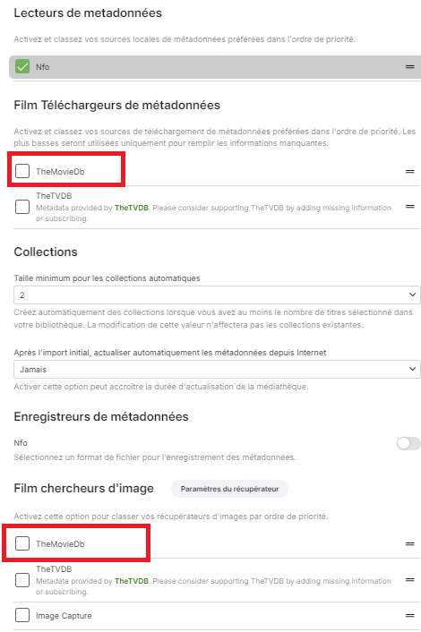

fabien_m2002 26 Posted April 18 Author Posted April 18 On 4/14/2026 at 7:08 AM, Luke said: Hi, yes this is supported. Hello @Luke What is the best settings to speed up the scan of my library? If my NFO file contains the URL of tmdb of the movie/serie, should i also enable TheMovieDb for Metada/Image downloading? Or the NFO file is enough to get metadata and images?
Luke 43549 Posted April 18 Posted April 18 Yes you should. If you don't, then you'll end up with a movie that has only a movie db id and nothing else. 1
