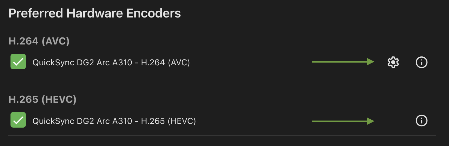

embart0r 1 Posted February 2 Posted February 2 I'm experiencing an issue with Intel QuickSync hardware-accelerated encoding on both the latest stable (4.9.3.0) and beta (4.10.0.2) versions of Emby Server. Problem: Hardware encoding via QuickSync only works for bitrates up to 39 Mbit/s. When the source bitrate exceeds this threshold, Emby falls back to software transcoding (x265), even though the hardware is capable of handling much higher bitrates. Hardware: GPU: Intel Arc A310 OS: Linux (TrueNAS Scale) Evidence from Emby's Hardware Encoder Info: When checking Transcoding Settings → Preferred Hardware Encoders → Info button, I see the following specifications: HEVC Encoder: Adapter #0: 'DG2 Arc A310' Id:22182 (Driver: , Vendor: 32902, SDK Version: 1.255) Max Bitrate: 39 Mbit/s ← Limited to 39 Mbit/s Frame Sizes: 32x32...8192x8192 Color Formats: NV12 Profile Max Level Max Bitrate Bit Depths Resolutions Main Level 5.1 39 Mbit/s 8 4096x2160@60 - 1920x1080@256 Main Still Picture Level 5.1 39 Mbit/s 4096x2160@60 - 1920x1080@256 H.264 Encoder (for comparison): Adapter #0: 'DG2 Arc A310' Id:22182 (Driver: , Vendor: 32902, SDK Version: 1.255) Max Bitrate: 234 Mbit/s ← Correctly shows 234 Mbit/s Frame Sizes: 32x32...4096x4096 Color Formats: NV12 Profile Max Level Max Bitrate Bit Depths Resolutions Baseline Level 5.2 234 Mbit/s 8 4096x2304@56 - 1920x1080@172 Main Level 5.2 234 Mbit/s 8 4096x2304@56 - 1920x1080@172 High Level 5.2 234 Mbit/s 8 4096x2304@56 - 1920x1080@172 Expected Behavior: The Intel Arc A310 should support HEVC hardware encoding at bitrates well above 39 Mbit/s (similar to the 234 Mbit/s shown for H.264). Other media servers (Jellyfin) successfully use hardware encoding on the same GPU with target bitrates exceeding 50+ Mbit/s. Question: Is this 39 Mbit/s limitation a bug, or an intentional restriction? 1

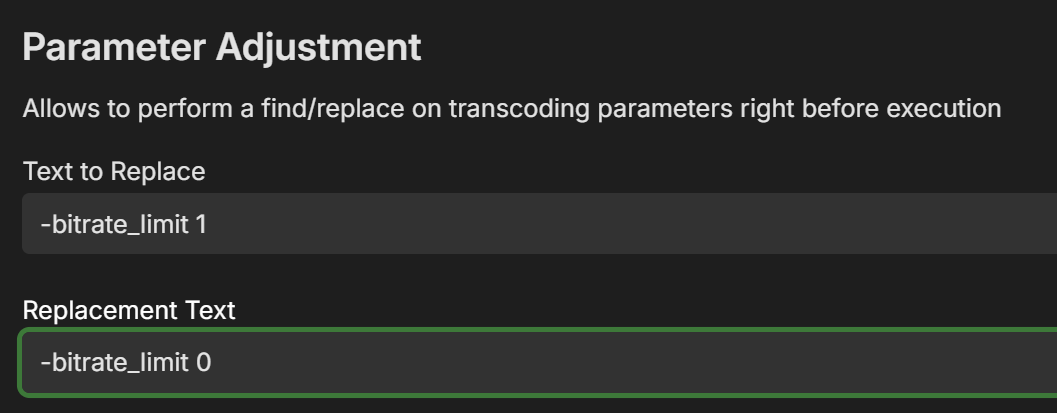

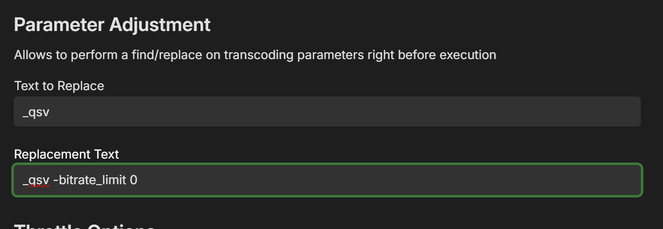

yocker 1414 Posted February 8 Posted February 8 I've see a few Linux threads mention this as well for other programs. Solution was "lowpower=on" for the driver. How you can possibly add that in Emby i don't know. You can try and install the Emby diagnostic plugin (found in the catalog) and enter this: See if that helps. If it does then you can try: The first one is just to test if it works, it will pretty much break any quality control setting but is best to test with as it's a setting that will force everything to ignore bitrate limis so is good to test with. The second one should (in my mind) have quality control settings work and work as normal for Emby. I don't have any Intel graphics at the moment to test with so can't confirm for my self.

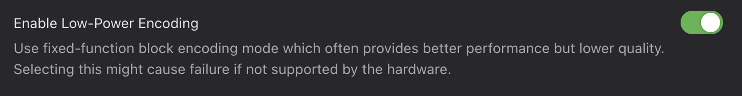

embart0r 1 Posted February 18 Author Posted February 18 @LukeNo it hasn't - same behaviour as before. Regarding the lowpower=on mode - there is a checkbox probably setting this parameter in advanced settings for h264. But for h265 hardware encoder I can't even enter the advanced settings, cause the button for it is missing. In advanced settings for h264:

yocker 1414 Posted February 20 Posted February 20 On 2/19/2026 at 1:54 AM, embart0r said: I'm quite happy for you that you have a working B860 card. Your post and "Comparison Table" look quite AI generated to me and contain hardly any reliable information. I have explained my problem clearly - and now I have to prove something for my own card just because you're making claims about it, which you can't even verify since you have a completely different card. Nothing from a quick search supports your claims: https://github.com/intel/media-driver#decodingencoding-features https://github.com/intel/media-driver/blob/master/docs/media_features.md#supported-encoding-input-format-and-max-resolution https://en.wikipedia.org/wiki/Intel_Quick_Sync_Video As already mentioned, it works in Jellyfin and the Arc A310 does support HEVC (up to 10 bit) encoding. QED with ffmpeg (HEVC HW 10-bit Encode): ffmpeg -vaapi_device /dev/dri/renderD128 \ -f lavfi -i testsrc2=duration=5:size=3840x2160:rate=60 \ -vf "format=p010,hwupload" \ -c:v hevc_vaapi -profile:v main10 \ -b:v 100M -maxrate 100M -minrate 100M -bufsize 50M \ test_hevc_10bit_force.mp4 Results in a ~60MB file. That's 60×8÷5 = ~96 Mbit/s. Try "Test to replace: MaxBitrate=39000000" "Replacement Text: MaxBitrate=250000000" Last thing i can think of.
embart0r 1 Posted February 20 Author Posted February 20 Sadly same behaviour. I mean, it actually has max video bitrate like around 60 Mbit/s set in ffmpeg command line when I set 60Mbit/s limit on client. But it won't use hardware encoding - it falls back to software. That's actually the whole point. From transcoding_x.log: >>>>>> FindVideoEncoder - MediaType: hevc, UseHardwareCodecs: True, HWA-Mode: Advanced Info Checking: 'QuickSync DG2 Arc A310 - H.265 (HEVC)' NoMatch Bitrate (57 Mbit/s) exceeds maximum supported rate (39 Mbit/s) NoMatch Encoder does not match Info Checking: 'x265' Info Check successful - selecting 'x265' ... /bin/ffmpeg -loglevel +timing -y -print_graphs_file "/config/logs/ffmpeg-transcode-1daaaf12-a602-4b4c-956d-cae13cc732c4_1graph.txt" -copyts -start_at_zero -init_hw_device "qsv=dev1:hw_any,child_device=/dev/dri/renderD128" -filter_hw_device dev1 -f matroska,webm -ss 00:00:06.000 -c:v:0 hevc_qsv -threads:v:0 1 -hwaccel:v:0 qsv -hwaccel_output_format:v:0 qsv -noautorotate -i "/media/test.mkv" -filter_complex "[0:0]hwdownload@f1,format@f2=pix_fmts=p010,format@f3=pix_fmts=yuv420p,format@f4=pix_fmts=p010,supertonemap@f5=tonemap=bt2390,format@f6=pix_fmts=yuv420p[f6_out0]" -map [f6_out0] -map 0:1 -sn -c:v:0 libx265 -b:v:0 59616001 -g:v:0 72 -maxrate:v:0 59616001 -bufsize:v:0 119232002 -keyint_min:v:0 72 -r:v:0 23.976024627685547 -preset:v:0 veryfast -profile:v:0 main -c:a:0 aac -ab:a:0 192000 -ac:a:0 2 -metadata:s:a:0 language=ger -filter:a:0 "volume=2" -disposition:a:0 default -max_delay 5000000 -avoid_negative_ts disabled -f segment -map_metadata -1 -map_chapters -1 -segment_format mpegts -segment_list "/config/transcoding-temp/130EFC/130EFC.m3u8" -segment_list_type m3u8 -segment_time 00:00:03.000 -segment_start_number 2 -individual_header_trailer 0 -write_header_trailer 0 -segment_write_temp 1 "/config/transcoding-temp/130EFC/130EFC_%d.ts" -map 0:6 -map 0:0 -an -c:v:0 copy -c:s:0 webvtt -max_delay 5000000 -avoid_negative_ts disabled -f segment -map_metadata -1 -segment_format webvtt -segment_list "/config/transcoding-temp/130EFC/130EFC_s6.m3u8" -segment_list_type m3u8 -segment_time 00:00:03.000 -segment_start_number 2 -break_non_keyframes 1 -individual_header_trailer 1 -write_header_trailer 0 -write_empty_segments 1 -segment_write_temp 1 -min_frame_time 00:00:06.000 "/config/transcoding-temp/130EFC/130EFC_s6_%d.vtt"
yocker 1414 Posted February 21 Posted February 21 2 hours ago, embart0r said: Sadly same behaviour. I mean, it actually has max video bitrate like around 60 Mbit/s set in ffmpeg command line when I set 60Mbit/s limit on client. But it won't use hardware encoding - it falls back to software. That's actually the whole point. From transcoding_x.log: >>>>>> FindVideoEncoder - MediaType: hevc, UseHardwareCodecs: True, HWA-Mode: Advanced Info Checking: 'QuickSync DG2 Arc A310 - H.265 (HEVC)' NoMatch Bitrate (57 Mbit/s) exceeds maximum supported rate (39 Mbit/s) NoMatch Encoder does not match Info Checking: 'x265' Info Check successful - selecting 'x265' ... /bin/ffmpeg -loglevel +timing -y -print_graphs_file "/config/logs/ffmpeg-transcode-1daaaf12-a602-4b4c-956d-cae13cc732c4_1graph.txt" -copyts -start_at_zero -init_hw_device "qsv=dev1:hw_any,child_device=/dev/dri/renderD128" -filter_hw_device dev1 -f matroska,webm -ss 00:00:06.000 -c:v:0 hevc_qsv -threads:v:0 1 -hwaccel:v:0 qsv -hwaccel_output_format:v:0 qsv -noautorotate -i "/media/test.mkv" -filter_complex "[0:0]hwdownload@f1,format@f2=pix_fmts=p010,format@f3=pix_fmts=yuv420p,format@f4=pix_fmts=p010,supertonemap@f5=tonemap=bt2390,format@f6=pix_fmts=yuv420p[f6_out0]" -map [f6_out0] -map 0:1 -sn -c:v:0 libx265 -b:v:0 59616001 -g:v:0 72 -maxrate:v:0 59616001 -bufsize:v:0 119232002 -keyint_min:v:0 72 -r:v:0 23.976024627685547 -preset:v:0 veryfast -profile:v:0 main -c:a:0 aac -ab:a:0 192000 -ac:a:0 2 -metadata:s:a:0 language=ger -filter:a:0 "volume=2" -disposition:a:0 default -max_delay 5000000 -avoid_negative_ts disabled -f segment -map_metadata -1 -map_chapters -1 -segment_format mpegts -segment_list "/config/transcoding-temp/130EFC/130EFC.m3u8" -segment_list_type m3u8 -segment_time 00:00:03.000 -segment_start_number 2 -individual_header_trailer 0 -write_header_trailer 0 -segment_write_temp 1 "/config/transcoding-temp/130EFC/130EFC_%d.ts" -map 0:6 -map 0:0 -an -c:v:0 copy -c:s:0 webvtt -max_delay 5000000 -avoid_negative_ts disabled -f segment -map_metadata -1 -segment_format webvtt -segment_list "/config/transcoding-temp/130EFC/130EFC_s6.m3u8" -segment_list_type m3u8 -segment_time 00:00:03.000 -segment_start_number 2 -break_non_keyframes 1 -individual_header_trailer 1 -write_header_trailer 0 -write_empty_segments 1 -segment_write_temp 1 -min_frame_time 00:00:06.000 "/config/transcoding-temp/130EFC/130EFC_s6_%d.vtt" Emby added a fix to make Intel Arc cards work in the 4.8 release, might be causing some unintended problems. Could also be the version of FFMpeg they use, they have promised a new version very soon.
