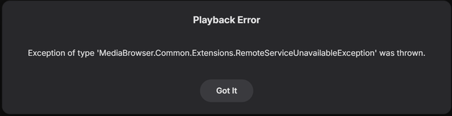

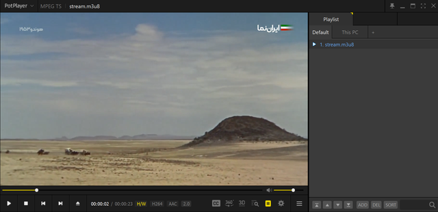

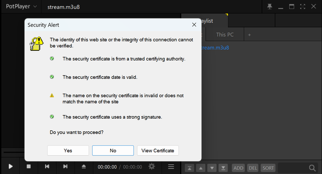

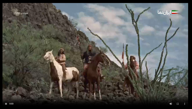

Nimasa 14 Posted February 2 Posted February 2 (edited) Emby latest stable version is unable to play the following stream: https://iran613hls.wns.live/hls/stream.m3u8 And throws this error: Quote https://i.ibb.co/Y7CMtThZ/Emby-Error.png However, Google Chrome can handle and play the stream fine, as shown in this screenshot: Quote https://i.ibb.co/tTSxMJR1/Chrome.png Opening the stream in Pot Player, at first, shows a warning to proceed, as shown below: Quote https://i.ibb.co/qL5qfCFv/warning-in-Pot-Player.png and initially fails. But after double-clicking the address in playlist, it plays fine as shown below. Quote https://i.ibb.co/hFyg9HTn/Pot-Player.png Server log is attached. embyserver.txt Edited February 2 by Nimasa

Nimasa 14 Posted May 12 Author Posted May 12 it's a security warning regarding domain certificate. Is it possible to have an option to suppress such security warnings?

Nimasa 14 Posted May 31 Author Posted May 31 (edited) 1 hour ago, Luke said: So the security warning is just in PotPlayer ? Also in Chrome, but after proceeding and approving the warning, both Chrome and PotPlayer play the video. This is not the case with emby. Emby fails to open the URL without even asking the user. It just throws an error. Having an option in the server side to bypass (approve) such warnings would be helpful. Edited May 31 by Nimasa
