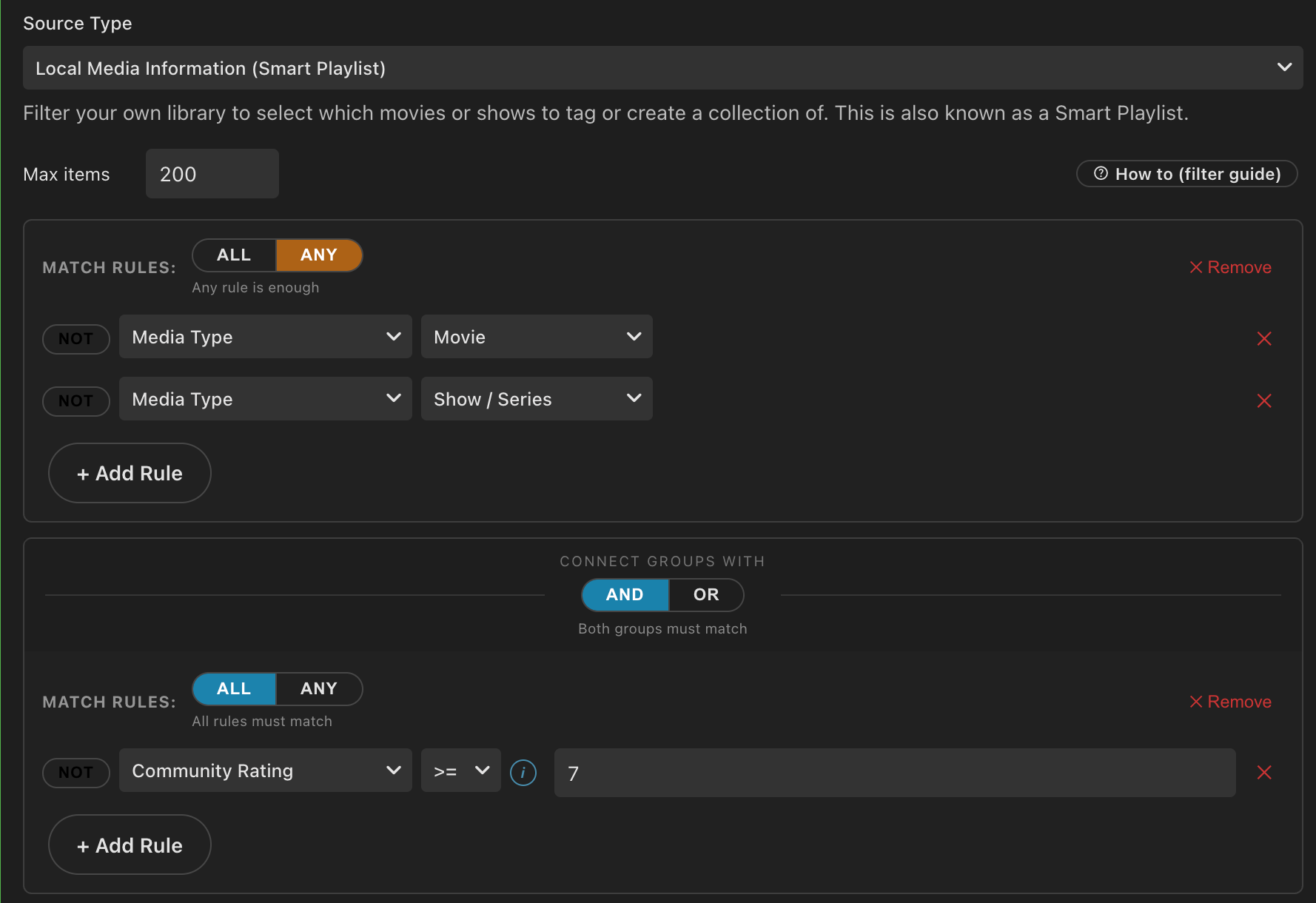

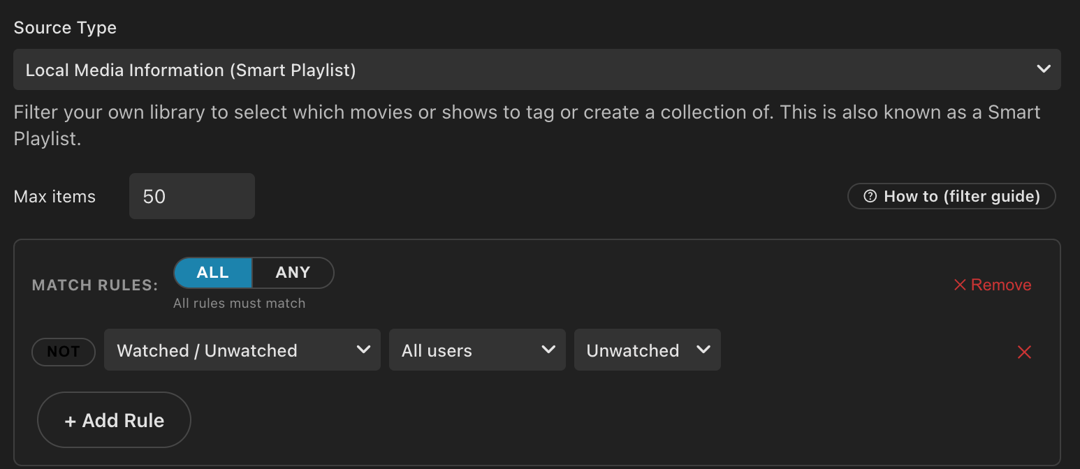

soderlund 231 Posted May 24 Author Posted May 24 (edited) 1 hour ago, Babatom said: I’ve set up a home screen and now want to synchronise it with all users. I’m not sure about one rule. Will it be automatically adapted to each user? It would be great if each user only saw what they haven’t seen yet. No it will not adapt to each individual user. For that you need to create a separate group for each user. The filter in you picture will give you all movies and series that NO user have watch. Even if you have 100 users, it's enough that only one of them have seen that movie and it will not end up on the list. So in simpler terms - this will give you a list with 50 items of movies and shows that no one has seen. What I suggest you do is use the playstatus for the home section. This will adapt to each user and if set to unplayed it will hide movies that the individual user has seen. Edited May 24 by soderlund
Babatom 39 Posted May 24 Posted May 24 That should work, shouldn't it? Here's how I'd generally like to set it up: I configure the entire home screen once and then sync it with all users. I've just realised that under the 'Tag & Collection' tab -> 'Home Screen', I set the play state to 'unplayed', save it and perform a full sync. The next time I go back into this setting, the playstate is back to 'any'.So it isn’t saved permanently.
soderlund 231 Posted May 24 Author Posted May 24 2 hours ago, Babatom said: That should work, shouldn't it? Here's how I'd generally like to set it up: I configure the entire home screen once and then sync it with all users. I've just realised that under the 'Tag & Collection' tab -> 'Home Screen', I set the play state to 'unplayed', save it and perform a full sync. The next time I go back into this setting, the playstate is back to 'any'.So it isn’t saved permanently. Those filters should be correct Although, it is redundant to have the filter for media type=movie and show, since that is the default. But if you want to have them, go ahead! Regarding the error, I cant reproduce that. What server version are you running? This was an bug with Emby version before 4.10.0.9 or something if i remember correctly 1
