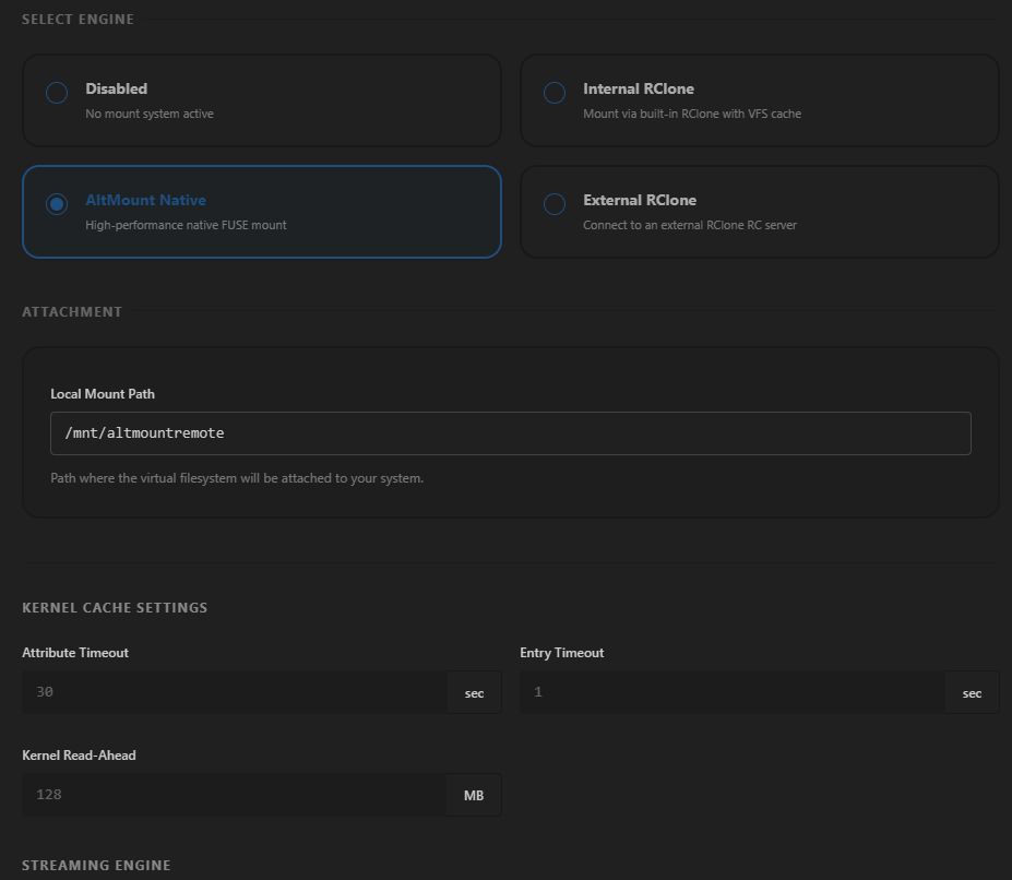

gene0915 43 Posted April 26 Posted April 26 Seeing something similar but I'm not using rclone. I'm using Altmount, with it's native Fuse mount setting. Server gets minimal usage but after 24+ hours, Emby was taking up 1.2 gigs of RAM. Running it on a bare metal Debian 13 install.

gene0915 43 Posted April 27 Posted April 27 6 hours ago, kikinjo said: Post your rclone config first My Altmount install doesn't use rclone. I'm using its' native Fuse mount option:
