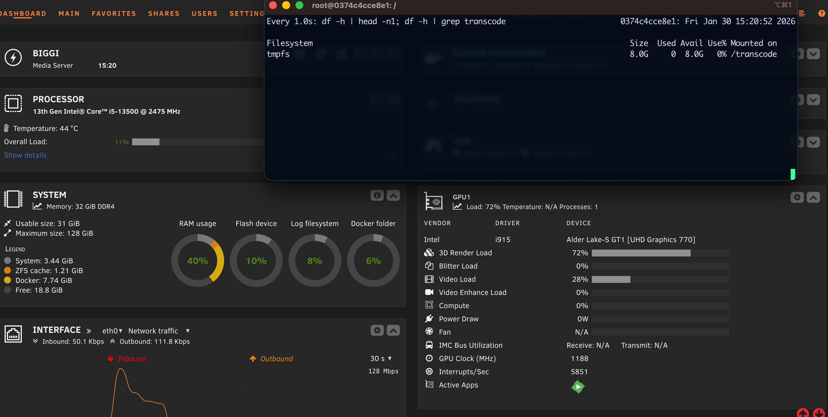

Babatom 11 Posted January 30 Author Posted January 30 nope there are approximately 20GB free. Playback started at 2:09 PM, it started stuttering at 2:12 PM. ffmpeg-transcode-16e86533-0c89-4e55-a51d-518cf8073d9d_1.txt

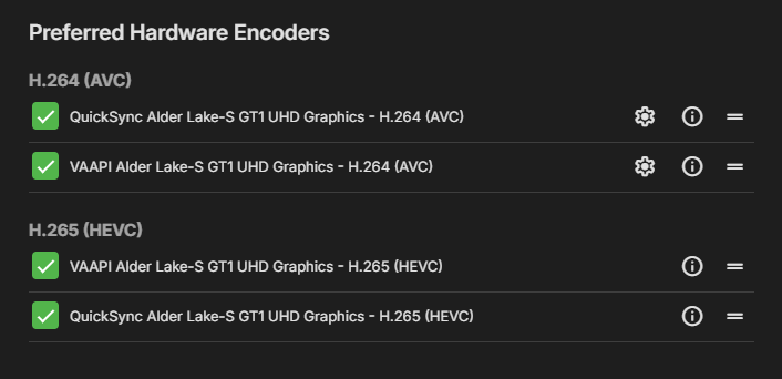

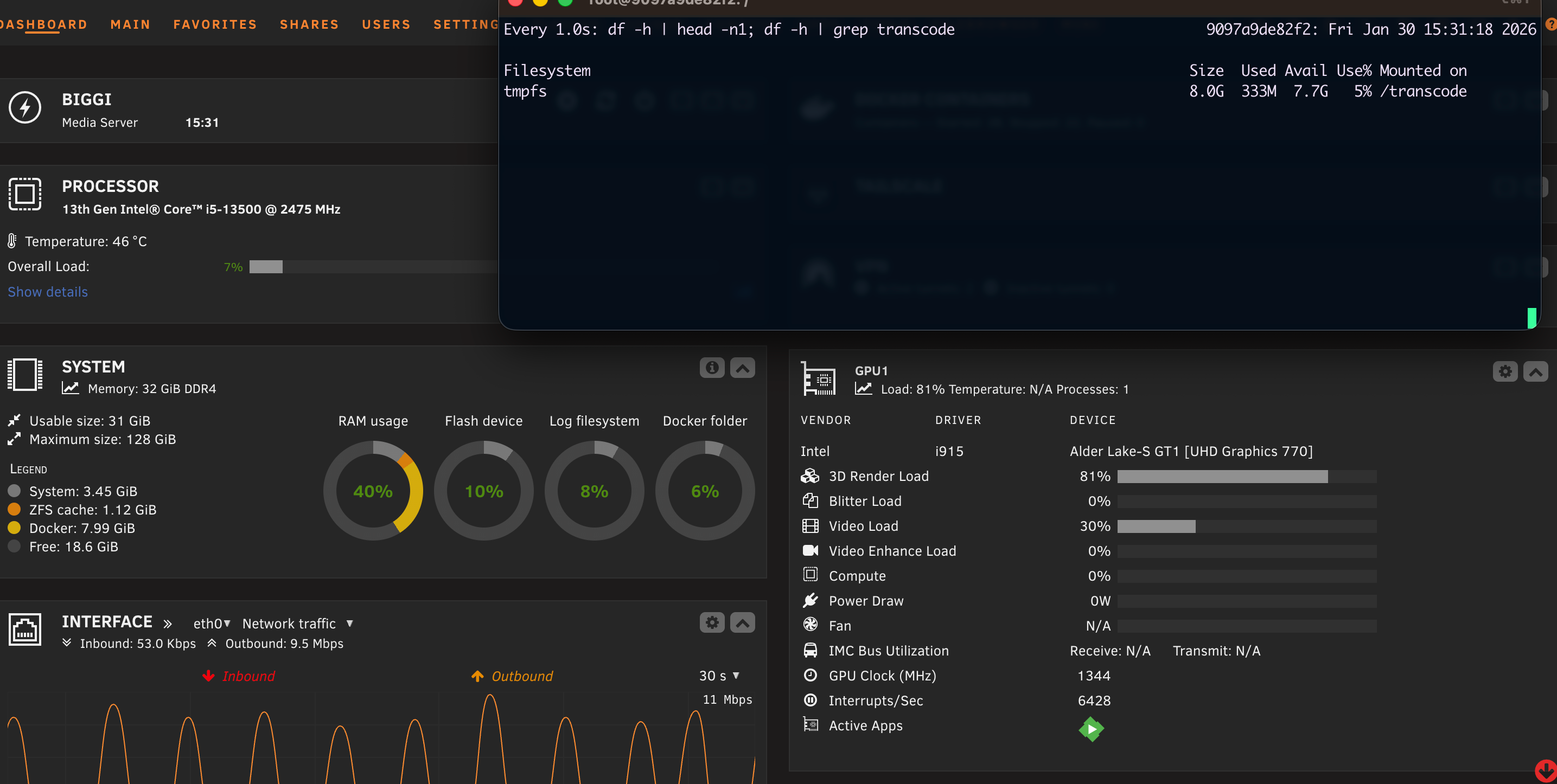

Neminem 1623 Posted January 30 Posted January 30 5 minutes ago, Babatom said: /transcode How much space is left in that, when it starts to studder? I just want to rule out, that your RAM drive is not too small 1 minute ago, Babatom said: Are there any known issues with Emby and QSV? Jellyfin works perfectly on the same server. I seam to have the same iGPU as you. Here is my transcoding settings. I never have had much luck with QSV.
Q-Droid 1011 Posted January 30 Posted January 30 From the ffmpeg log: 14:09:37.023 [segment @ 0x14000c0] Opening '/config/transcoding-temp/0D5DB1/0D5DB1_s6_727.vtt.tmp' for writing 14:09:37.064 [segment @ 0x1324800] Opening '/config/transcoding-temp/0D5DB1/0D5DB1.m3u8.tmp' for writing 14:09:37.064 SegmentComplete=video:0 Index=726 Start=2178.426189 End=2181.429189 Duration=3.003000 offset_pts=0 start_pts=2178426189 Frames=72 filename=0D5DB1_726.ts 14:09:37.064 [segment @ 0x1324800] Opening '/config/transcoding-temp/0D5DB1/0D5DB1_727.ts.tmp' for writing 14:09:37.165 Too many packets buffered for output stream 1:1. 14:09:37.196 Conversion failed! 14:09:37.196 EXIT
Babatom 11 Posted January 30 Author Posted January 30 22 minutes ago, Q-Droid said: Opening '/config/transcoding-temp/ That means RAM isn't being used, right? It doesn't fill up even when I start playback.
Q-Droid 1011 Posted January 30 Posted January 30 (edited) You're focusing on the wrong thing. Ffmpeg is choking on the stream. 14:09:37.165 Too many packets buffered for output stream 1:1. 14:09:37.196 Conversion failed! Edited January 30 by Q-Droid 1
Babatom 11 Posted January 30 Author Posted January 30 Okay, I removed the RAM transcoding, restarted the container, and set it up again. Now it seems to be working; I can see it filling up in the terminal and in the logs: [segment @ 0x11c4500] Opening '/transcode/transcoding-temp/C60130/C60130_s7.m3u8.tmp' for writing I've played it for about 6 minutes now and it hasn't stopped. Now my question remains: why did Emby automatically change the transcoding path from /transcode to /config? And regarding transcoding in general, does it work like this: I start playback, the iGPU transcodes the entire movie, writes it to RAM, and then stops working?

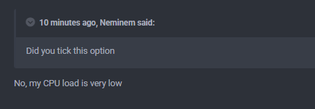

Neminem 1623 Posted January 30 Posted January 30 11 minutes ago, Babatom said: why did Emby automatically change the transcoding path from /transcode to /config? That's the default location, I use a toss away SSD for transcoding. 13 minutes ago, Babatom said: I start playback, the iGPU transcodes the entire movie, Did you tick this option. 14 minutes ago, Babatom said: I've played it for about 6 minutes now and it hasn't stopped. New transcoding logs.

Babatom 11 Posted January 30 Author Posted January 30 Just now, Neminem said: That's the default location, I use a toss away SSD for transcoding yes, but I set the RAM as the path... 1 minute ago, Neminem said: Did you tick this option No, my CPU load is very low 3 minutes ago, Neminem said: New transcoding logs it has started to stall again 15:55:25.695 Too many packets buffered for output stream 1:1. 15:55:25.712 Conversion failed! 15:55:25.712 EXIT
Neminem 1623 Posted January 30 Posted January 30 This also works with GPU, even though its not worded like that. 2
