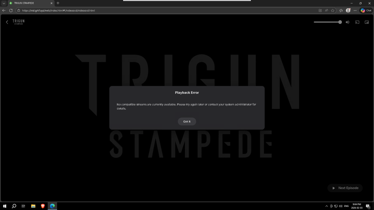

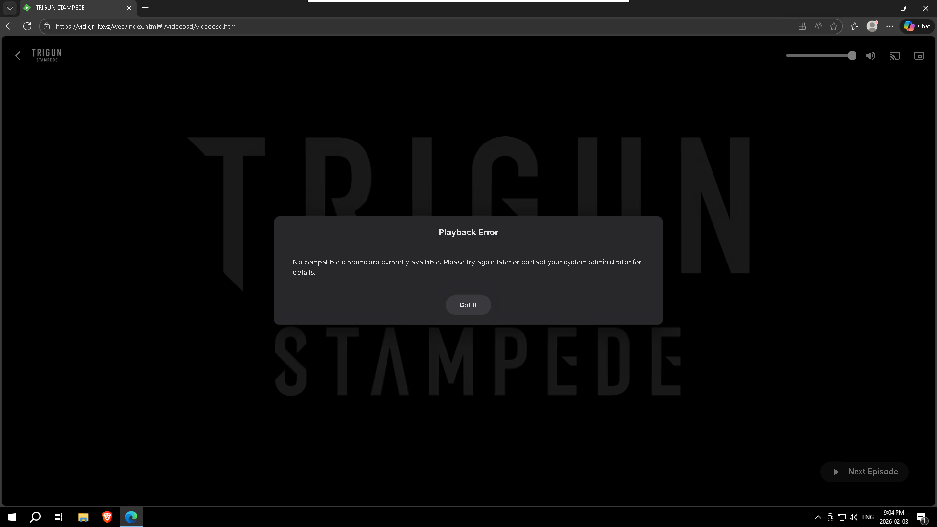

Betonhaus 18 Posted January 29 Posted January 29 The preroll works fine, but any content i try to play just fails to lode eventually giving me an error. I have a Intel Arc a380 on the server handling embyserver.txt so I don't get why things aren't working ffmpeg-transcode-07a448ec-7284-4ad2-aa77-dabf7a55f20e_1.txt ffmpeg-transcode-68ef22fc-2d1c-4df3-9154-6a2d03a4e2a9_1.txt ffmpeg-transcode-86b3dd01-4834-438f-9a9a-9efae3463447_1.txt ffmpeg-transcode-90a79e81-a6d6-49f6-b752-d6f67f1cc58c_1.txt ffmpeg-transcode-163f4097-7509-4fda-b2b5-59b13591bbb7_1.txt ffmpeg-transcode-78235314-111d-41bf-827d-2800823cc7f3_1.txt ffmpeg-transcode-d4c521ca-ac0a-42a9-8eaa-b7b7a64fbe52_1.txt ffmpeg-transcode-f0bdcd46-536f-4099-840c-09d8cc2136ef_1.txt ffmpeg-transcode-f362e079-06d1-46bb-83b6-9b6e0440a0b2_1.txt

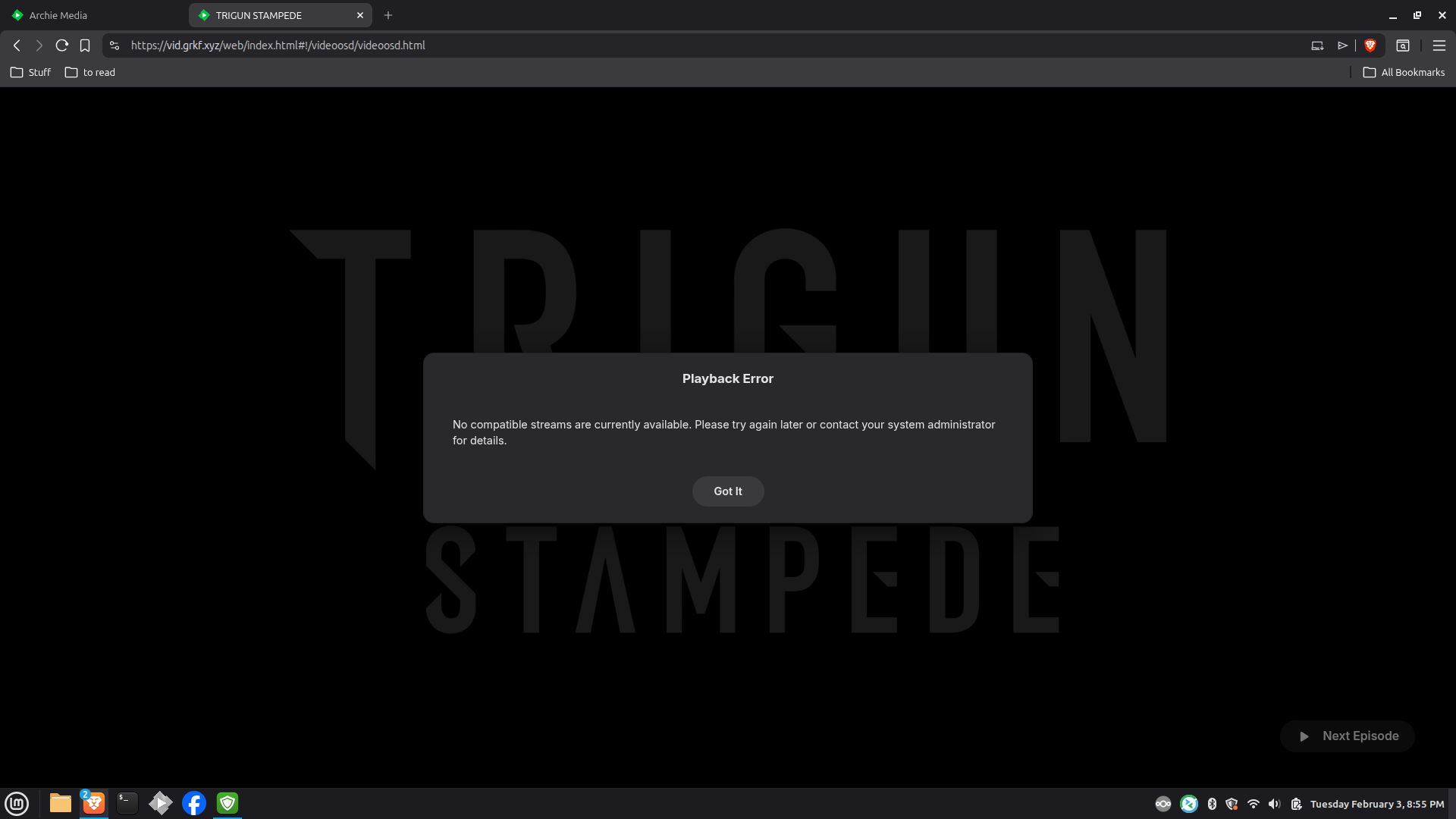

Betonhaus 18 Posted February 2 Author Posted February 2 Exact same thing, exact same problems. This has been a continual problem with all browsers, either desktop or mobile. Either the server side transcoding is shit or the website doesn't properly convert what codecs are supported.

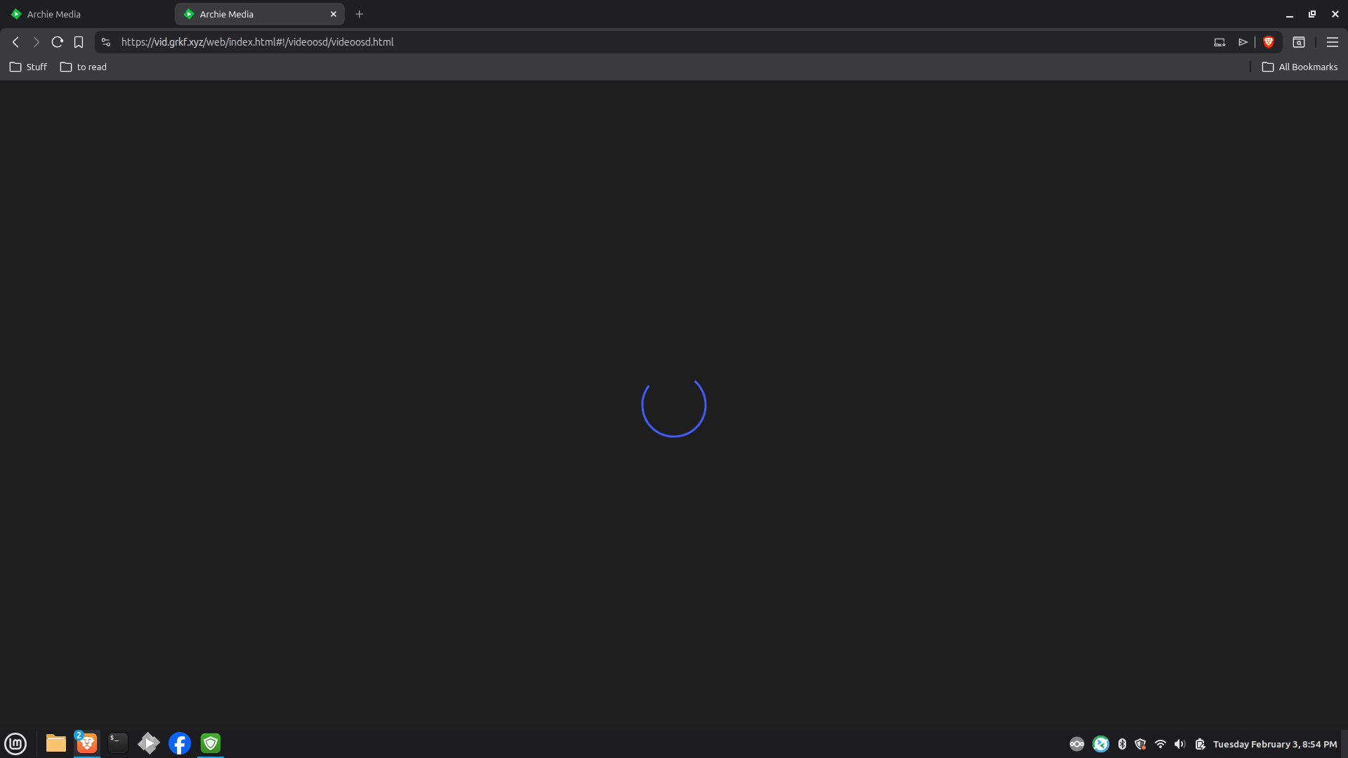

Betonhaus 18 Posted February 8 Author Posted February 8 When Subtitle Extraction is enabled: Web browser works, all web browsers and subtitles work fine after a short delay Google TV clients struggle with subtitles and become a slideshow when there is heavy subtitle use Emby Theatre for Windows is unable to play subtitles Emby beta for Linux works fine When Subtitle Extraction is disabled: Web browsers will show a loading wheel for a while before erroring out. all web browsers, both on Linux and Windows Google TV and Roku devices work properly Emby Theatre for Windows runs fine Emby Beta for Linux runs fine I did post my configuration info on the docker page in case I had made an obvious mistake. I reattempted to watch an episode of Trigun Stampede in a web browser with subtitle extraction disabled and here are the log files. it created three transcode logs from the attempt. Web browser and Linux beta was attempted from a local network, google tv and the windows client from outside the network. It seems that whenever transcoding is required the subtitles do not get added to the transcode even if set to. 13 minutes ago, Betonhaus said: Does this seem like it's set up fine? I keep having issues with transcoding emby: image: emby/embyserver container_name: embyserver network_mode: host # Enable DLNA and Wake-on-Lan environment: - UID=1000 - GID=1002 - GIDLIST=993 - TZ=America/Edmonton volumes: - /mnt/docker/emby:/config - /mnt/pool/media:/mnt/media devices: - /dev/dri:/dev/dri restart: unless-stopped $ fastfetch .... redacted .',:clooo: .:looooo:. -------------- .;looooooooc .oooooooooo' OS: Ubuntu 24.04.3 LTS (Noble Numbat) x86_64 .;looooool:,''. :ooooooooooc Host: X99-D3 ;looool;. 'oooooooooo, Kernel: Linux 6.8.0-94-generic ;clool' .cooooooc. ,, Uptime: 6 days, 23 hours, 21 mins ... ...... .:oo, Packages: 1104 (dpkg) .;clol:,. .loooo' Shell: bash 5.2.21 :ooooooooo, 'ooool Terminal: /dev/pts/0 'ooooooooooo. loooo. CPU: Intel(R) Xeon(R) E5-2696 v3 (36) @ 3.80 GHz 'ooooooooool coooo. GPU 1: Intel Arc A380 @ 2.45 GHz [Discrete] ,loooooooc. .loooo. GPU 2: Intel Arc A310 @ 2.45 GHz [Discrete] .,;;;'. ;ooooc Memory: 9.63 GiB / 125.69 GiB (8%) ... ,ooool. Swap: 2.25 MiB / 8.00 GiB (0%) .cooooc. ..',,'. .cooo. Disk (/): 237.73 GiB / 456.35 GiB (52%) - ext4 ;ooooo:. ;oooooooc. :l. Disk (/mnt/backup): 118.44 GiB / 915.82 GiB (13%) - ext4 .coooooc,.. coooooooooo. Disk (/mnt/dsk/1): 10.58 TiB / 12.63 TiB (84%) - ext4 .:ooooooolc:. .ooooooooooo' Disk (/mnt/dsk/2): 10.25 TiB / 12.63 TiB (81%) - ext4 .':loooooo; ,oooooooooc Disk (/mnt/dsk/3): 10.70 TiB / 12.63 TiB (85%) - ext4 ..';::c' .;loooo:' Disk (/mnt/dsk/4): 10.76 TiB / 12.63 TiB (85%) - ext4 Disk (/mnt/dsk/5): 12.14 TiB / 14.44 TiB (84%) - ext4 Disk (/mnt/dsk/6): 12.10 TiB / 14.44 TiB (84%) - ext4 Disk (/mnt/games): 28.00 KiB / 219.00 GiB (0%) - ext4 Disk (/mnt/wrk): 68.48 GiB / 953.40 GiB (7%) - xfs If i disable subtitle extraction then access through the web app doesn't work, but if I enable subtitle extraction then devices like the Google TV shit the bed and the Emby Client for windows doesn't play subtitles embyserver.txt ffmpeg-transcode-d4b1671b-0a2c-463a-93d0-f42e04056056_1.txt ffmpeg-transcode-c21571b0-be39-4220-9b5d-b94c488340db_1.txt ffmpeg-transcode-71feef5a-13fd-4feb-be16-f0a930fa2e4f_1.txt
