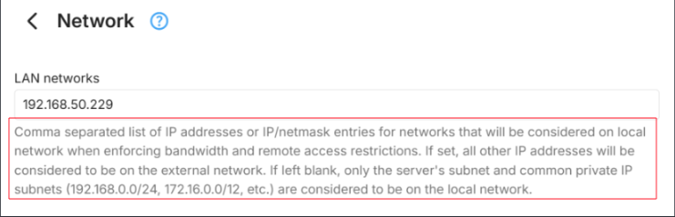

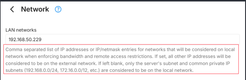

Neminem 1620 Posted February 5 Posted February 5 Did you read an understand the help text under this ? Are you client devices on the same subnet as your server? How are your client device connected ( wifi / cable )? If wifi have you restarted your router? If wifi do you have AP Isolation enabled on you AP? If cable are you using a managed switch with multible vlans? 1
tbischof72 0 Posted February 5 Author Posted February 5 (edited) Yes, client devices on same subnet, connected via cable, not using a switch using a mesh network, the NAS with the Emby server is directly connected to the main hub, which is connected via ethernet cable to the mesh nodes and the TV is also connected directly to one of the nodes Again, a file plays fine when a Samsung compatible audio codec is selected (like AC3), but when I select one that requires transcoding (like TrueHD or DTS) it fails. Can that issue be network related? Edited February 5 by tbischof72
Neminem 1620 Posted February 5 Posted February 5 (edited) It can. if the server sees the client as remote. Try this in your lan networks. Replace 192.168.50.229 with 192.168.50.0/24 Here is my network config. 1) 10.253.0.0/24 - VPN access. 2) 192.168.1.0/24 - local lan network. 3) 172.17.0.0/24 - Docker network. Edited February 5 by Neminem 1 1
