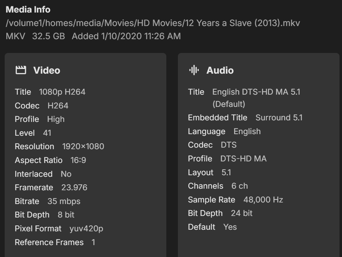

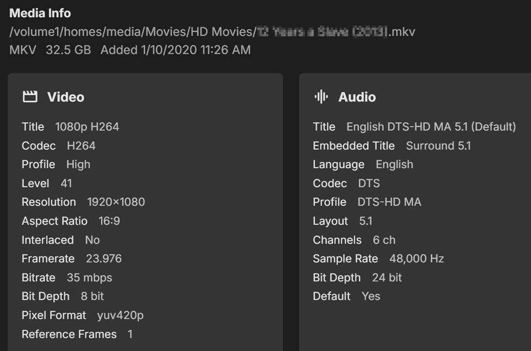

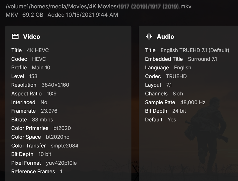

tbischof72 0 Posted January 28 Posted January 28 Problem description Playback error “no compatible streams” for all files 4K, HD Only on Samsung TV via Emby app Plays fine on Windows, Android (Pixel phone), Google TV (Hisense TV) and even if directly played on the Samsung TV (selecting the file via ‘connected devices’ on the NAS) It also used to work for the last 2+ years, not sure though when it stopped working, sometime late Q3 early Q4 2025 … System details Samsung model number: QN90B (2022, US model) Samsung firmware version: 1710 (released 10/2025) Emby server on Synology NAS DS418play with DSM 7.2.1-69057 Update 8 Emby server version: 4.9.3.0 Samsung Emby client version: 2.3.0 (updated via USB, tried as a remedy, but also not working with the official release available from Samsung) Attached are the server and any transcode logs during the time of playback. Screenshots of the media info from the bottom of the web client: Example 1 (HD) Example 2 (HD) Example 3 (4k) embyserver_log_12826.txt

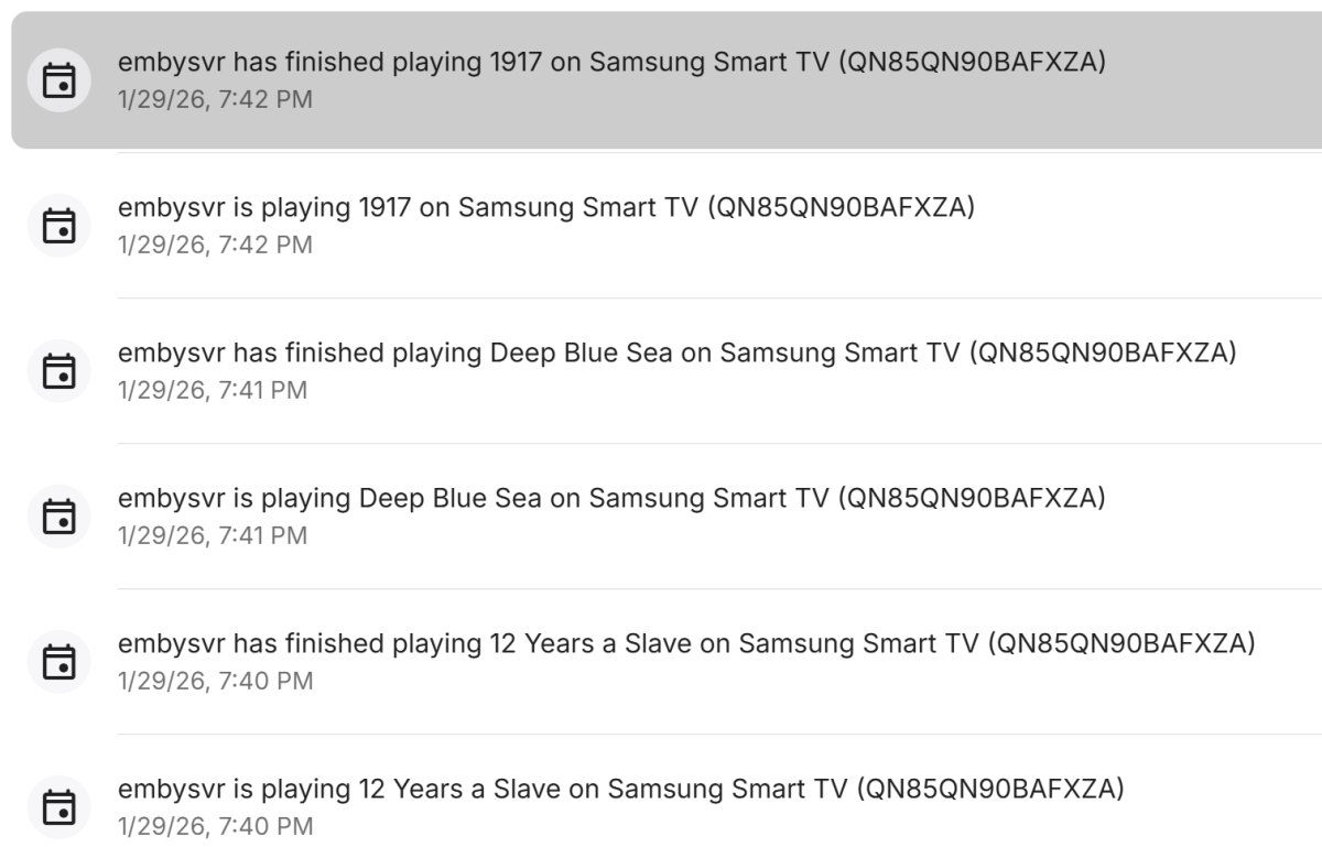

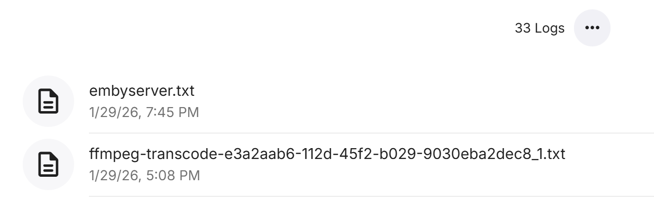

tbischof72 0 Posted January 30 Author Posted January 30 No, I'm only getting ffmpeg logs when I can play the movie successfully, e.g. via the Hisense TV or directly on windows. If I play on the Samsung I only get an activity recording like this and a general log. see next screen shot the ffmpeg log here from earlier (5:08pm) is when I played a file directly form the windows pc Attached the latest log file ... hope that helps? embyserver_log_01292026.txt

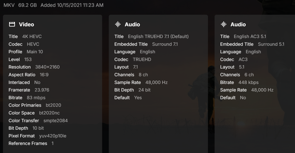

SamES 1084 Posted February 4 Posted February 4 Can you post the media info for those two files so that i can see the stream types? For some reason, it looks like transcoding isn't starting which is would explain why you would have no ffmpeg logs @Lukecan you see any reason from this log that transcoding isn't starting? Otherwise, what would cause transcoding to not start?

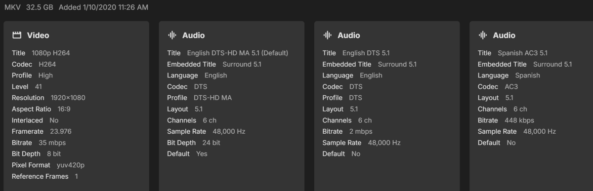

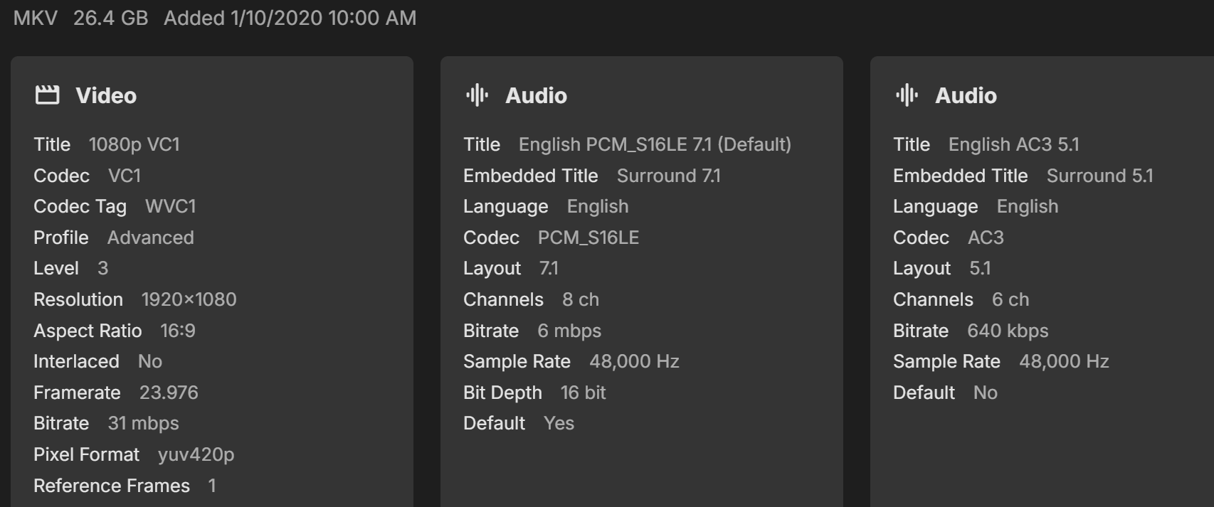

SamES 1084 Posted February 4 Posted February 4 OK, so they both need to transcode as DTS and TrueHD are not supported in the TV, so we need to work out why transcoding is failing.

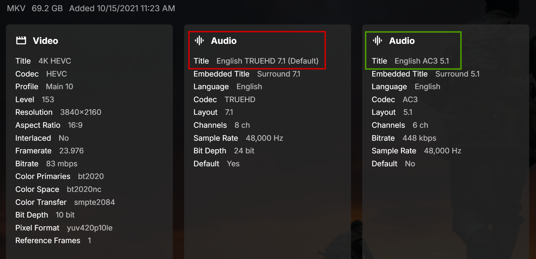

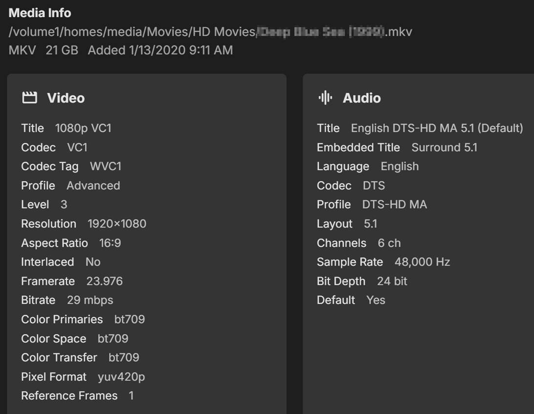

tbischof72 0 Posted February 4 Author Posted February 4 Ok, I had not tried the different audio options, so now I did and it seems like only a limited number of formats work. Wasn't aware that Samsung dropped DTS support So is emby supposed to transcode an unsupported audio format or will I only be able to play files with formats supported by the player (here Samsung TV)? The 4K file has multiple audio tracks, True HD failed, but when I tried AC3 it worked For this HD file only the AC3 plays, the 2 DTS fail Same for this one, only AC3 works

tbischof72 0 Posted February 5 Author Posted February 5 Yes, all those are correct. And I can play a file as long as I select an audio track that the TV can handle directly, like here: AC3 plays, TrueHD fails with the error

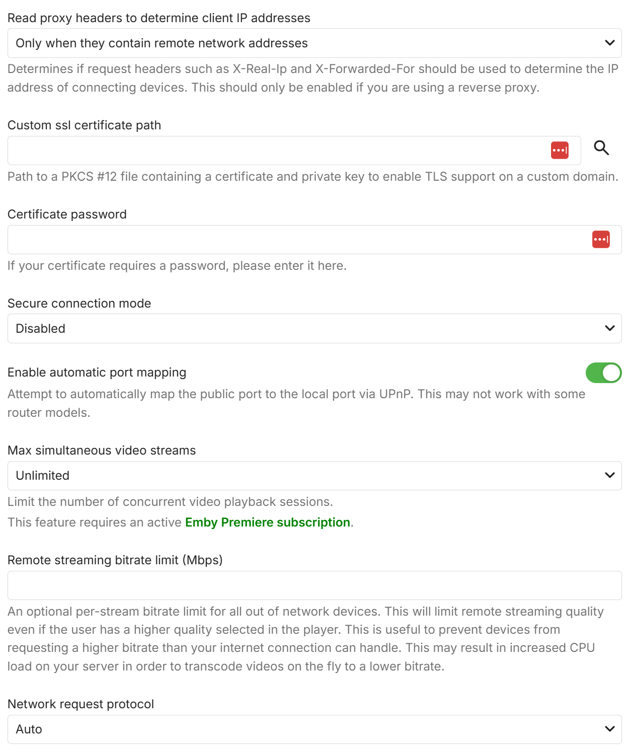

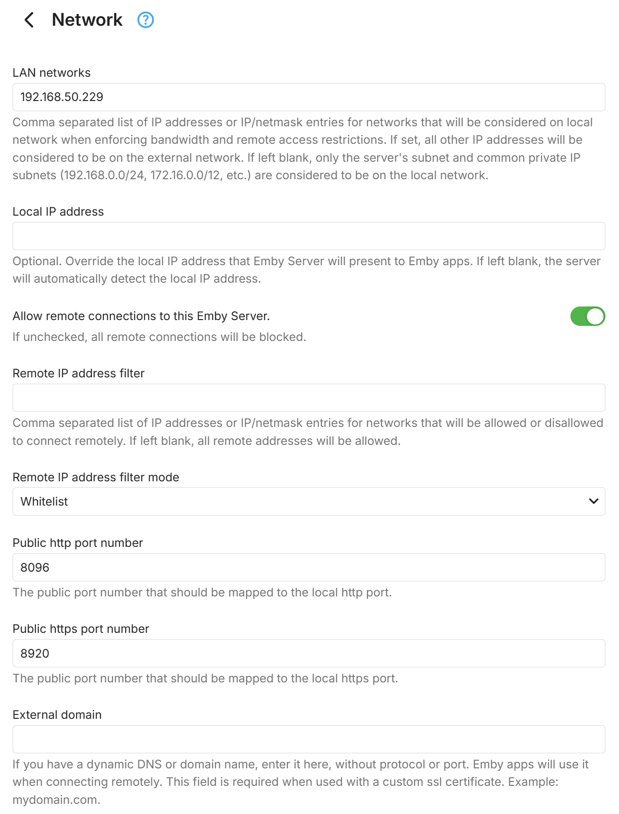

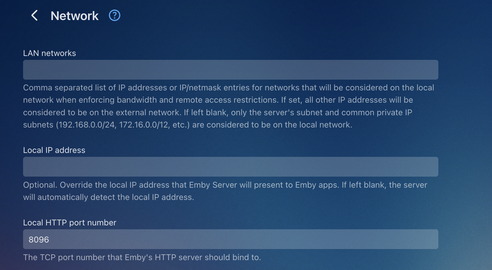

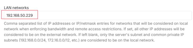

SamES 1084 Posted February 5 Posted February 5 Have you got anything in these settings on the server?
tbischof72 0 Posted February 5 Author Posted February 5 Yes, LAN networks is set to match 'Home (LAN) access', see screenshots below

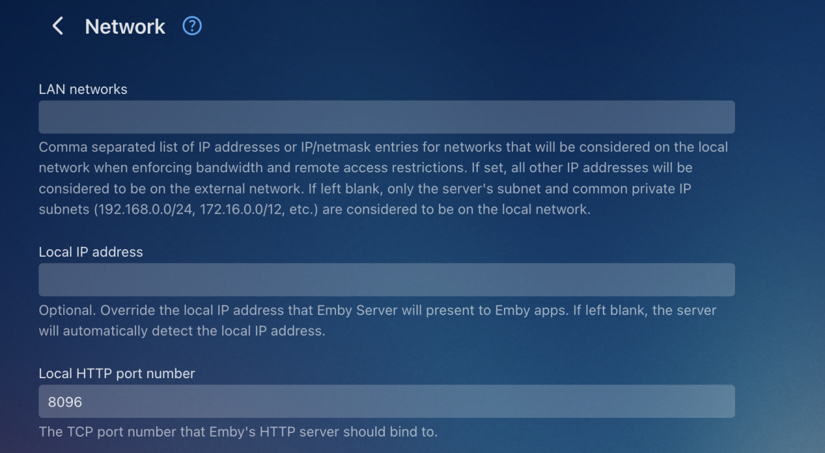

tbischof72 0 Posted February 5 Author Posted February 5 yes it is blanking out 'LAN networks' in the server settings did not make a difference
